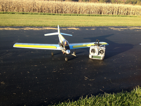

i have an original MK Currare 20 (estate liquidation) I changed the state of the art (for the 80's) gear and engine.
with JR mini servos ( digital, Corle$$, BB), K&B .21 FIRE, Magic Muffler(Aussie Tuned muffler) hobby king LiFe 1100 battery. the original MK mechanical retracts were kept. I am under 4 pounds this thing is a bullet in flight. Quite a delight the only issue is the plane is so much faster than originally planed, I had to add gap seals on the stab due to flutter, the stab is a little under built but no one ever expected it to run at 100+.
if I could figure out how to post a picture I will.

elmshoot 02-02-2015 10:31 AM
Second try on the MK Currare 20
1 Attachment(s)
http://www.rcuniverse.com/forum/atta...mentid=2069801
I think it worked I am all worn out definitely not an easy process.
