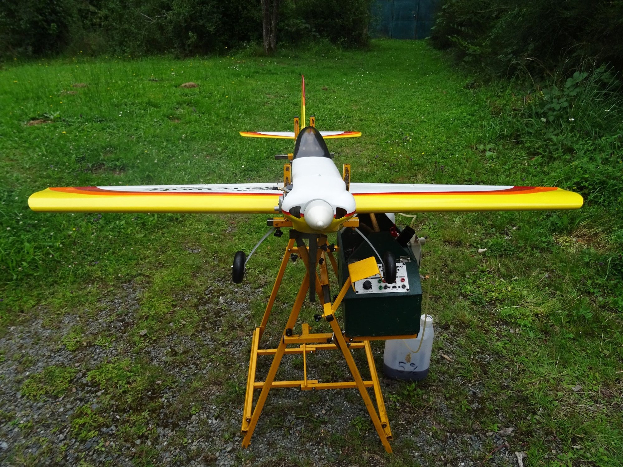

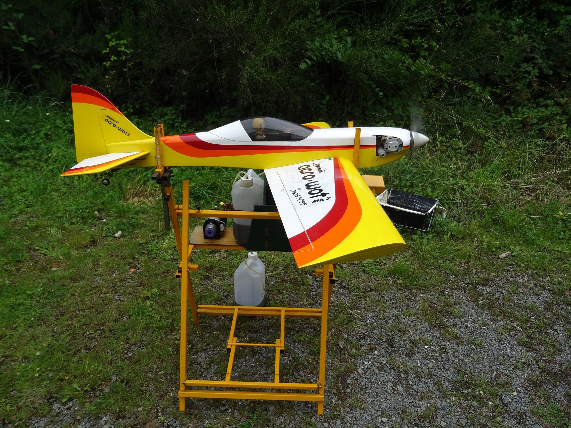

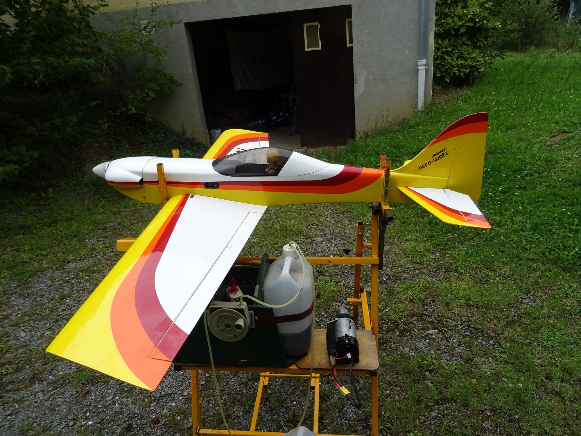

I have just finished assembling an ARTF Acro Wot. It's taken me several years to complete it because I am not much motivated by ARTFs. They are excellent flyers which fly very predictably at both low and high speed. The engine is a brand new Laser 70 four-stroke. Although the c of g is within the specified range I have fitted larger, heavier wheels to it to bring it further forward. I bought it to improve my flying and spent a merry hour fine-tuning the engine in the garden this afternoon. I plan to maiden it this weekend, weather permitting.

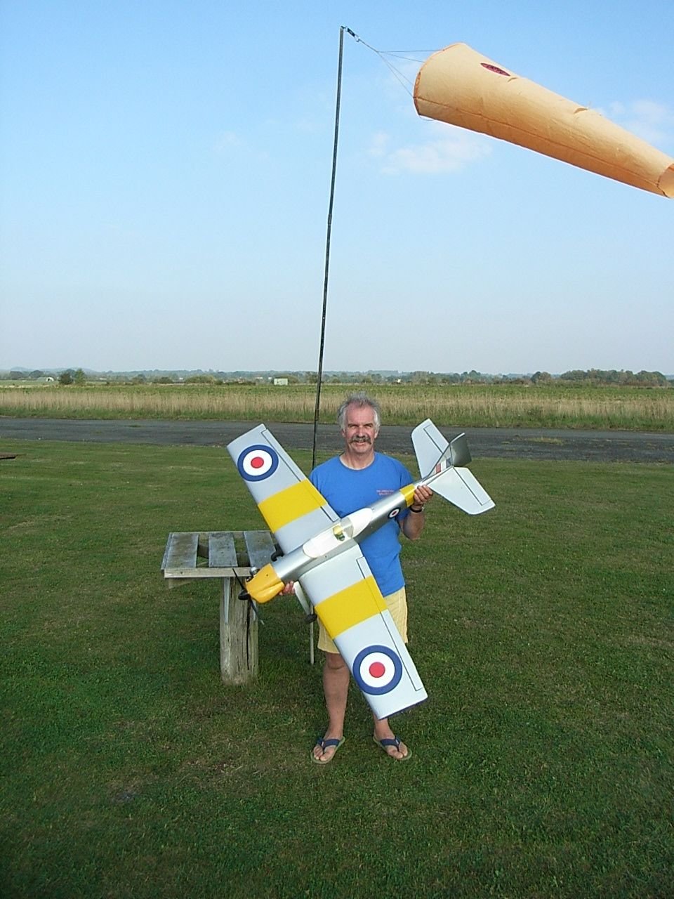

I have had two Acro Wots in the past built from the kit. A picture of mine in an RAF scheme accompanies the pictures of the ARTF but I seem to have lost the image of my first one. What I could not get into my head was that Chris Foss designs are very stable at all speeds. I used to bring them in so hot that in both cases I soon lost the undercarriage, then the wing,then the servo plate! Quite a repair job but a lesson learned I hope!
The fuselage of the ARTF is a little wider than the kit-built version.

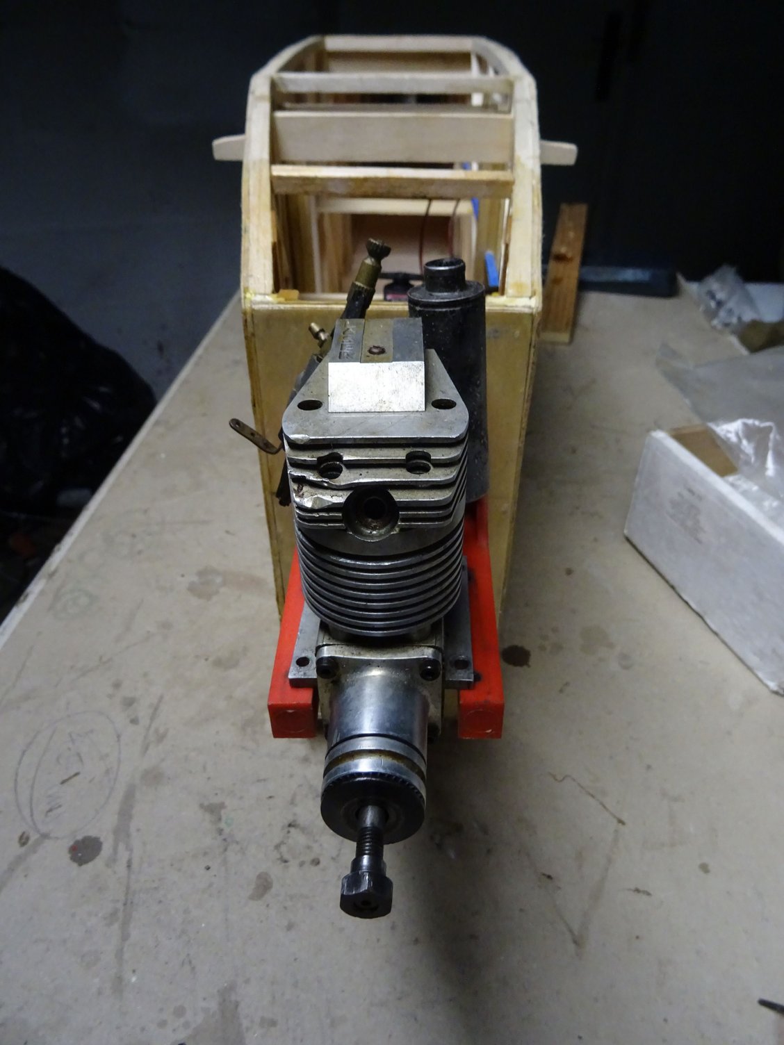

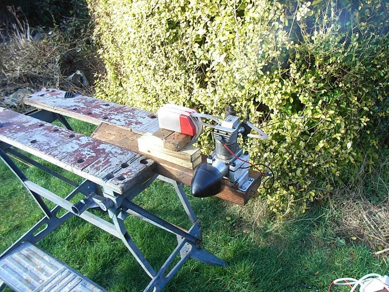

Years ago I bought a Laser 90 second hand off eBay. I'm quite good with mechanical things and model aeroplane engines in particular but I recall that I enlisted the help of a friend and fellow aeromodeller, Ioan Wittman, to get it running. Ioan, (Yo-An) is not only an aeromodeller, he is also a qualified and experienced motor mechanic. We soon had the engine running. I was most impressed and bought three more Laser engines second-hand from eBay, a 70, an 80 and a 62. I also bought a 150v at an auction in Exeter and Ioan helped me to get that running. I have adopted the practice of photographing any engines I own, running on the test stand. I have never started the 80, that's destined for a DB Sport & Scale Auster, but I have tried repeatedly to start the 62 without success. I even fitted new rings to it but not a pop. Consequently the 62 has never been photographed running. I suspected that the valve timing was out.
In 2015, having sold my house in England and retired to rural France, I was well wedged so ordered two new Laser 70s and a 155 from Jonathan Harper at Lasers. Over the next two years I built the Big Guff, one of the first models specifically designed for radio control. Build blog here : https://www.rcgroups.com/forums/show...f-This-is-mine. I fitted one of the new 70s to the model which flew it well enough but it was rather over-powered
In February the fuselage and tailplane were destroyed in a fire caused by an exploding LiPo. I am in the process of finishing off the fuselage and a club colleague, Guy Auvieux has built the tail surfaces for me. Now another modeller, Sherwood Heggen from Wyoming has also built a Big Guff but his is powered by a Saito 65. Sherwood's build blog here : https://www.rcgroups.com/forums/show...ght=Big%20Guff
It occurred to me that if Sherwood's model could fly on a 65 then mine might well fly on the 62 and I could reserve the 70 for the Warbirds Replica Hawker Hurricane which I made so much fuss about acquiring some years ago now. Last night I fitted the engine mount to the Big Guff and offered up both the 70 and the 62 to the model. At this point I found out the reason why the 62 wouldn't start! If you're not familiar with Laser engines the reason may not be obvious so I've included a picture of the 90 so that you can compare the two.
Do you know what it is yet?
PS. Yes I know that the engine mount is too big. I have one the correct size which should drop in.

Isn't the carb on the wrong port?

I think so. Well done Mike!
I hadn't noticed until last night despite the fact that I've owned the engine for some years!

It took a couple comparisons of the two photos before I caught it. With an unfamiliar brand unless you had two engines side by side you wouldn't catch it.

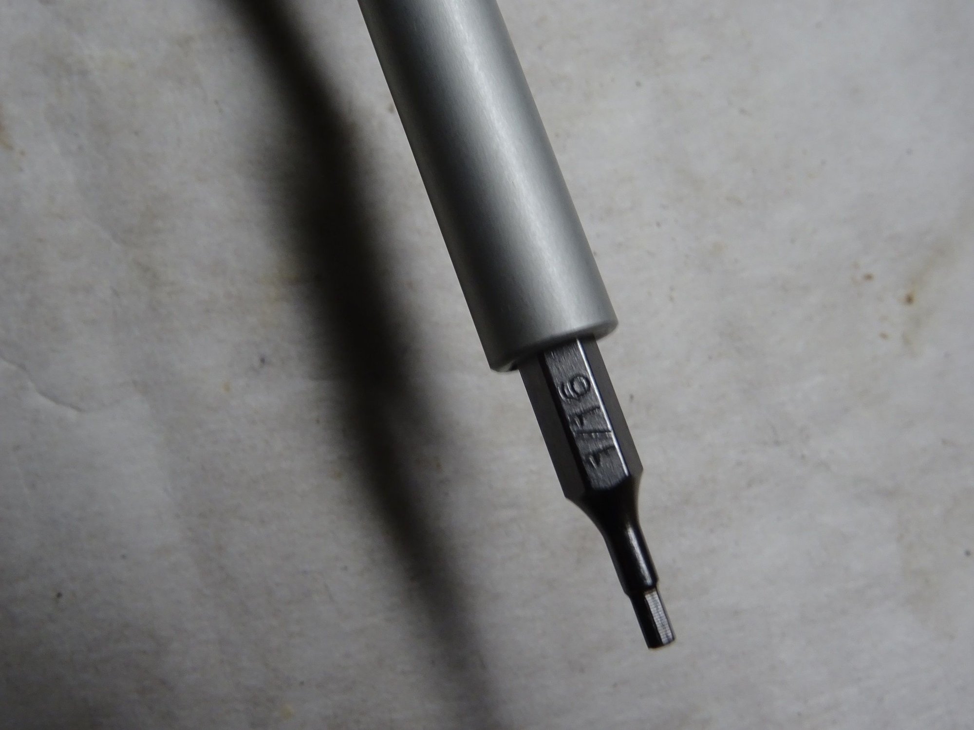

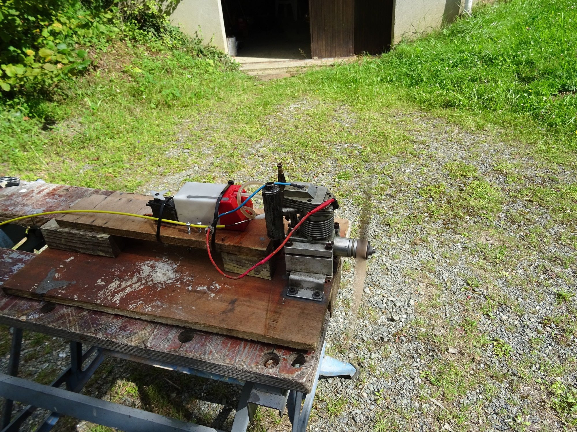

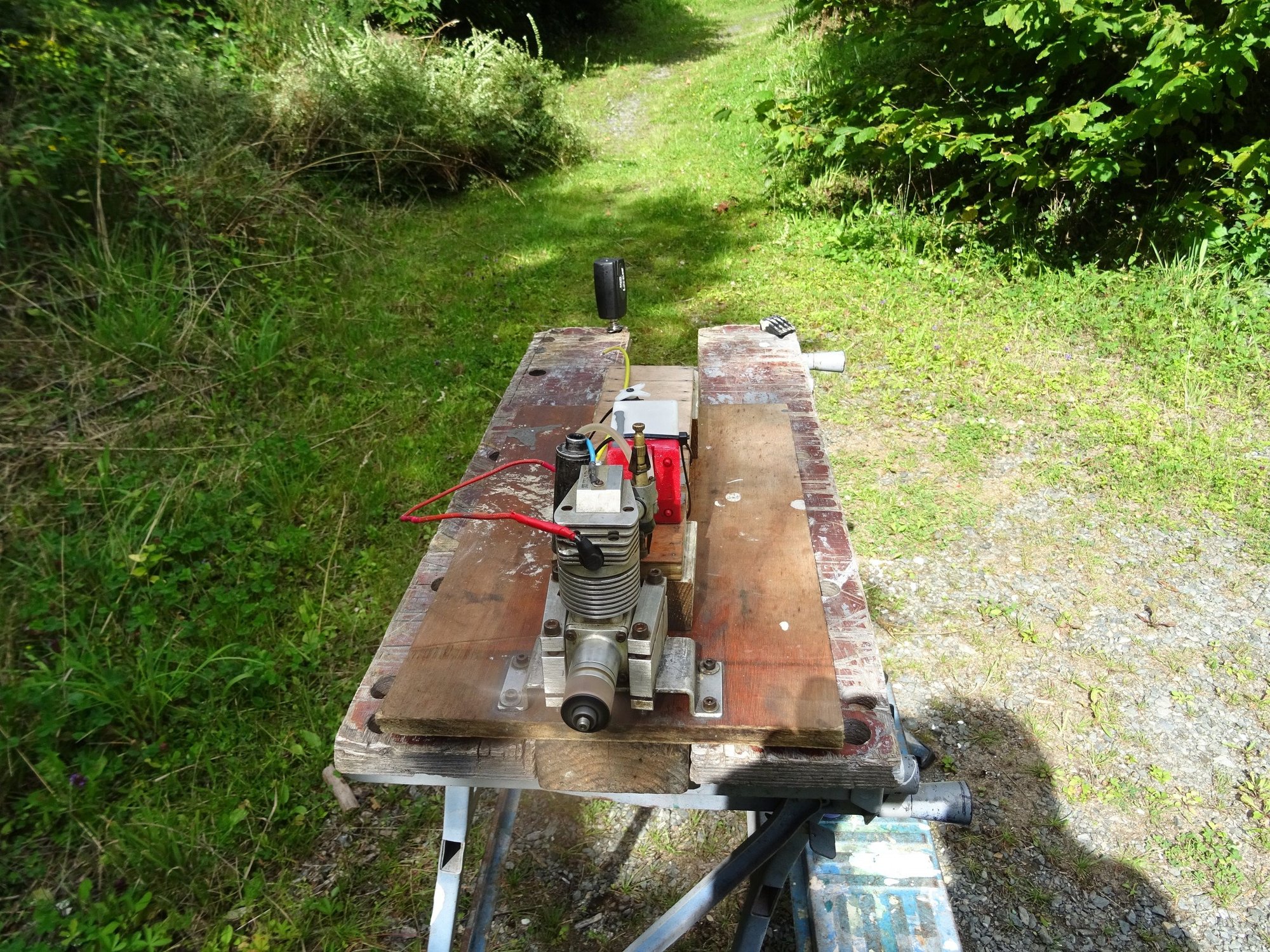

I needed a 1/16" Allen Key to remove the grub screws which retain the carburetter and the exhaust. I have a set of Imperial Allen keys but guess which one is missing!

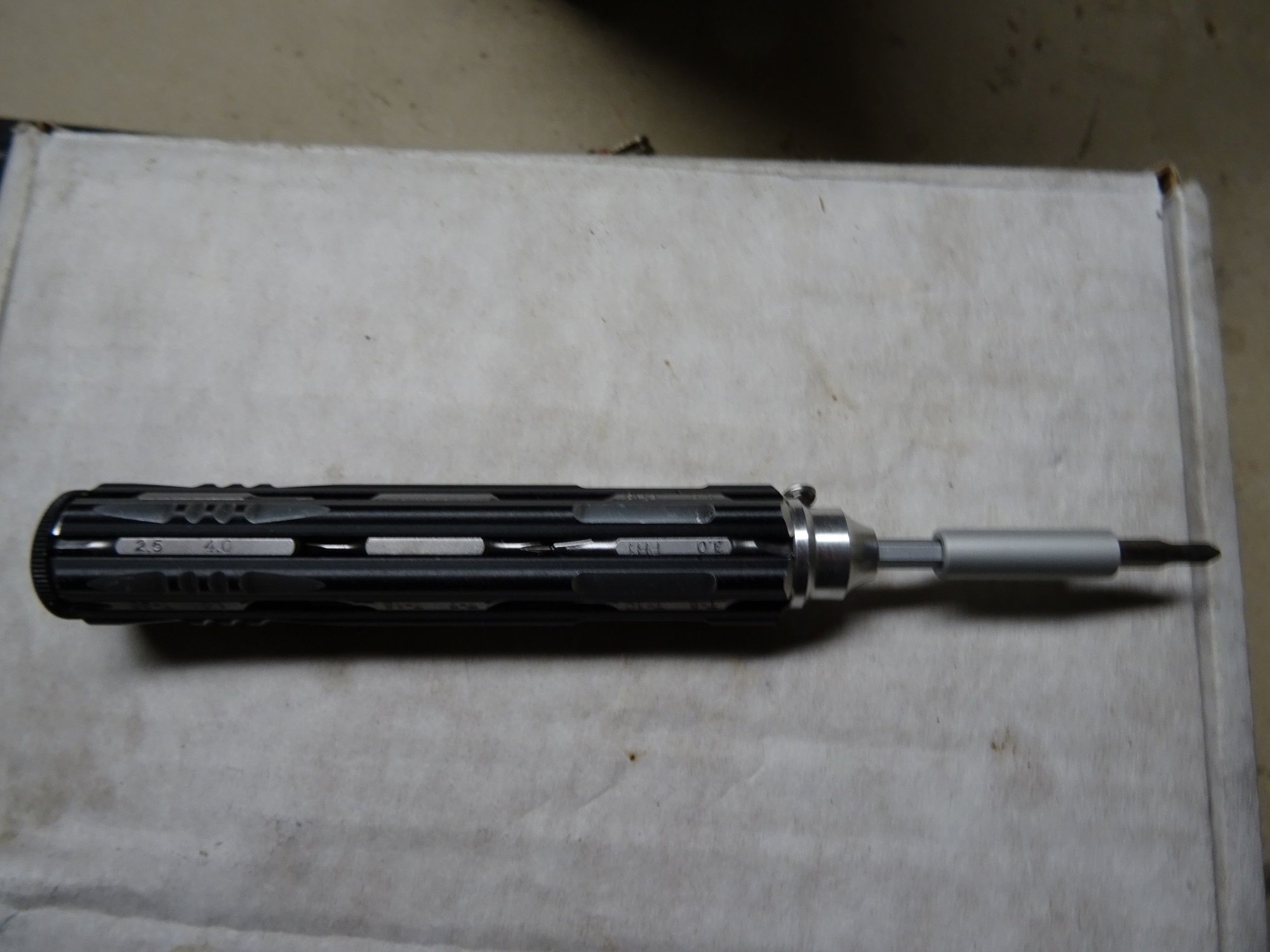

However, when I was last in England I bought a sort of multi-tool from the model shop in Weston Super Mare because I needed a very small screwdriver for micro servos. Cost me 18! That's about 21.25 or $25 US. It had a further fifteen bits in the handle including a 1/16" Allen Key. With a bit of WD 40 and some heat I was able to remove the four grub screws which secure the carburetter and the exhaust, though two of them require some further persuasion in the form of pliers on the exposed part of the grub screws!
Having swapped the carburetter and exhaust over I installed the engine in the test stand and it fired up staight away. The high speed needle required a little adjustment, the low speed needle required no adjustment, throttling and tick over were excellent. I was running it on a Bolly 10.5 x 7 prop which was perhaps a bit small for the engine but it's what I had to hand. A 12x6 or 13x6 is normally recommended..

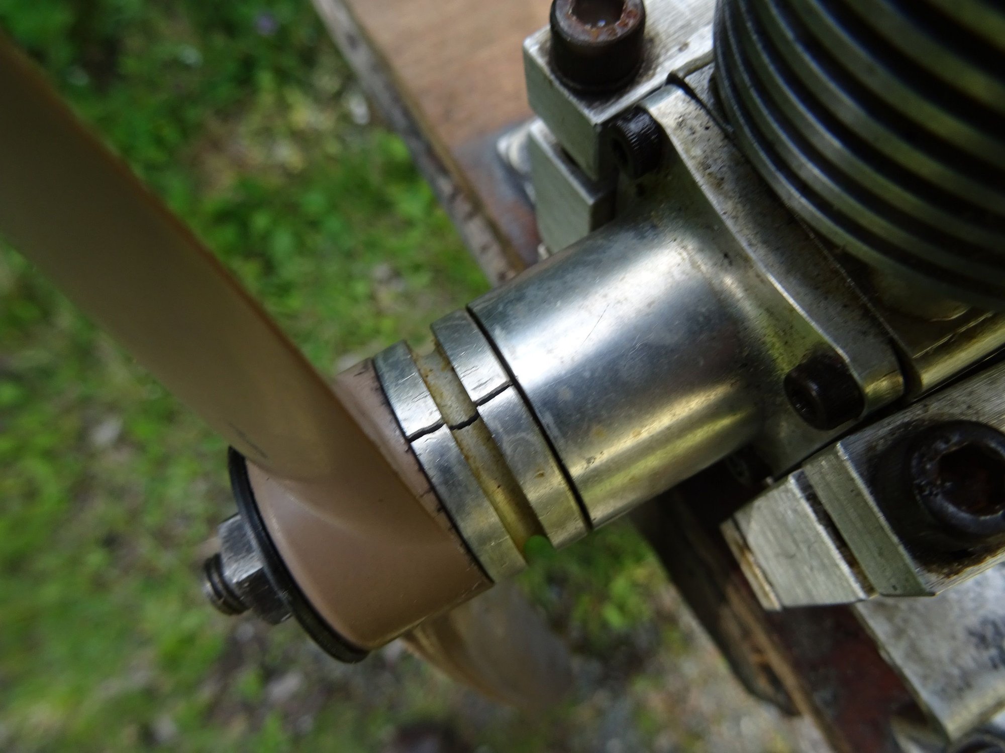

However, there is a stripped thread where the rear r/h bolt screws into the crankcase which permitted some oil leakage and the prop-driver is cracked. Jonathan Harper of Laser informs me that the 62's prop driver is the same as the one fitted to the current Laser 70 so I'll order a new one. I'll see if I can get a helicoil insert fitted. A Metric one would do. It doesn't have to be 4BA. I'll probably treat it to a pair of piston rings while I'm at it.. Any advice for the cosmetic restoration of the engine would be appreciated.
Fancy owning an engine for 10-15 years and repeatedly trying to start it without success over the years without realising that the carburetter and the exhaust had been transposed! I own another six single cylinder Lasers too!
Apparently it was quite common in the past for brand new engines to be returned to the factory because they wouldn't run. This was because the owners had fitted the exhaust and the carburetters the wrong way round! Nowadays they leave the factory with the carburetter already fitted!

That crack doesn't look good!
