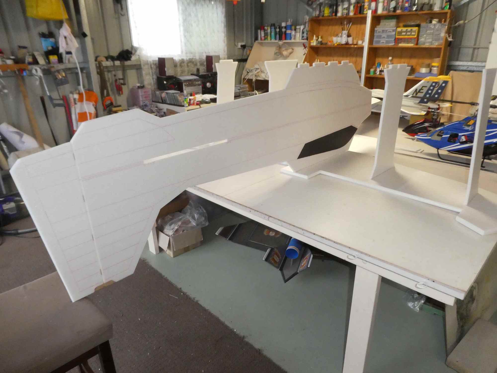

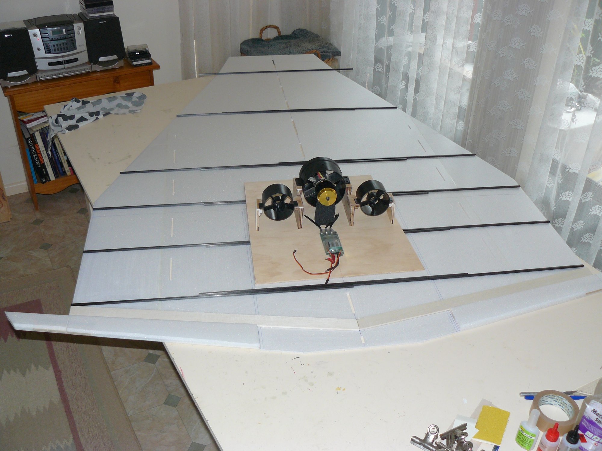

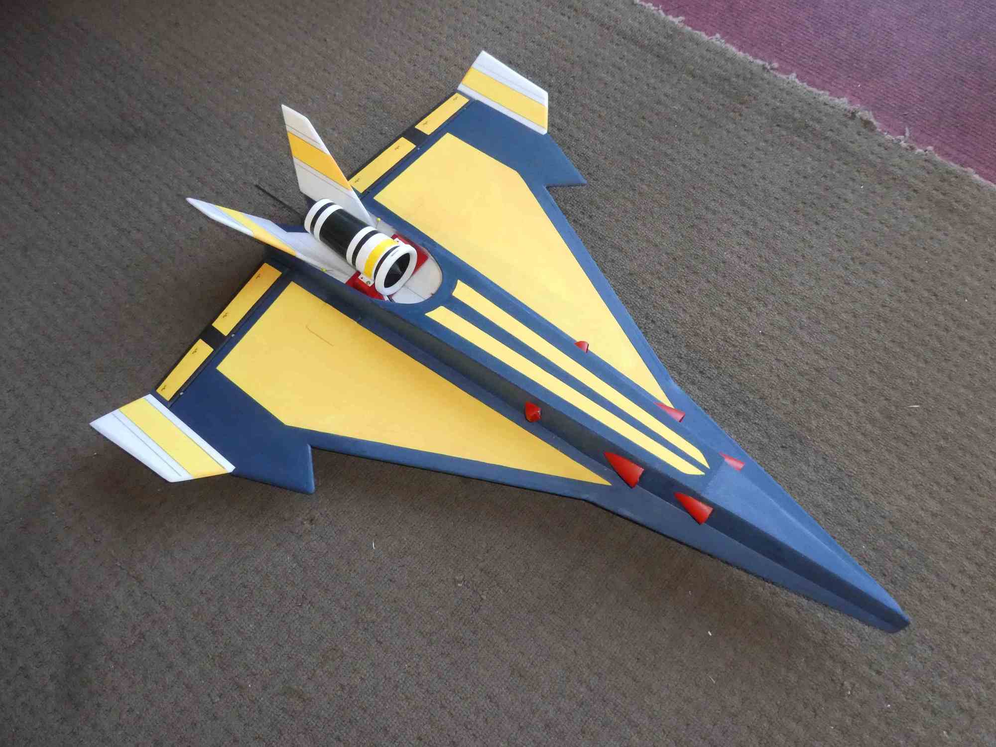

Yes I know, I have done bit of experimenting last few weeks to find out how practical it is in my scenrious to build huge 2 to 3+ meter foamies. I have found sparing use of 5,15 and 30 min. Epoxy lot more workable, I also use in some sections "Foam2Foam" friendly to Modeling foam and Depron.
What is the largest Depron build you have used it on? These are few of mine using Epoxy. (pics)
I found Hot glue gun totaly unpractical in complex builds like this.
Slow cure required for precission.
Depron 18Kw Giant in making.
Finished project with 6 to 8 kilos of lipos.
