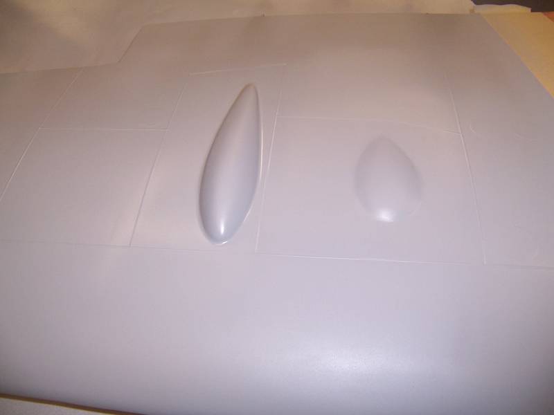

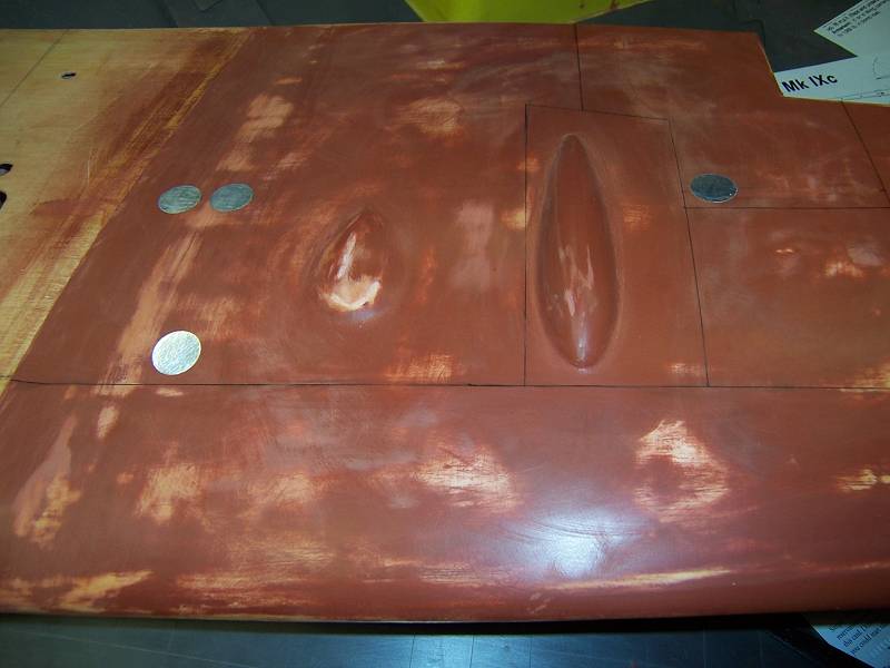

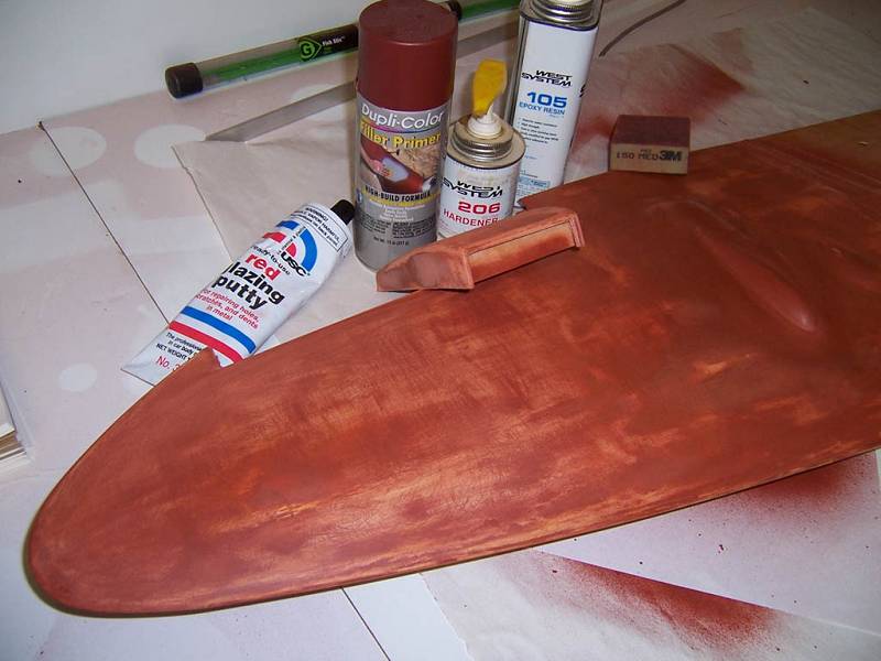

Filling the weave with epoxy/microballoons can be done, but it's a lot harder to sand and in the end, may be heavier. After filling the weave and sanding back down, and you have a nice smooth surface, you'll be ready to start adding surface details. For panel lines, I use 1/64" chart tape. I draw out all the panel lines, then lay out the tape. Then I apply a few coats of primer over the tape, feathering out toward the center of the panels. Once dry, pull the tape up and it leaves a chanel in the primer. often, the adhesive stays in the channel and needs to be picked or washed out. I break the tip off a #11 blade and grind a slight hook on the back side, then use it to scrape the adhesive out. Give a light sanding to get rid of any ragged edges and you're ready to burn (flush) or drop (button) rivets. I use a 1/16" brass tube on a soldering iron. I first mark out all the rivets to make sure I have proper placement and spacing, then melt the rivets into the primer. Once done, I again give a light sanding to knock off any rough edges. Now it's ready to paint.
Scott

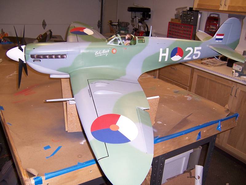

I painted my TF Spitfire entirely using my Testors Aztec airbrush. This is the only brush I've had, so I cannot give comparisons. The brush was about $100 us with 6 or so tips. I already had an air compressor which I picked up for another $100. I got a better regulator than what came with the compressor, and got a couple of disposable inline filters. I used exterior latex house paint for the major colors. I took color samples down to the paint shop and had a quart of each color mixed. It took a little trial and error to thin the paint to the right point, but once mixed, it went on quick and smooth in a couple of coats. The markings and weathering were done with Model Masters and Humbrol paints. The nomenclature was done with ink jet decals. Latex is not fuel proof, so after letting the latex thoroughly cure for about 2 weeks, I clear coated the plane with waterbased polyurethane. I used rattle can satin wb poly. Next time, I'll not use the rattle can but use my airbrush or hvlp gun as the rattle can leaves a bit of an orange peel texture. It's not real noticable unless pointed out, but I'm sure an airbrush or hvlp gun will give better results.
Here's a couple of shots before and after weathering.
Scott
