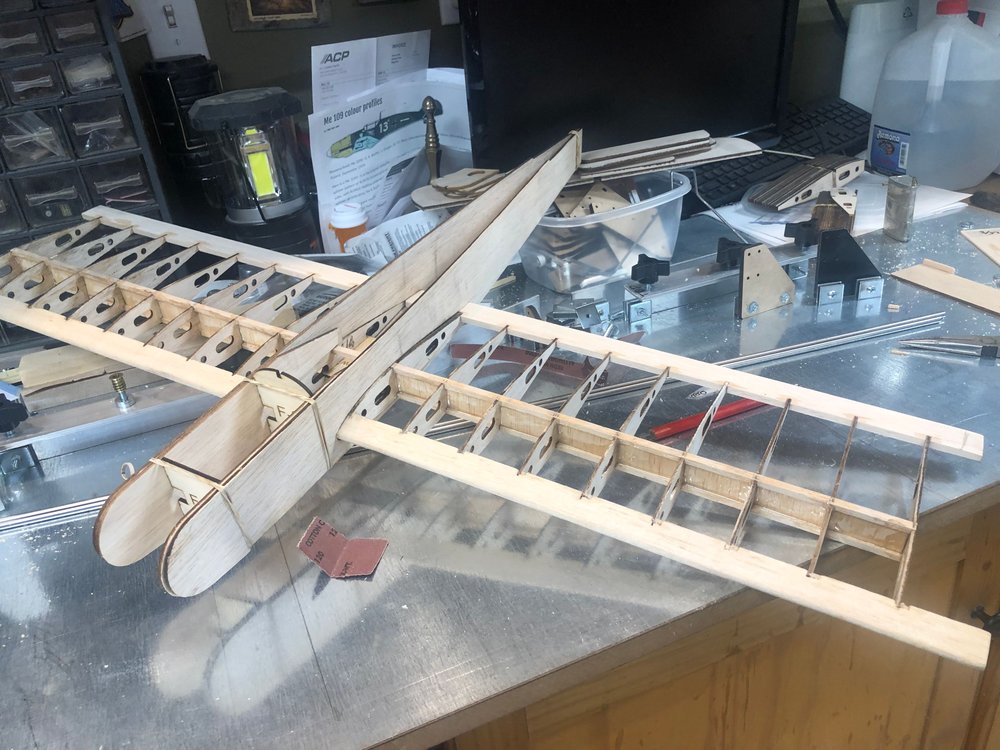

Finished the wing… and the fuselage mocked-up well after resizing the formers… should go smoothly from here on out
I also reinforced the formers with some cross-grain support as a couple formers bowed when under pressure from Fuselage taper.

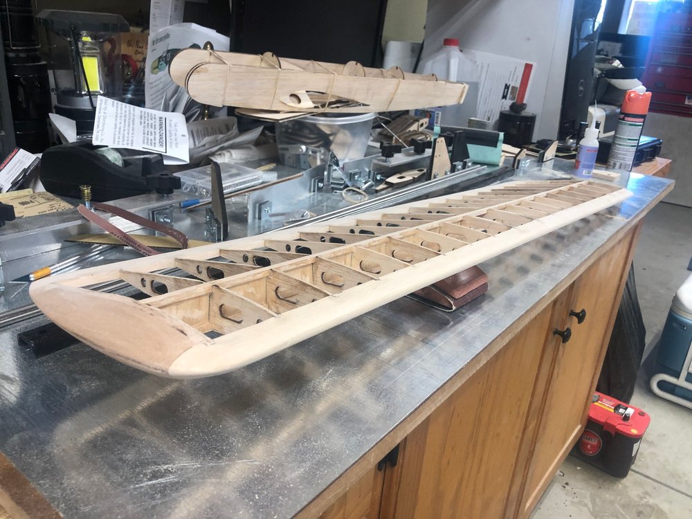

Almost ready too cover wing and begin final stages of finish… then I got sidetracked drawing from scratch a profile PT 19 that is in the .15 to .19 engine range… then got sidetracked once again when a fellow flyer wanted some .049 Japanese warbirds (the Kawasaki “Tony”, & Nakajima “Kate” and “Jill” - all short kits now available on eBay). So now we’re traveling for Christmas and then vacation over New Years…. Won’t be back to begin to finish my tribute Brave until end of January…. I’m already eager for vacation to be over and we haven’t even left yet. LOL
Merry Christmas and Happy New Year to all
Pete
VintagePlaneKits
Veco Brave Scratch Build ready for finish
Laying out the fuselage on the new PT19 profile scratch design

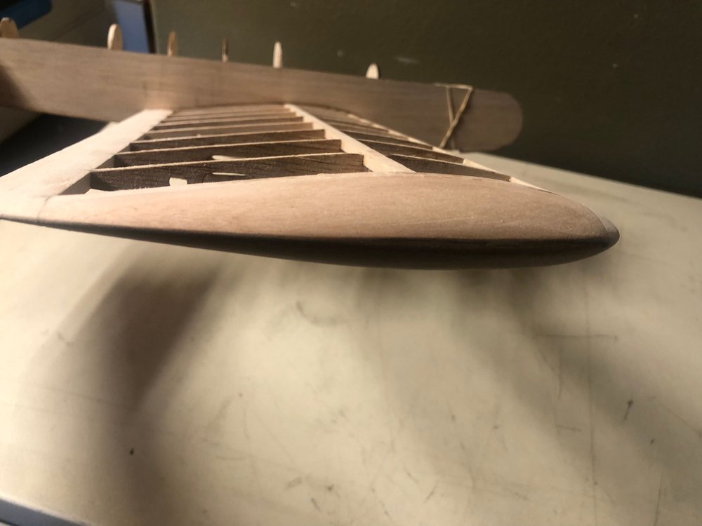

Wing is 90% finished… had to alter the wingtips a bit as I forgot to allow for the 1/4” sq leading edge when drawing them.
