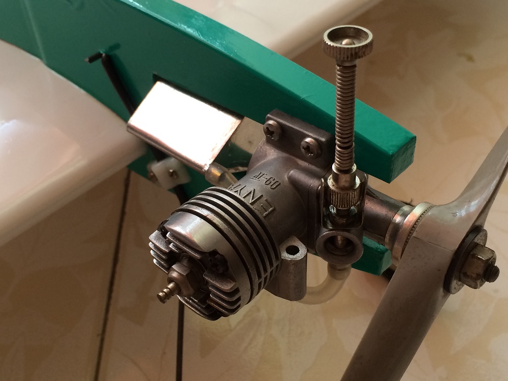

Hi all
I'm not new in R/C but new in U/C, I used to fly F3A pattern but watching some C/L contests on youtube made me try this field of aeromodeling.
It seems like a new window opened to my modeling life.C/L models were populare here in the past but these days nobody knows anything about this flying style. these days every thing ends in turbins and giant 3Ds.
I have recently built a Viper by Mercury powered with an Enya .09
it has been tested with a 8.5 meter wire but it seems to be short
my question is :
what is the proper wire length for this bird?
should I use a 7 strand wire or a 3 strand wire suits?

I would go with about .012" to .015" or about .3 mm line. Although I am not familiar with the Laystrate brand, I would guess the thinnest one. About 42 to 52 feet long is good. That is what, about 16 meters?

The Laystrate lines are very good but are now made by the manufacturers of the P.A.W. engines in England and sold as Staystrate. Use the lightweight lines which are 3 strand and .015" (.38mm) and the 100 foot reel will give two lines at 15 metres which may be a fraction long for your model. The heavyweight lines are 7 strand and .018" (.46mm) from memory.

Since this plane is powered by an Enya .09, I would not go heavier than .012 diameter. I would start with ~45 ft. lines and if it has sufficient pull, go up to 52 ft. lines. How long the lines should be depends a lot on how well your engine runs, how heavy the plane is and how well it is trimmed.
If you can find a fellow flyer to help you trim it you can save some time and repairs.
Good luck with it.
George

my plane weights around 13.5 oz and the engine runs well - about 12400 to 12800 rpm- with FAI fuel and 7x4 prop.
but it has not been trimmed yet
there is an old guy here who used to fly U/C in the late past , and i guess he is the only one near me who can help me to deal with the problem in the flying field , he did test my bird and of course saved it from crash, cos the plane was somehow unstable during the flight , and tended to climb with frontwind
