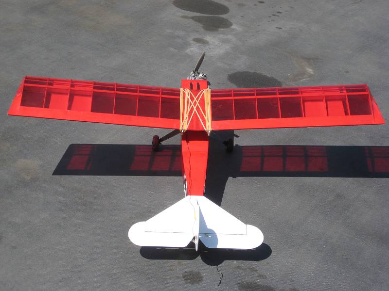

I built this Stick in 1986 and flew it until 1989..
It saw some rough times back then..
One time I cartwheeled it off the runway into a barb wire fence..
After I stopped flying in 90 it spent the next 17 years waiting to die in storage.
When I pulled it out of the attic last year it was in sad shape.. the covering was loose in many places.. had holes in others.
cracks in the fuselage, missing parts, the tires even had flat spots
The OS .45 FSR was castor locked..... A trip through the crock put fixed that and it spend some time pulling my Avistar around the sky.
Well it's an old friend so I had to start putting her back together again with a few mods now that I'm flying again.

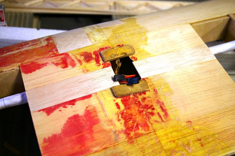

Mod 1 was bigger ailerons.
I made a built up core from 1/8 stock and sheeted with 1/16"
The finished pieces are larger and the same weight as the old 1/4 slab pieces.

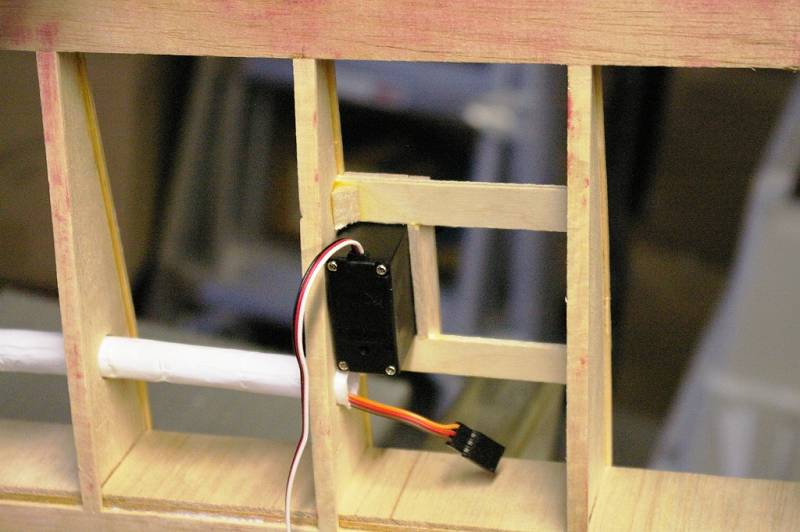

Mod 2 so far is dual in wing aileron servos with wiring tubes.
The tubes are just printer paper rolled on a 1/2" dowel and glued with white glue.
After they dried I drilled holes in the ribs with a 1/2" forstner bit and worked the tubes into place..
They got smashed a bit in the process but running a short section of the 1/2 dowel through the tubes straightened them out and made for a nice backing block while gluing the tubes to the ribs.
next up was repairs.. I had several sections of cracked sheeting on the wing. Broken and gouged wing tips,

I've always felt that a Stick should be done with fabric. It used to be covered with super coverite.
This time I'm going with lightweight polyester and dope.. latex for color and polyurathane for a fuel proof clear.
The goal is an Ultra Stick type of setup but with more of a classic stick look.

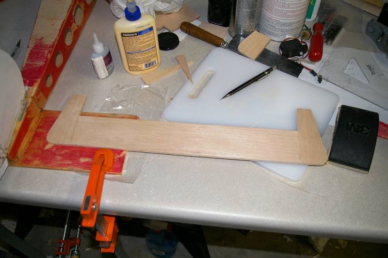

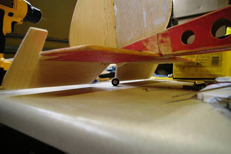

Today I managed to draw up a new rudder and made a few mods to the elevator.
I made a template to compare the original design and what I came up with.
I duno.. my setup looks kinda ugly.. Maybe it'll look better with the elevator on.
Then again it is an Ugly Stick
I'd already made a 1/4" sheet elevator so I just made a few more changes to that one.
What I did was cut the tips off the stab. hack them down a bit and make the elevator counter balanced.
The last shot is one of the planes I sharpened up the other day. Works great on balsa when it's sharp.

I split the elevator to provide clearance for the rudder.
I did that by first cutting a notch in the LE and adding a 1/4 square hardwood block to tied what will eventually be the two halves together.
After the glue was dry I marked and cut a section out of the center of the elevator for clearance.
Since this is just a 1/4" sheet elevator I added 1/8 x 1/4" cap strips to the cut area to reduce flexing.

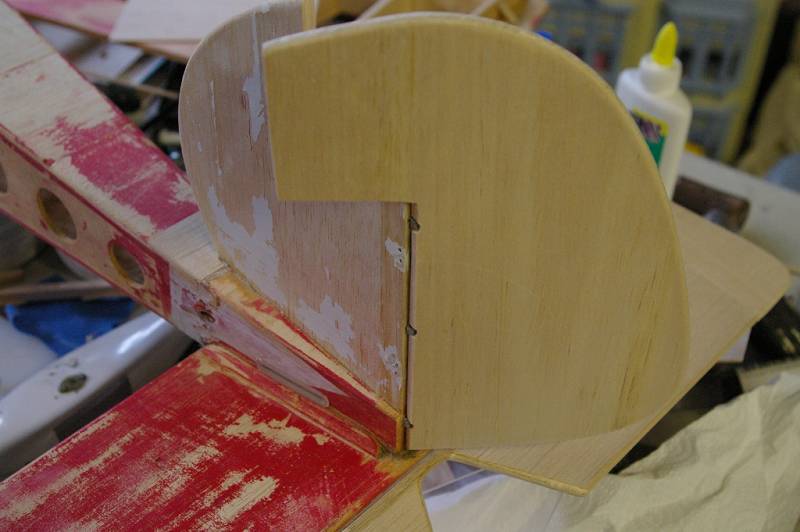

Another day.. More work and a dumb mistake caused by rushing through things.

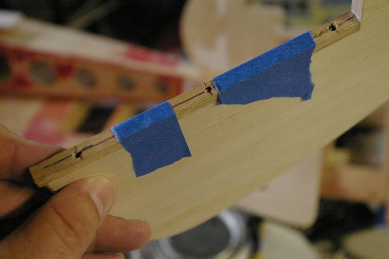

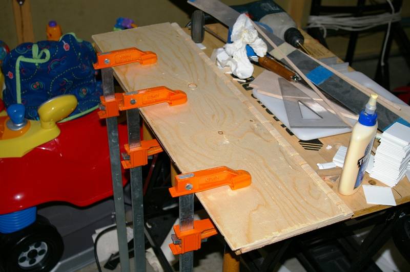

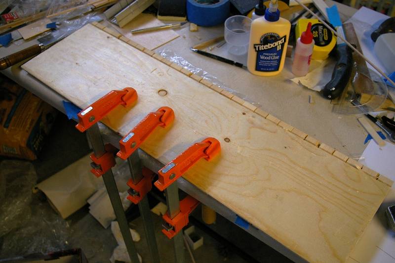

I framed up the rough core of the rudder yesterday.. Today I trimmed and sanded it into shape.
Then I cut and glued the sheeting together.. Sanded them smooth and glued them to the core..

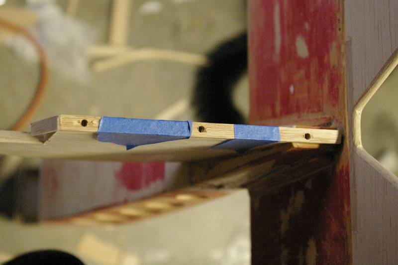

That was my mistake.. I forgot to add the blocking for the hinges and ply for the control horn area.
Just to make things worse it didn't click for a few hours so the glue was already dry.
It's times like this I wish the glue didn't bond well.. The sheeting was stuck all to well.
I managed to carve out a 2" strip from the sheeting using a #11 blade.
After a bit of work with a good sharp chisel I had the cuts cleaned up and added the missing blocks.
I sanded the open area smooth with some 120 grit self sticking sand paper cut and stuck on a paint stick.
I cut a new piece of 1/16 sheeting and covered it up again.. It's back under the clamps till tomorrow.

It's starting to look like a plane again!!
Today I managed to trim up the sheeting on the rudder and cut the notch for the counter balance on the stab..
It's finally starting to come together.
It looks like I may have an interference issue with the elevator and rudder.
I'm not exactly sure how I'll fix it yet.
Hinges are next!

I agree, looks like there might be interference between rudder and elevator.
Is it possible to slide the rudder assembly back a ways? Back far enough so the rudder pivot point is behind the elevator pivot?
Old 06-21-2007, 08:51 AM
Banned
Join Date: Apr 2007
Location: Aurora, CO
Posts: 340
Default RE: Midwest Sweet Stick Revival (a work in progress)
a good easy way to fix the interferance would be to vut the elvators. this type of plane dosnt need much throw.
scott
Old 06-21-2007, 01:09 PM
sscherin's Avatar
Join Date: Aug 2005
Location: Eugene, Or
Posts: 1,152
What I'm thinking of right now is to move the rudder up about 1/8" and capping the top of the vertical stab to match the lines.
between that and rounding over the center block in the rudder it should clear. as a bonus it'll cap the end grain making the stab stiffer.
Extending the rudder back is a good idea but it would mean moving it almost 1/2" back.. 1/4" for the stab and another 1/4 for the elevator block.
option 2 is a bit more involved..
remove the center block and either run split elevators (somewhat ugly having 2 control horns)
or make a 1/8" music wire joiner mounted on the hinge CL with a brass tubing bushing as a pivot point epoxied to the stab.
I'll try the simple mod first.

Today I hinged the rudder..
First thing I did was mark the hinge points from the plans onto a 1/4x1/4 hardwood stick cut to the length of the rudder hinge line
Then I drilled 1/8" holes in the stick on the drill press.
Now I have a drilling jig for the robart hinges.
I also added a little 1/16 sheet scrap to allow a small gap between the stab and rudder. The covering will close this up a little.
The jig gets taped to the rudder (pic 1)
then drill the holes (pics 2)
In pic 3 you can see we have a nice set of perfectly aligned holes.
In Pic 4 we follow the same process on the stab. (note the 1/16" spacer)
Pic 5 I've sanded notches into the rudder for the hinges.. you want them flush with the TE when folded over 90 degrees.
Pic 6 shows the Rudder installed but we still need to cut the bevels.
Pic 7 shows the finished rudder.. it has almost 45 degrees movement and a nice tight hinge line.

We are getting close to finishing the wood work on this thing..
I did the aileron hinges last night so I think I'm down to making a plate to cover the landing gear slot.
The next steps will be mounting the tail wheel, install the engine, Control horns, push rods and servos
Then strip it down for fuel proofing and covering.
No Monokote for this plane.
Still loads of work to do but less balsa dust!
