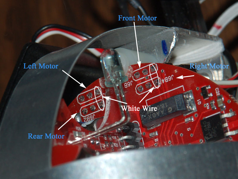

I am sending my new style board which has the 4 pin headers to Spectrolutions to have it converted to the new brushless board by Mike Dammar. Could you please post any instructions, wiring diagrams, pictures etc, I will need for connecting the electrical components to the brushless board?
John
Old 11-07-2007, 07:07 AM
Old Man Mike
Join Date: Apr 2007
Location: Huntertown, IN
Posts: 267
Default RE: New Brushless DF Board Soon Available !!
ORIGINAL: Blackdragan
Mike,
John
It is really just a plug and play operation once you know the identification of the pin groups. I will try and post some pictures with labels later today.
Mike

Well, I tried to post the pictures but for some reason it is not allowing me. Maybe RC Universe is broken or I've reached some sort of limit. I will try again later.
Mike
Old 11-08-2007, 05:21 PM
Old Man Mike
Join Date: Apr 2007
Posts: 267
Mike,
John
John,
Here are the pictures showing the connections.
Mike
ID:	799558   Click image for larger version

Thank you for posting the pictures. I am assuming the brushless board comes with front connector pins already installed, which allows you to just plug in the ESC's?
John
Old 11-08-2007, 07:51 PM
Old Man Mike
Join Date: Apr 2007
Posts: 267
Mike,
John
Yes.

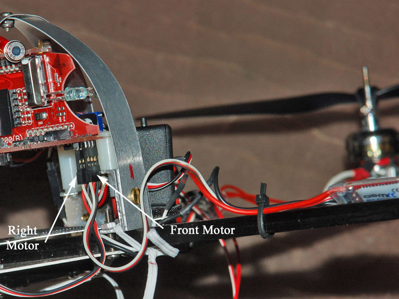

Are the ESC's wires long enough to be reach the (8 pin) motor connection on the bottom of the board or do they have to first be spliced to the original wiring harness?
John
Old 11-09-2007, 10:15 PM
Old Man Mike
Join Date: Apr 2007
Posts: 267
Mike,
John
If you are using the existing DF frame, you really don't need to use the 8 pin motor connection at all. It is best to just wire all four ESCs directly to Battery Ground (Black Wire) and after the positive side fuse (Red Wire). The servo wires from the ESCs are long enough to reach the front pins with no problem. You can actually save some weight by removing the original connector and wiring harness (and even the Hexfets if you want to bother with unsoldering them from the board). While you could use the motor harness wires, the total resistances is greater plus you will have more potential noise conduction to the 5 volt supply thru the Hexfets. That noise is believed to be the source of the infamous 0.8 sec dropout so eliminating it is a big plus.
Mike

Mike,
Is there any chance you could post a picture showing the connection you described above?
John
Mike
Mike,
John
Here you go.
You only see two black wires because I chose to connect two motors to each of these wires rather than trying to solder all four to the same pad.
(and before you ask, that round white/black coil on the leg of the fuse is the current pickup coil for the Eagletree recording box.)
Mike
