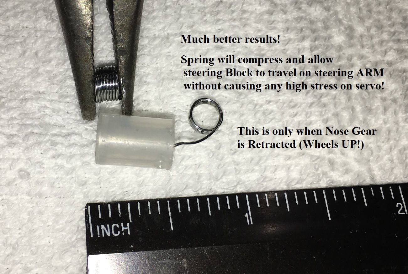

I don't know if anyone else has but I sent a note to Horizon about the issue wit a picture of my( and yours , and many others I'm sure) solution
http://www.rcuniverse.com/forum/atta...1&d=1509115523

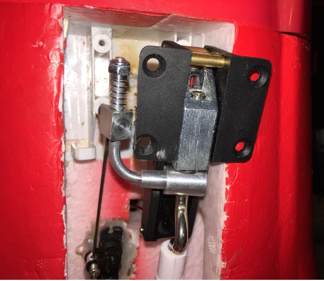

Steering block sticking.
Hey guys
I took my t28 apart after 38 flights to look the nose gear over. I never had the sticky steering block issue to the point it ruined the servo but it didn't operate very smoothly. The problem is the rough lathe turned surface of the rod the block slides on. I'm a professional machinist so it's easy to feel with your finger nail. I sanded mine smooth and with a touch of grease it slides smoothly now while maintaining the engineered tolerances between the block and steering rod.
I was more surprised how the retract circuit board wiring is getting crushed by the weight of the plane and landing forces. There is no air space between the wires and the floor of the nose retract mount. The wires were pounded flat and this is probably the source of many failing retract. I made a pair of spacers to fit between the mount and the retract flange to prevent further crushing of the delicate wiring. Same issue with the main gear but the wires are up aginst foam instead of hard plastic.I carefully removed some foam where the wire impressions were.
I am designing and machining some items to install a much needed oleo strut on the nose gear, and will do the same for the mains when time allows.
After some testing the oleo struts may be available if any T28 owners are interested. Hope this info helps. Thanks

Went flying yesterday and after 3rd flight of the day the nose wheel servo stop working after somewhat hard landing. The nose gear retract is still working fine and I'm gonna try to steering slider mod. To get the steering servo out of the fuse do I need to just cut it out of the foam and glue the new one in? This is my first foam plane so this is new to me. Any help would be appreciated. Thanks.
#167
I would run a knife down the sides of it but you eventually have you yank it out. my steeling servo died on flight three, its way undersized (I would go with 50inoz min., prefer 100inoz). anyway I turned the dead servo all the way to one side then mounted the servo arm pointing straight forward canted to the side that's against the stop, unplugged the servo and have put 49 flights on that setup. if the wind is cross wind it will not turn down the runway in a taxy but once the ROG starts I can straighten it out.

I did have to cut my original servo out when like many others had the servo die after several flights . I glued in a plywood servo plate and mounted with screws. Now if I have to replace , I just remove screws. Since my mod on the side arm, I haven't burned out any more servos. But after over 50 flights the nose gear retract gave up the ghost. Had to replace it.
Marc

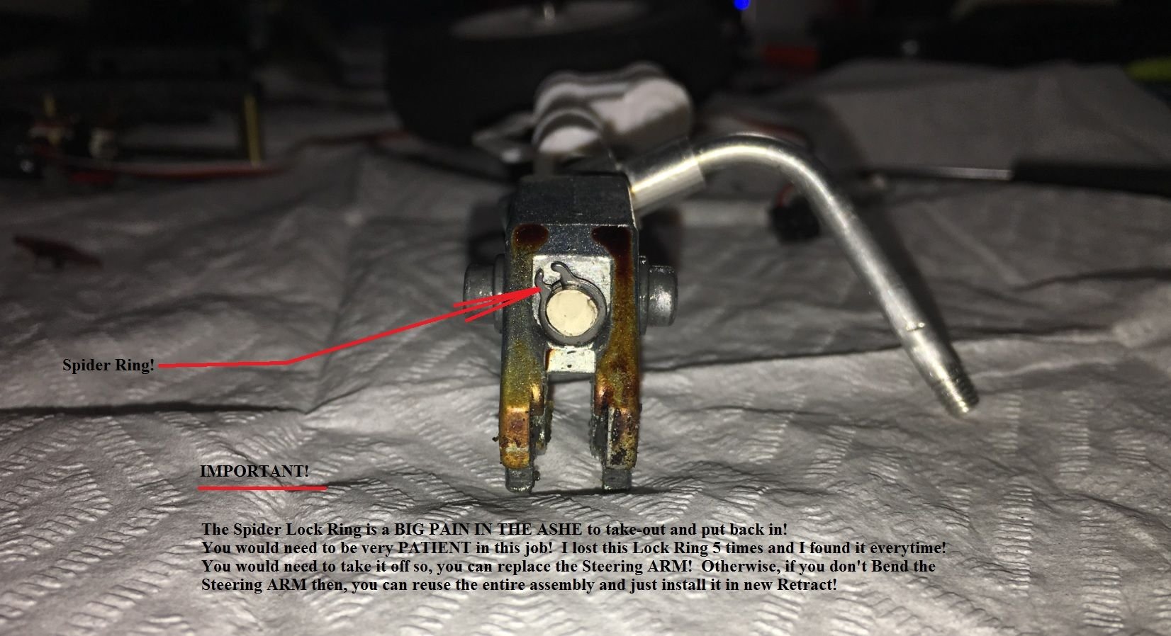

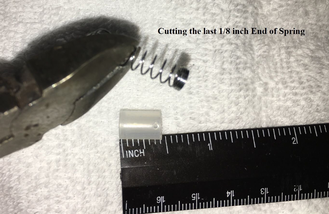

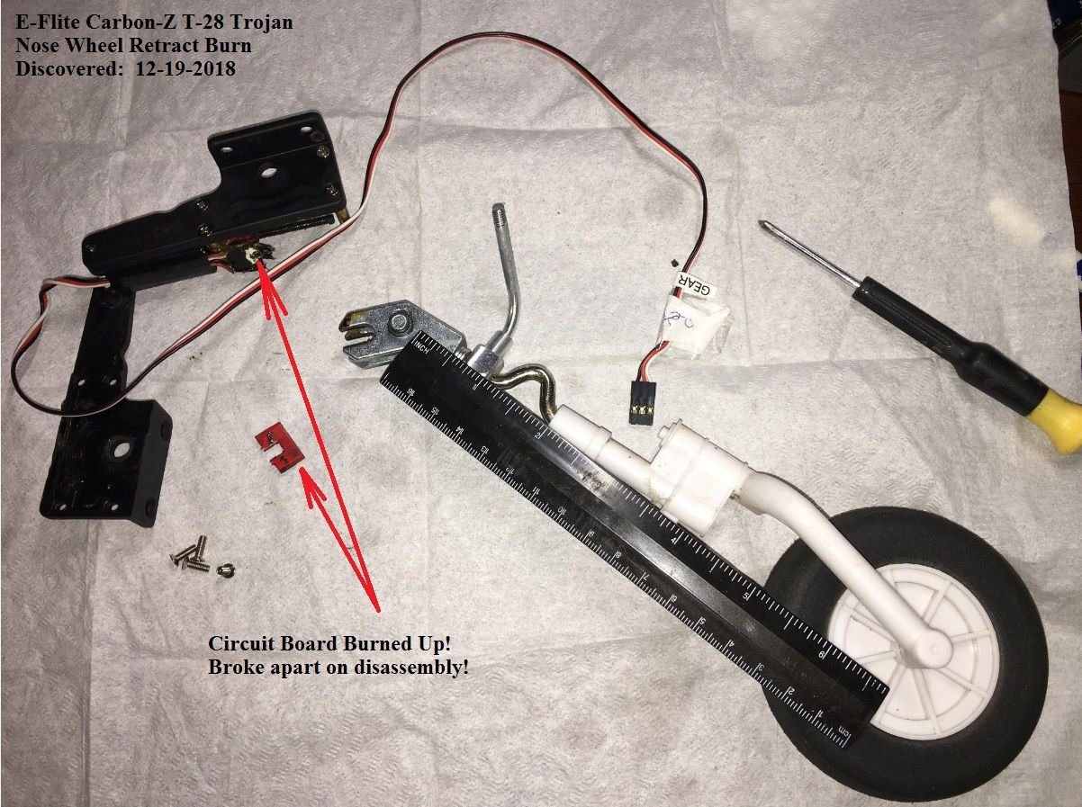

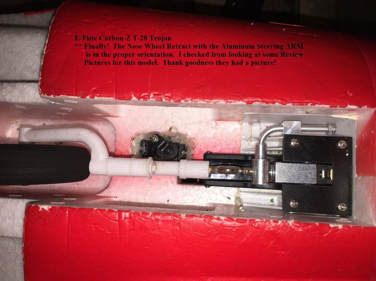

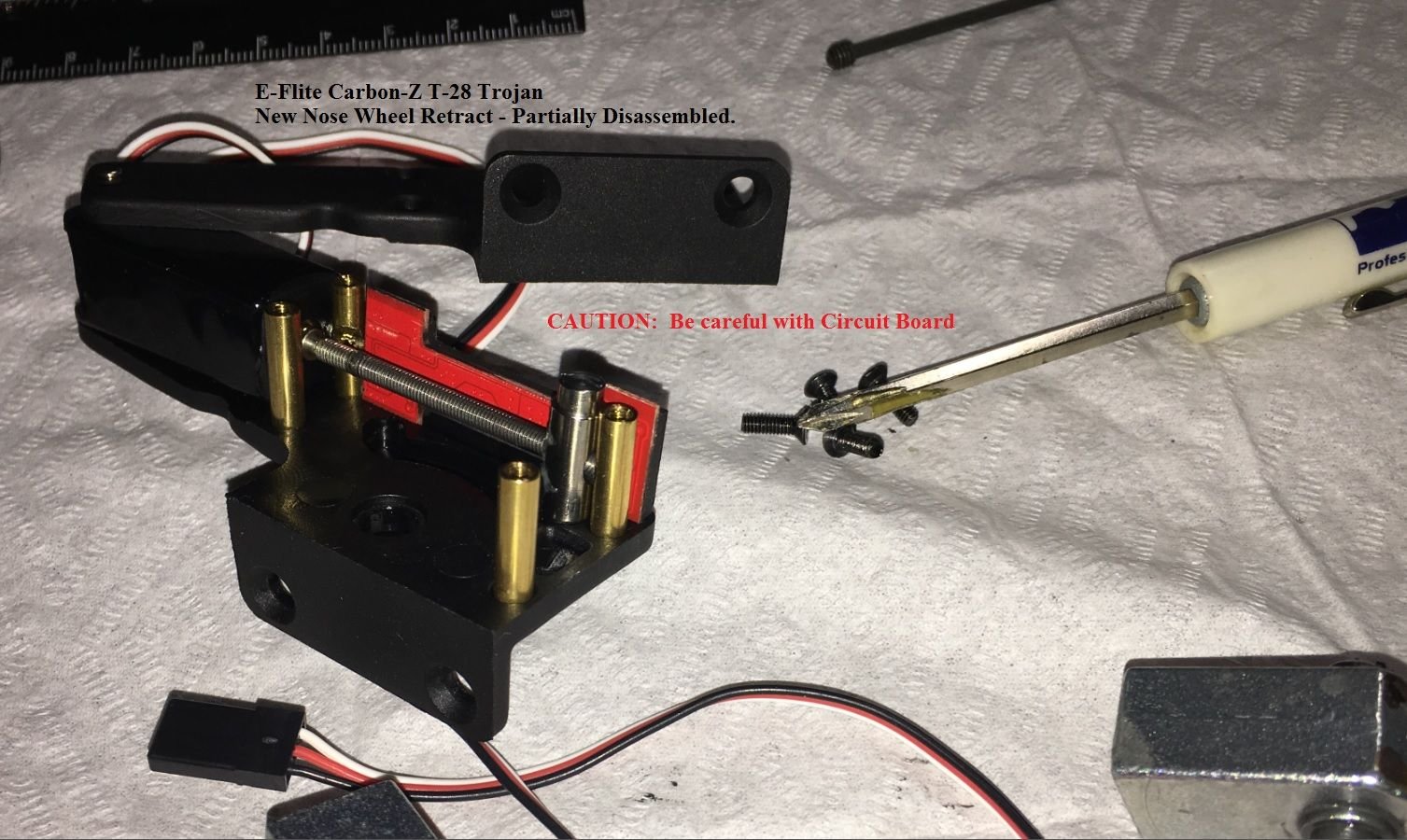

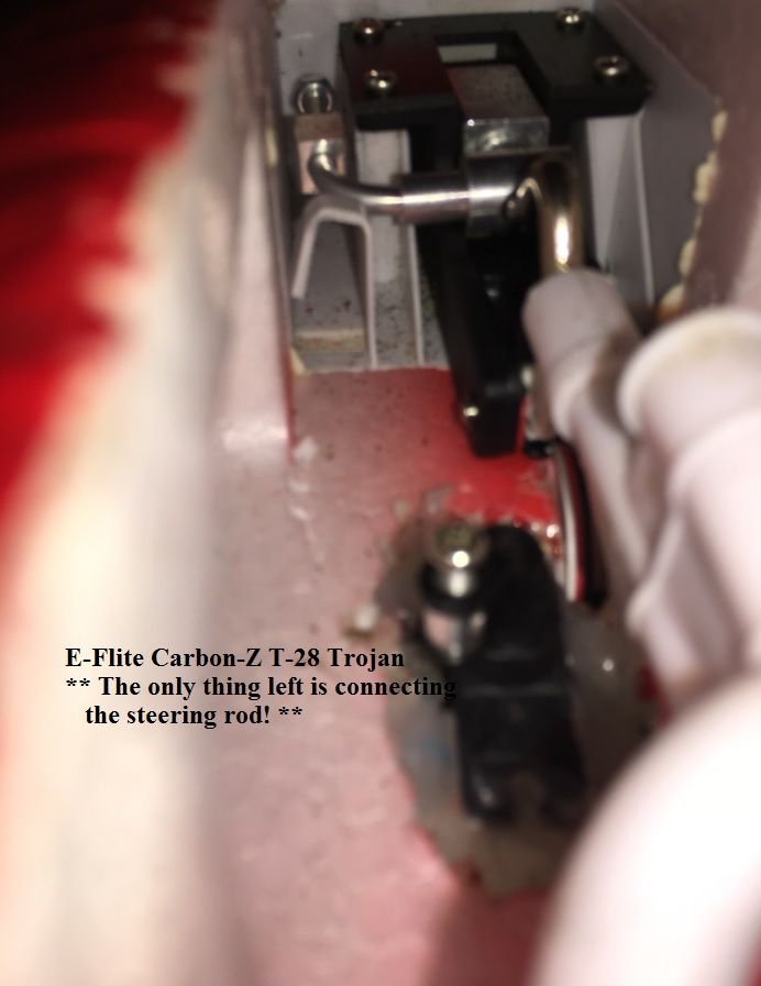

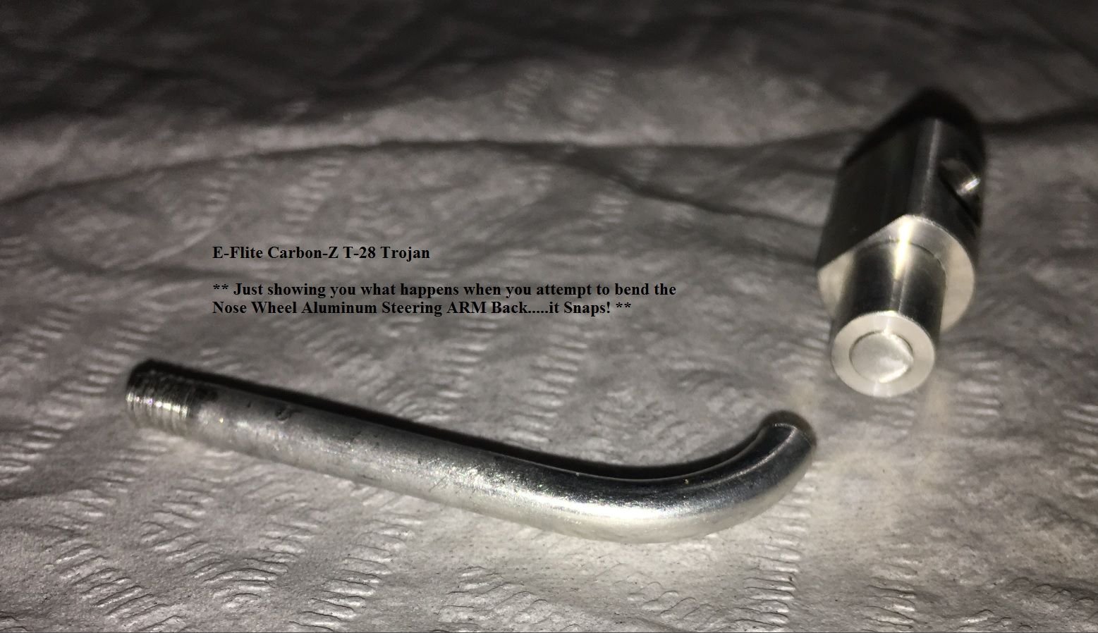

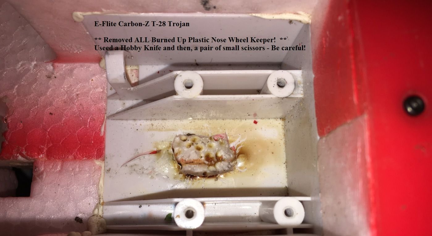

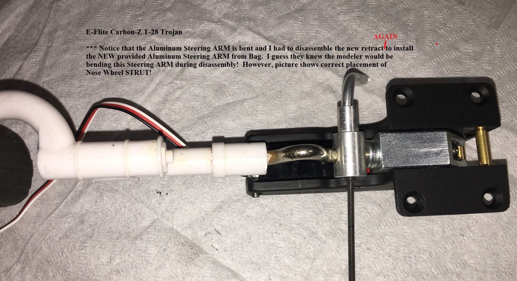

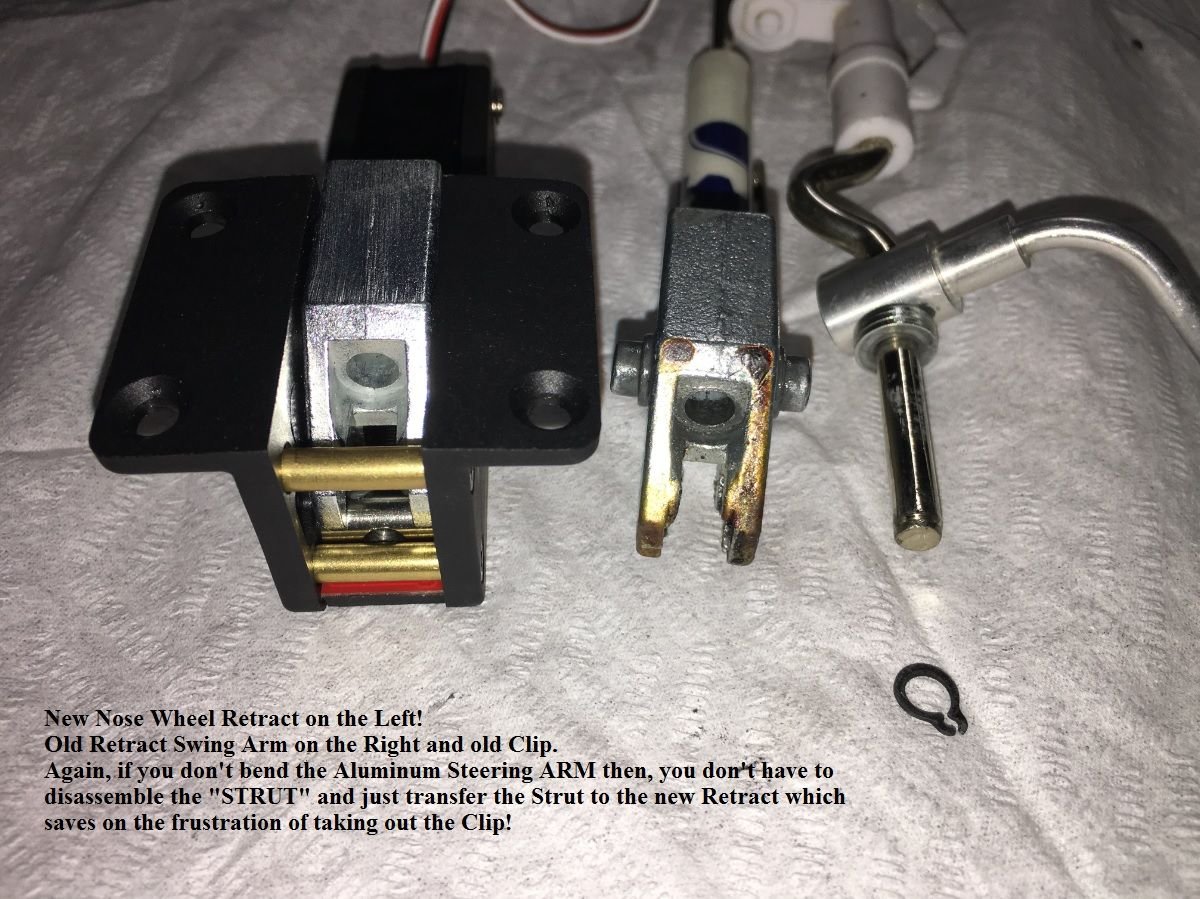

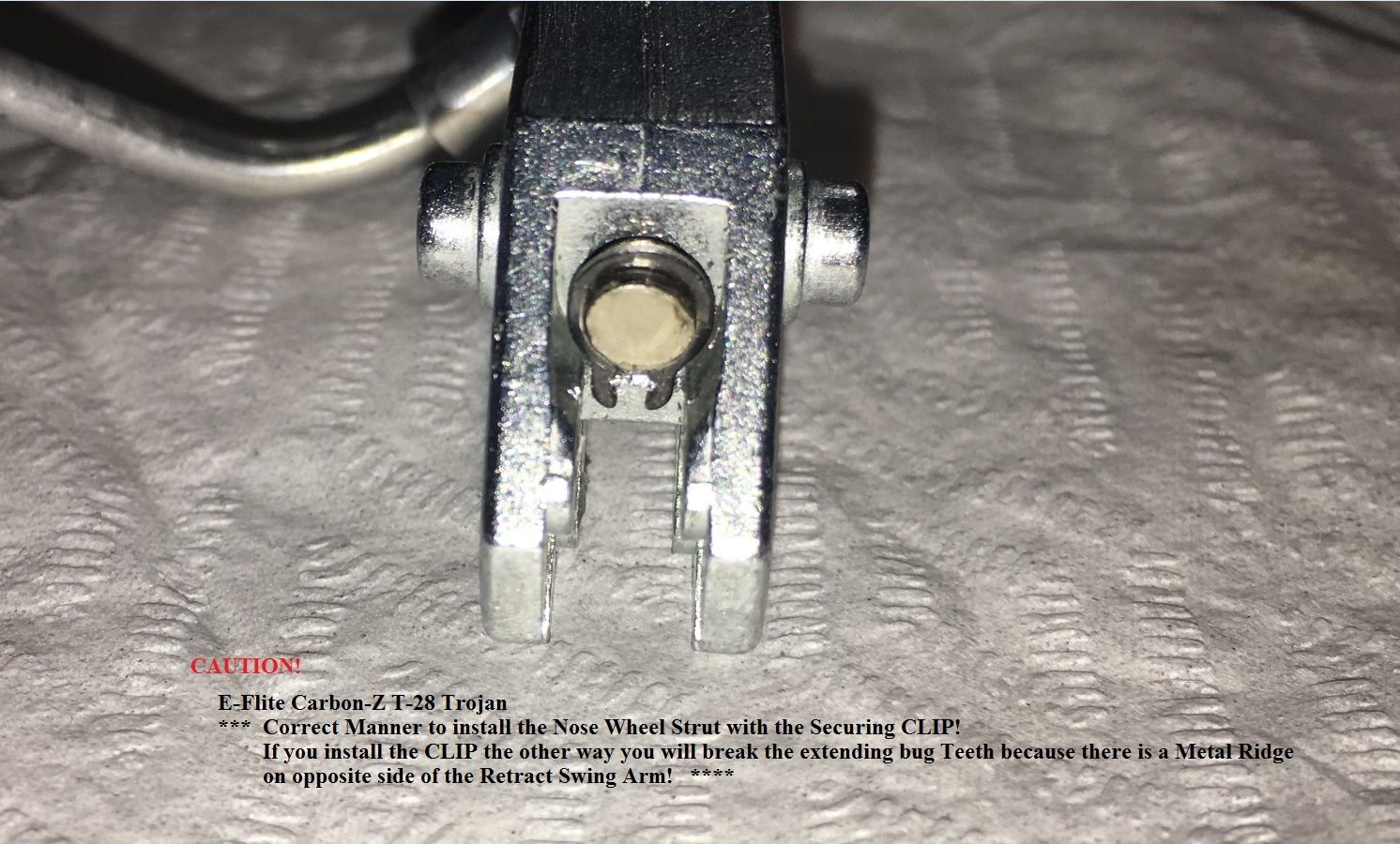

Guys,
About two months ago, I was able to acquire one used E-Flite Carbon-Z T-28 Trojan Monster! It came with a BURNED UP Nose Gear Retract. The Nose Wheel Steering servo still worked.
I see a few of you here has replaced the Nose Wheel Retract, replace the STOCK for STOCK nose wheel retract.
Let me tell you......................to me it was a BIG pain in the ASHE!
Okay, I am beat from a couple of hours with playing ROPE-A-DOPE with this Nose Wheel Retracts!
It seems like grease may have played a part in the BURNING of the Nose Wheel retract Circuit board "or" someone took-off or landed the model in WET GRASS!
You need to look at the pretty pictures I have provided to see what I had to do and some recommendations!
Thanks for your patience with me.
