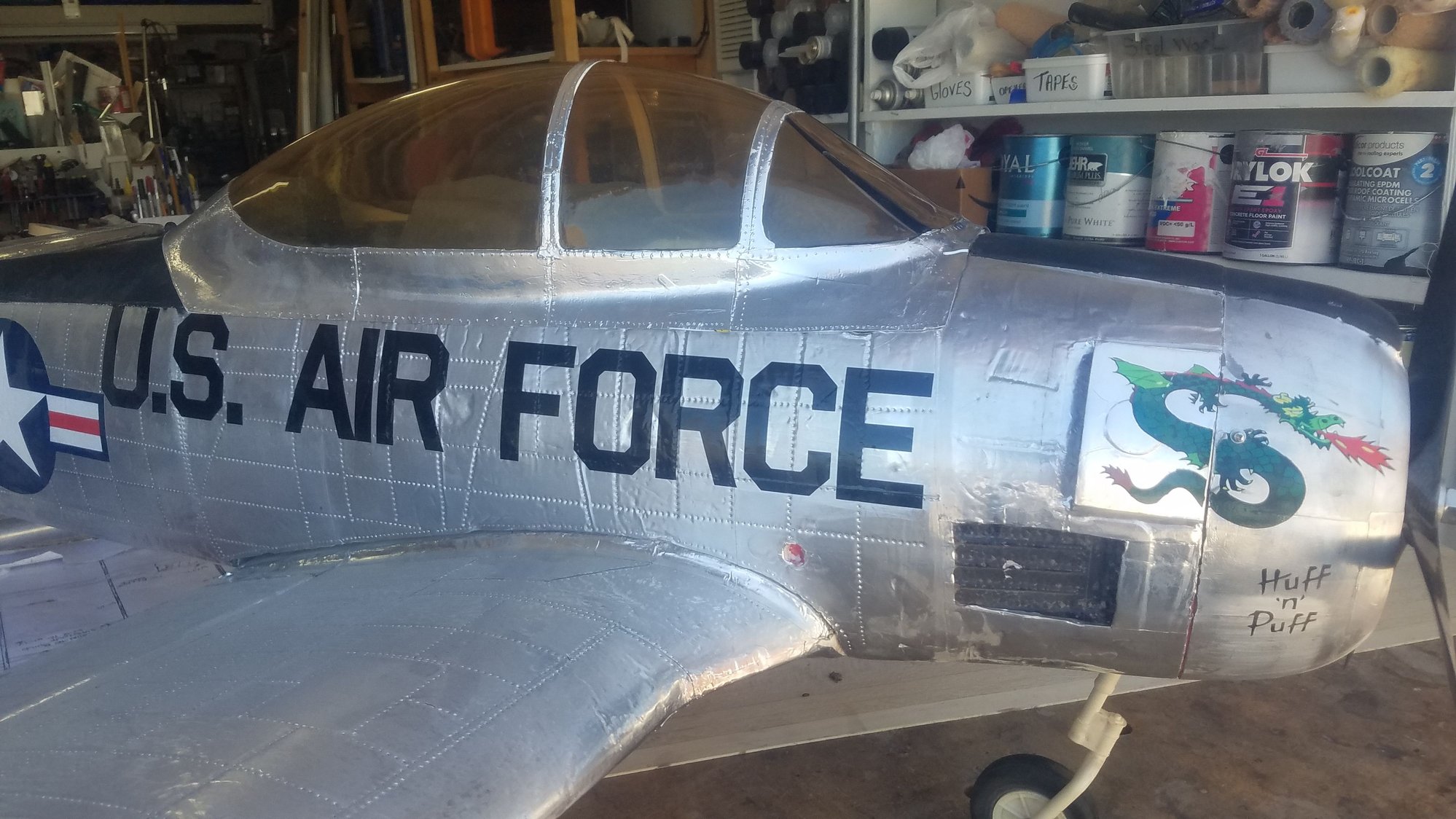

Being that I am a 30-year Air Force fighter pilot I couldn't let the T-28 continue as a Navy plane. I checked, and sure enough the Air Force did use the T-28 in a fighter squadron. After filling all the dings and creases in the foam, there were way more than what you would have thought, I glassed the foam with 1/2 oz glass (too light, should have used 3/4 oz). Then I used Flite Metal applying it per a scale drawing. Then the hours long process of doing all the rivets poked in to the Flite Metal. Got graphics from Callie for the Air Force squadron colors. I also upgraded the motor to an E-flite 110, upped the esc to a Castle 100 to drive it powered by 2 8S 5500 LIPO batteries wired in series. Next, I added the Mr. RC Sound system to give it some actual noise. By the way, the other flyers hate it when I turn it on, but it sounds great on start and in the air. Here are some photos, and I should say that the plane flies great, but it is definitely heavier and needs power on landing.
Air Force version of T-28
Upgraded to an E-Flite 110 motor
Callie graphics
Castle 100 esc
Receiver is a JR RG831B with Smart Fly Power expander Sport to isolate the servos from the receiver and keep it at a constant 5.0 volts. Isolation is Important here with the somewhat flaky electric gear. If one gear should short, it is dropped from the system and the receiver is unaffected.
Better shot of receiver setup. I use a JR 28X radio, so I have lots of options and a very solid system.
Mr. RC sound system
One of the two speakers used for the sound. They are actually transducers and work very well.
