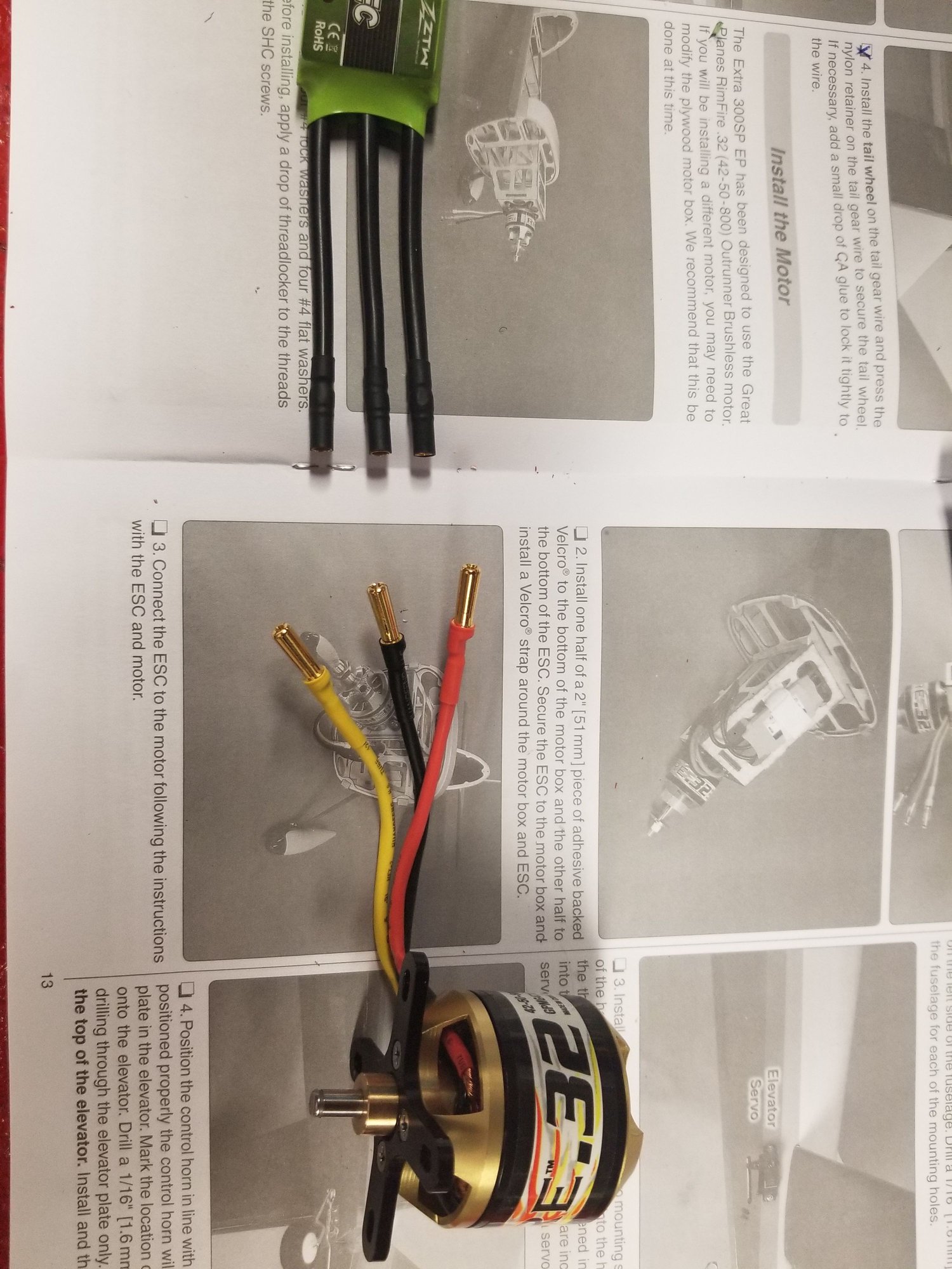

Pretty new to electric power. First time I've seen this, I bought a GP ARF along with the recommended motor. Why won't this plug into my esc? Aren't these things universal?

Horses for courses, several types, qualities and sizes, higher current means bigger connectors. However, voltage is not relevant.
Connector tests, plus pictures
translate...www.elektromodellflug.de/hochstrom-st.-bu..html
Older version of that page, contains some other connectors
translate...www.elektromodellflug.de/oldpage/hochstromst/hochstromstecker.htm

Soldering unsoldered/fresh motorwires can be tricky. They are the winding/coil wires and as such have an insulation coating/varnish that has to be removed. E.g. by heating the wire with soldering iron on real Aspirin tablet. Nasty/acrid fumes. Won't work for all types of insulation.
Don't cut off the original connectors of, especially motorconnectors, just de-solder them and you won't have to bother with the above.
Don't use adapter cables, extra points of failure and extra losses.
Vriendelijke groeten Ron
