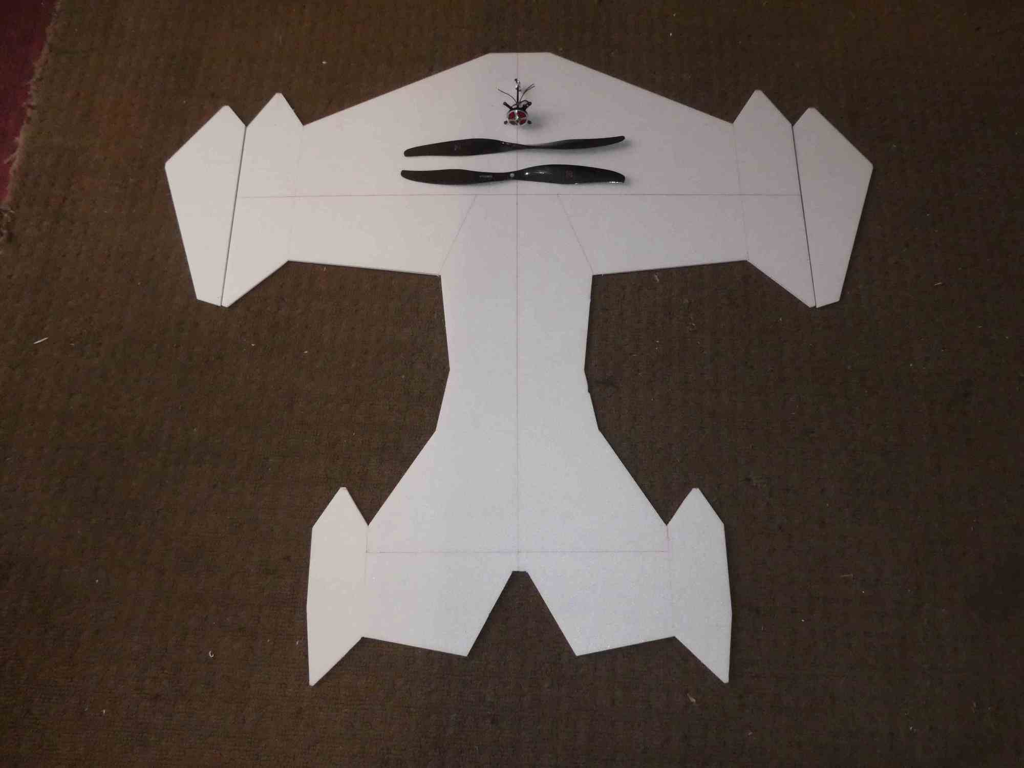

My latest creation to match Dualsky CR power unit, after another maiden success with my latest build. Something different again.
The best so far out of my "DC" series.
My latest design, the first cut.
This one will be alloy coated.

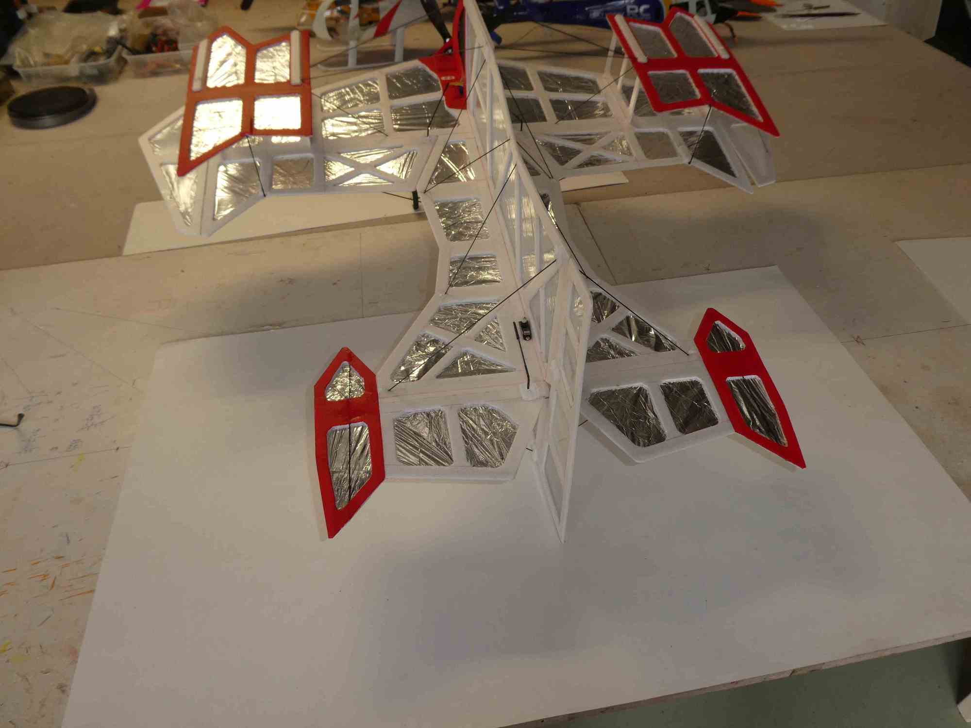

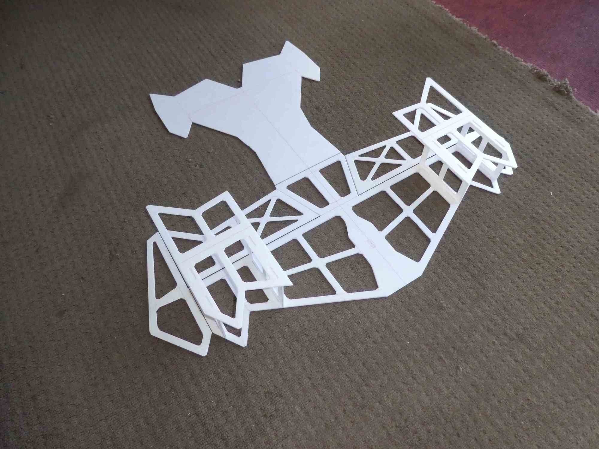

Playing with the sharp knife again and fine sandpaper, results are clear cuts.
My imagination going wild, LOL.

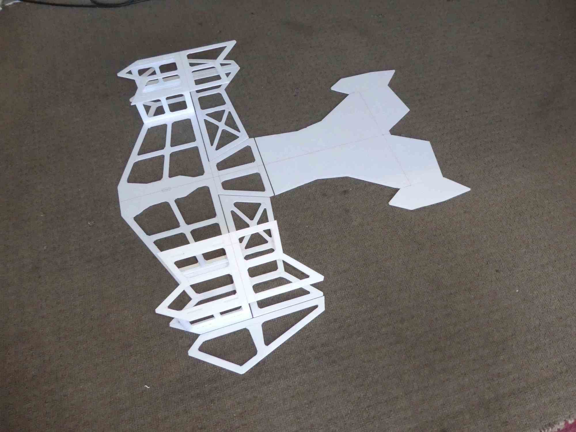

Coming along nicely after daily progress.

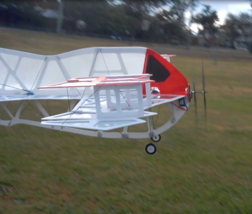

Further improvement to the frame, the Elevator moving tab curved a bit due to using too much of adhesive while applying the 5 micron Mylar, getting into the foam deforming it to some degree after full cure.
After few more flights I have decided to sort it out by adding 0.8mm CF rods to straighten and stiffen it up for more precise controls. Easy fix.
Another flight this morn, unfortunately abandoned after single flight due to the breeze up early.
I had a first go and fun flying this model backward into the breeze, LOL.
Top&bottom moving tab reinforcement.
Bit breezy this morn for precise controls.

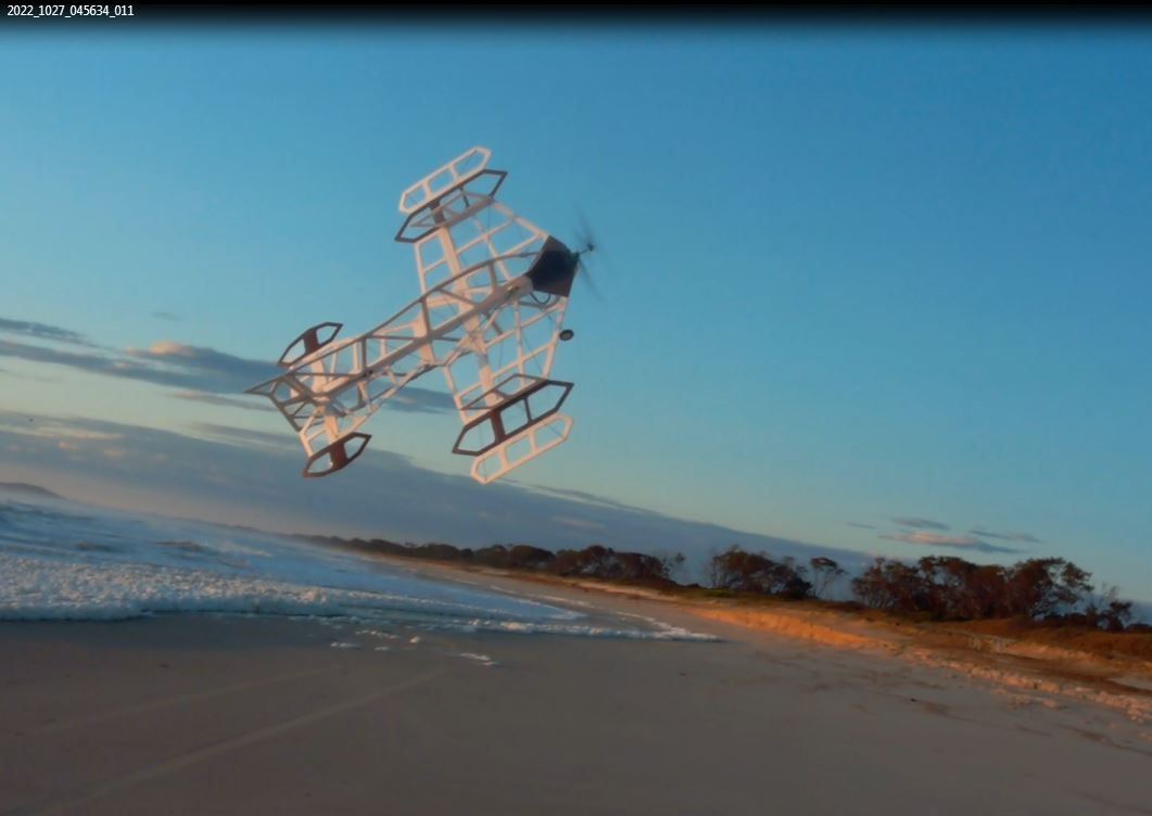

Now fitted with new Carbon Fiber micro light prop at lowest pitch, with further improvement.
Ski jumping my favored teen past time.
Fun in the bowl.
Low & Slow fun.
