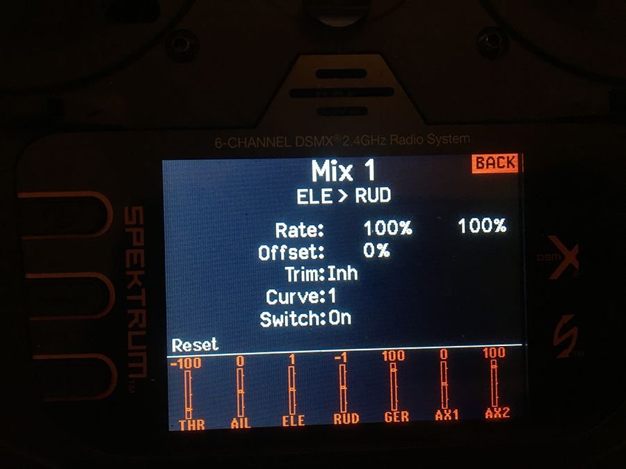

How to swap servo channels - Spektrum AR6400 Rx
hello

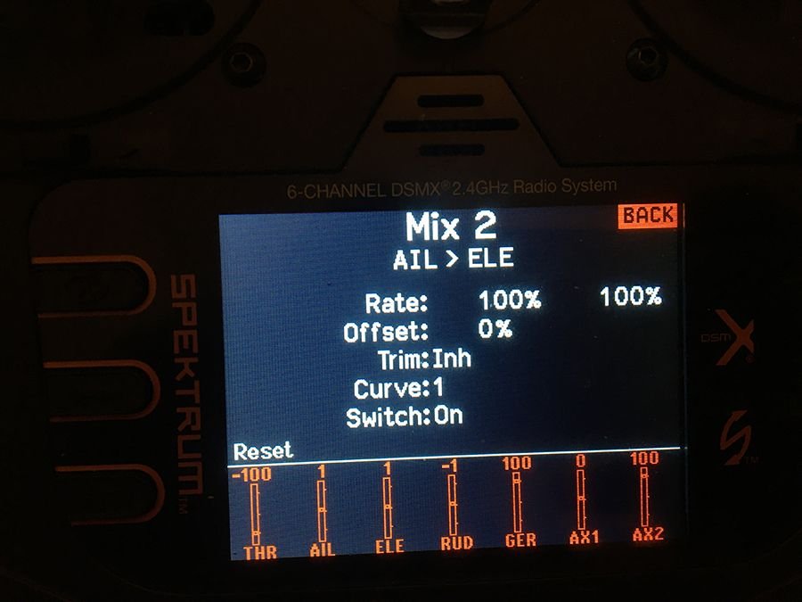

we are trying to swap servo channels on a receiver AR6400, we need the elevator channel to go on the bottom and rudder channel to go where the elevator channel is. Since the ar6400 has 2 linear servos, i figured i would do a mixing, and i was successful in swapping channels, see attached images.
the issue is now that when i move the elevator up and down, it moves both channels. Is there a way to stop the now rudder channel from moving when elevator sticks are engaged?
when rudder movement is engaged, it is all fine, elevator does not move.
side note, i have also made the rudder mixing to the aileron as i would like to have both sticks on the left side, this was also successful.
here is the setup i have so far. see attached files
any help would be greatly appreciated.
