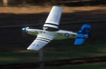

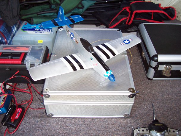

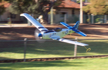

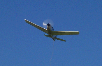

My LEE Mustang consists of an rcmart 4 ch mini Rx, 2 JR micro servos and a lipo ESC. I tore out the old 2.5V motor and replaced it with an EPD50 and trimmed/modded and glued the prop to the shaft. I used a 450mah 2 cell lipo, keeping the original switch setup for charging in there so I could use it for recharging the lipo and just stuck everything in using bouble sided tape.
I didnt try to save weight. I wasnt fussy about balancing it before flying. It was rough to say the least.
I maidened it and it flew without problems. It was tail heavy, so I added some lead (6g) and it flies fine now. I have been flying it a couple of times a day now and for a hack it is really impressing me because it was so quick and easy to convert and fly. Naturally, talk of making another now with lighter batteries and a brushless have already started with my flying buddies. Once used to flying it I will trim it out for slow flight and try it at my next indoor meet. This one is a bit of a bullet and I fly around at half throttle with ease!
Here are some inflight images:
Since taking these fotos I have mounted a 7gram BL motor to it and replaced the 450 battery with a 340 kokam. I had to add 10g extra weight to get the nose down again and it goes even faster now! I had to sticky tape 2mm CF rods to the underneath of the wings to stop them folding up. I learned this after they both snapped doing a tight turn full speed.
I have purchased another one and will be making this one aileron control
I have also purchased a zero and will do the same to that. These make great conversions and I am sure when Cox release their line of little fighters they will do well too!
