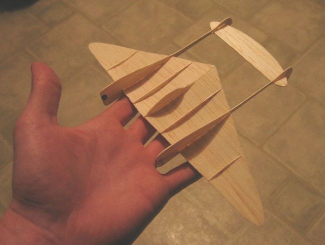

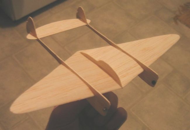

anyway, this is the newest plane i've made with the electronics. its a profile version of the Grokhovsky G-38 Light Cruiser. 10" wingspan, 3" chord at the root, 1/32" balsa, .020" CF reinforcement, AUW of just over 11 grams. it could be lighter, but i'm using a slightly larger, 160mah cell. it took a couple test flights (crashes) to get the CG right, but its now flying quite nicely. if i put the CG back a bit, i can almost get perfect 180 degree stall turns, looks cool.

I've tryed and failed many small EP balsas, so I was hoping some kind person could post some plans/specs later
