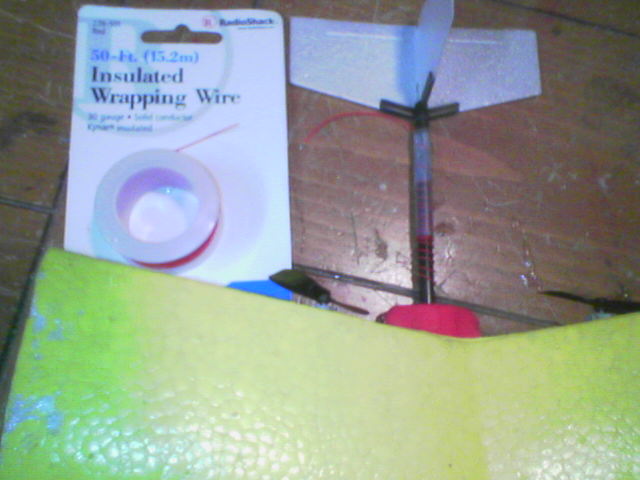

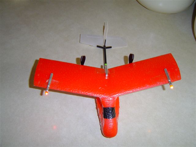

Ok boyz!! I made my antenna longer today and I got lots of range now. Not too sure wow high I was able to fly it but it had to be around 200 to 250 feet and I still had control. Here is what I did to extend it.
I got some 30 gauge solid conductor insulated wrapping wire from radioshack.
I cut about a 2 foot piece and stripped one end. about an inch.
I took of the tail section. It slipped off with just a pinch from my plyers.
Then I was able to see about an inch of the existing antenna sticking out of the boom.
Then I used a T pin and put a hole in the boom close to the body of the plane.
Then I took the new wire and feed it in the hole and out the back where the existing antenna was sticking out.
Then I just wrapped the new wire onto the existing antenna and put a bit of solder on it then push it into the boom.
Then I took the rest of the wire sticking out of the hole I made with the T pin and wrapped it around the boom to the back of the plane.
I used some tape to hold the wire to the boom and put the tail section back on with a drop of CA. (make sure it's lined up with the wing)
This mod made my AA 200 times better. I loved my AA before this mod and now it's just the best lil toy I have.
