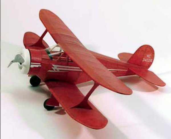

After building and flying a .90 4-stroke powered Royal Staggerwing I wanted to build a small one by converting a rubber power kit. While not sure if it should be classed as an indoor or a park flier, I'm building a Dumas 17.5" Beech Staggerwing for 4-channel e-power using:[ul][*] Bluebird BMR-4 receiver[*] (3ea.) Blue Arrow BA-TS-4.3 micro servos[*] E-TEC 7.4v LiPo battery[*] Astro Flight Firefly brushless motor/ESC combination
[/ul] The wing area comes out at 85 sq. in. and should come out light enough using colored tissue and clear dope. The hardest part was making the ailerons and a light torque rod linkage, but it worked out just fine.
In the process of covering now and learning new French words as I recall the 'good old' days (not!) of tissue and stick construction. Here is a stock photo of a typical Dumas Beech Staggerwing for rubber power. I'll post a photo of the completed electric powered model when I complete it.
