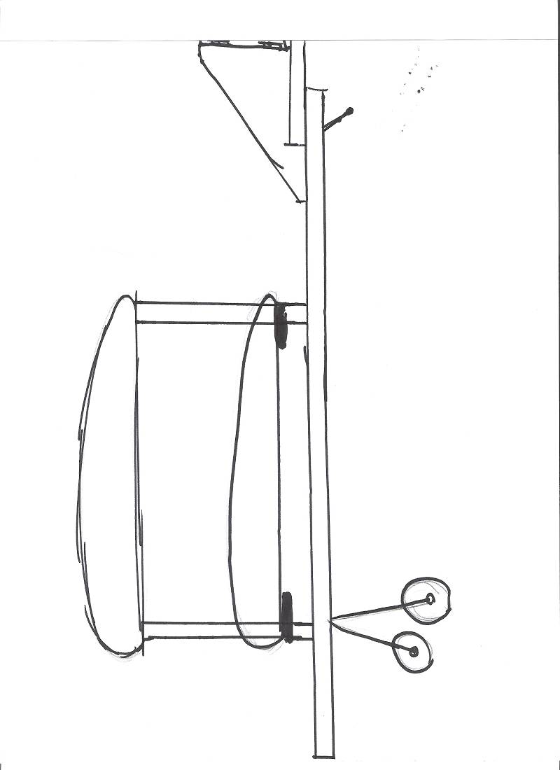

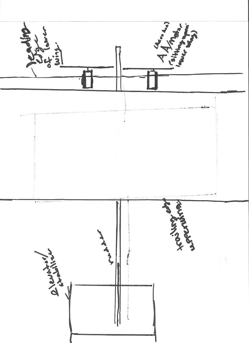

Here's some plans (or more like drawings) I drew em up real quick just to show you what I have in mind! There real basic, and aren't the best designs. This is a rough sketch. I'm sure the cog is off but I'll tune it up later.

your plans look good! but do you have an idea of what size it is going to be?

on the first picture on post 4 the big wings (the ones in front) need to have dihedral. and the bottom of the wings should curved a little to give it lift.

Well here's the thing, It's going to be a balsa tissue model so to get curve on the bottom wing will be tough. Unless I make the wings foam!

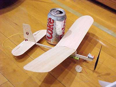

Well I'm not sure If I know what your talking about. I was thinking of doing a balsa tissue wing. Not just a full balsa sheet wing. I'm kinda confused (like always), but are you opposing to a balsa sheet wing or a balsa tissue wing. 1st pic. is an example of a balsa sheet wing. And a balsa tissue wing has a balsa stick frame that the tissue paper covers.

what i meant was when you put wings on a plane they have to have some dihedral like they go up on a slight angle but from your picture it looks like you know how to do the dihedral. i'm lost, could you explain to me the difference between balsa sheet and balsa tissue[sm=confused.gif][sm=confused.gif]. btw, your plane looks good. it looks like it was 3 channel, was it??
Old 06-30-2006, 02:07 PM
EvaderMaster's Avatar
Join Date: Aug 2005
Location: no city, CA
Posts: 615
Default RE: Thoughts of an Aero ace slow flyer?
Lol, Thats not my plane I got that from the net.

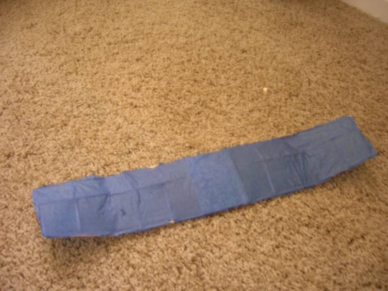

yes. The difference is simply this. The picture of the plane I posted above has a balsa sheet wing. And this picture is an example of a balsa tissue wing I made from a kit.

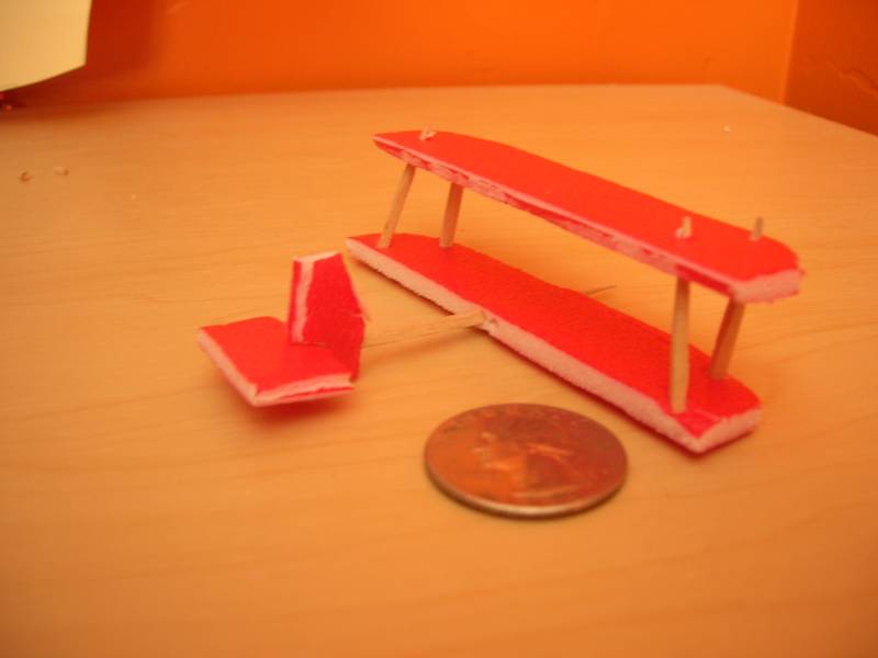

Lol, I made a smaller model of the bipe. I used tooth picks and left over scrapts of foam. (if there was enough foam I would make the bigger one), Everything is how the AA bipe will look like except the smaller version does not have curve on the wing nor does it have eletronics. (I just got bored of sitting at the screen and waiting for someone to reply(LOL), so I went and made this).

The slowest I've been able to get the AA to fly using stick & tissue
is with a Strato Streak wing. It floated around the park nicely
(better with no wind) but could never fly around a living room.
It had a 16" wingspan and weighed 18 grams., a cola straw for
the tail boom and foam stab & rudder. There's a pic in my gallery.
Not sure you could even make an AA light & small enough to fly
around a living room. Those planes usually weigh in the range of
5 to 8 grams. The AA guts alone are 10.

A 12" ws should work depending on the wing area so you might
want to fatten it up a bit. Yes a smaller plane is lighter but may
not hold up the weight of the AA guts in flight. You might want
to build a stick wing and instead of tissue use Reynolds plastic
wrap. It's a bit lighter.
I still don't believe you could slow the plane down enough for a
living room flyer. Would make a great gymnasium flyer though.
Also the motors on your previous plans are too close together and
the angle of the wing should be moved a bit higher on the leading
edge. There should be some upward thrust from the motors to the
wing to help give it lift.
