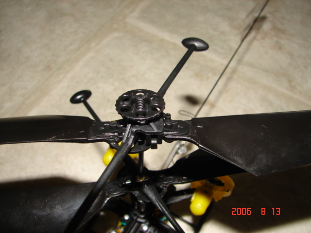

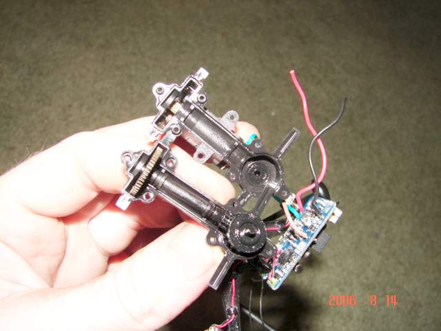

i picked one of these up a few days ago. i've flown the BR helis, and the SpinBlade heli, and i gotta say that the Helix is my favorite so far. the BRs and SBs have pretty limited control, but have lots of stability. the helix is a pig at 53 grams, but its just as stable as the other two, but it also has a lot more control once its tinkered with a little bit. the two side motors with their tiny props actually work pretty well, i was able to get some interesting manuvers out of it while flying.
i didnt check the flight time, but its certainly long enough with its 300mah cell. speaking of which, after about 4 or 5 cycles through the cell, mine puffed up so i dunked it in salt water - i dont trust any lipo that doesnt look perfectly fine (and even then i'm still careful). so, i need a replacement cell, but otherwise its a fun thing to play with. it takes a little more room to fly, or at least more concentration to keep it going where you want it. the CG is set too far forward, so maintaining a hover is just about impossible, but after i removed 7+ grams and changed the CG location, its hovers nicely now. and, unlike the BR or SB helis, you certainly dont want your fingers near the blades on this one, they're thick and heavy and spin up very fast, and would probably hurt like hell if you caught one.
there is no left/right trim knob on the TX, rather, they took some lateral thinking and put a trim wheel on the top rotor. turn it clockwise and it tilts the rotors up, turn it counter clockwise and it tilts them down. it works pretty well actually, unique design. the RX looks big and bulky, but the way its set up would be perfect for a plane with a single motor and ailerons/elevons. the props on the 6x12mm thrust motors look very intersting as well, i'll probably take one off and put it on the thrust stand and see how much thrust they produce. might work well for other applications.
the drive train is nothing like i've ever seen in a heli, it looks more like something that came out of a RC car. certainly not efficient as possible, but it works. here's some pictures.

MB, Does it fly a lot better with the changes that you have made? Have you tried putting lights on it? I have some 3.7v 10,500mcd L.E.D's I wonder if they would work.I was thinking about removing the throttle spring also.

DJ,
the heli was certainly easier to get moving with all the weight removed, flight times improved as well since i didnt have to fly at a higher throttle position. it would get squirly easier, but worth it in the long run - if nothing else, removing the body helps that motor stay cooler. i didnt put any lights on it, as the lipo swelled after only 10 flights or so, its been grounded for a while now.
