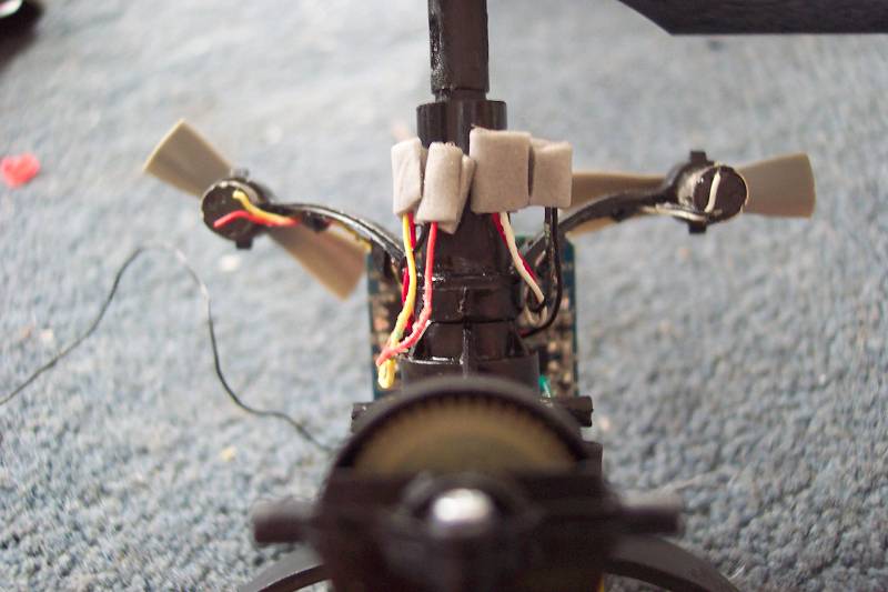

aero ace motor mod:
tools:
wire cutters
materials:
electrical tape
double sided foam tape
2 aero ace motors
step one- remove the motor covers.
step two-use the wire cutters and cut the wires to the motor off right at the motor end. strip off about a 1/4 inch of tubing. then slide the wires through the circular holders on the motor arms so that you have enough free play to connect the new motors.
step three-strip the wires on the ends on the aero ace motors equal to the amount of the wire striped from the heli. connect the motor wires to the heli wires and using the prop for the side being connected turn on and test the motor to see that forward work as forward. if not then switch the wire connection. then re test. if it works properly then use a 1/4 inch by 1/4 piece of double sided foam tape and wrap the bare end of the wires so that no bare wire is exposed. repeat for the opposite side.
step four-using the wire cutters make a cut in each the circular wire holders. then push the wires back into the holders. you might need to use pliers to re close the holders enough to keep the wires from popping out.
step five-take the foam cover ends of the wires and move them up and onto the rotor shaft casing as seen in my pics and stick them to the casing. then take a peice of electrical tape about 3 inches long, and cut it in half length wise so that it half as wide. then use it to secure the wire to the casing as shown in the pics. or if you dont have enough wire length to reach this spot or dont like it this way mount them wherever. the key is to keep them awat from any moving objects and to ensure that the bare wires are sealed from contacting each other or ant other electrical parts on the heli.

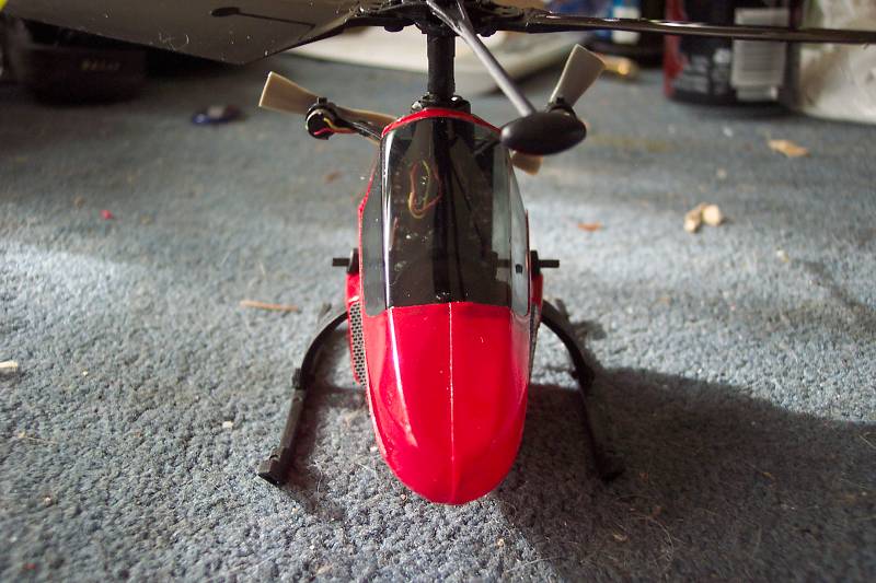

cx-2 custom trimmed canopy.
tools:
scissors
materials:
blade cx-2 canopy.
step one- i used scissors to cut the canopy of the cx-2 just behind the red line across the center of the window so that im only using the front half of the canopy. then i cut slits on the sides to allow it to slide over the skid arms. just above these slits i drilled holes and put the rubber gromets into the holes just as it is normally on the canopy. then i took the carbon fiber shaft and slide it through a spot on the frame between the rotor shaft casing and the top half of the lower frame where there is a slight angled opening. once its in place i took the ends of the "cf" shaft and slide them onto the gromets as it normally mounts.

Looks great Chris! How does it fly? Range has been an issue with both of my reflex's. The longer antenna looks like the range issue is solved. Did you mod the tx. I have read that the thruster stick can be made 360 deg by removing something on the inside. I want to try that but... so far no nerve! Oops , maybe it was you that talked about the tx mod? Guess I should look for a suitable fuslage before I cut mine up. The cx2 canopy looks great! It will be tough to actually reduce weight by changing the fuselage since the styro is ugly but fairly light. Thanks for the detail & the pics. AWESOME!
Join Date: May 2007
Location: glens falls,
NY
Posts: 494
RE: CHRIS' MODDED REFLEX W/ INSTRUCTIONS
yes i did the tx mod. if you take apart the tc the circuit board is screwed to the controller housing. unscrew it and there is the thruster stick, you'll see a silver metal pin on the base of the thruster stick. slide off the plastic ball base and then use wire cutters to cut the metal pin off. it does allow the stick to move 360, but it wont change the controls. the reason for this is that once you have the circuit board off you'll notice that the control input for the thrusters have little rubber buttons, these arent proportional. if it were proportional then it would make a difference. but all it really does is allow you to give quicker control imputs. it is a plus, but not a worth while mod for the begginer. im looking into finding a way to allow steering trim, which i think air hogs should have done from the get go.
also i want to add that doing the antenna tail boom does increase range. and on the plus side if you want a little more forwad drift from the heli all you need to do is simply slide the antenna in as if you were closing it when done flying. what this does is change the leverage on the tail, decreasing the length gives it more forward movement, increasing the length decreases the forward movement.
to answer your question waterboy, this thing has incredible forward movement, however the force that the flybar puts on the heli will act against the thrust from the props. if you give it a few short burst of forward thrust then this effect doesnt really cause an opposite reaction. but if you give it full forward thrust for a longer period of time then it does try togo back in the direction that it came. im working to try to find a way to dampen the effect of the flybar at the moment. so as soon as i find something this thread will be the first place that i post it. good luck with your modding guys, chris
