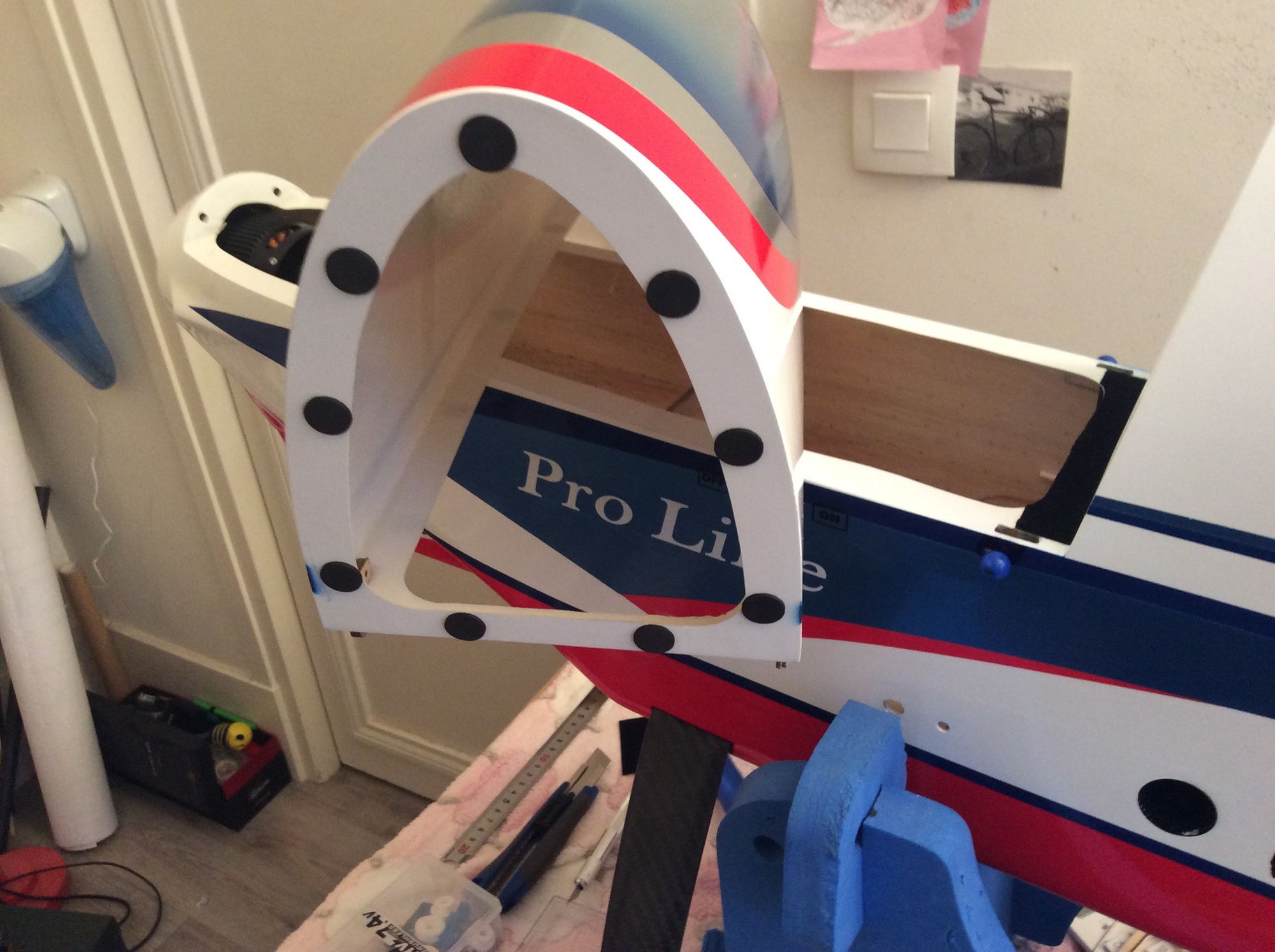

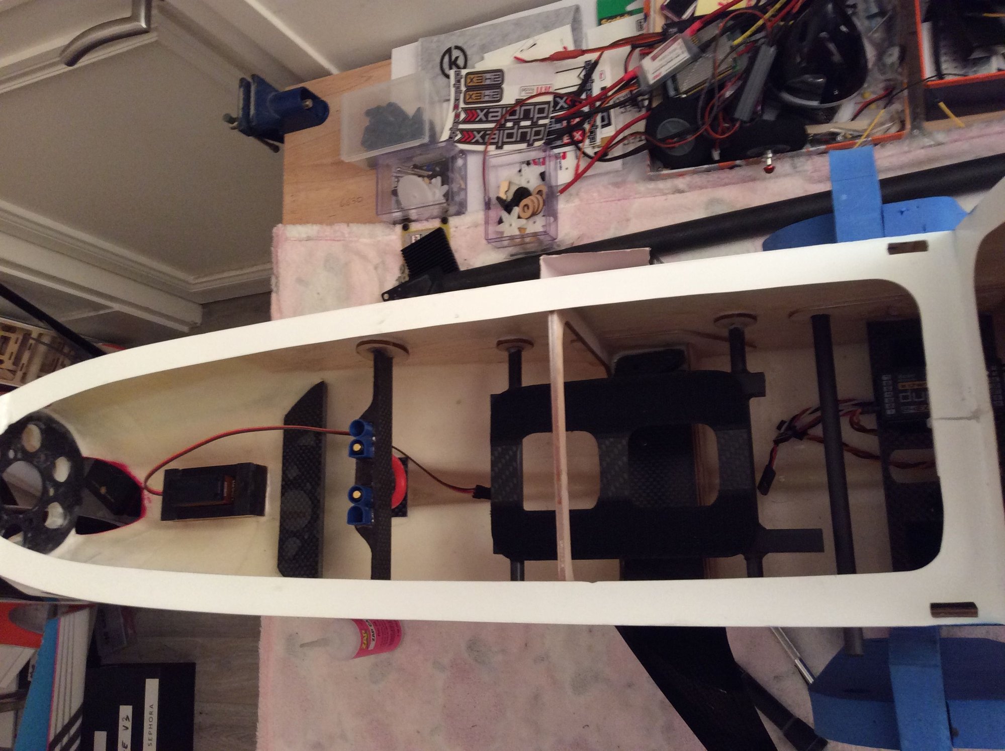

I've built two of these for Joe Walker. I opted to place a bulkhead directly behind the two front canalizer mounting screws. It significantly stiffens the canalizer mounting saddle and minimizes the twist that can occur when one tries to twist the canalizer out of parallel with the wing.

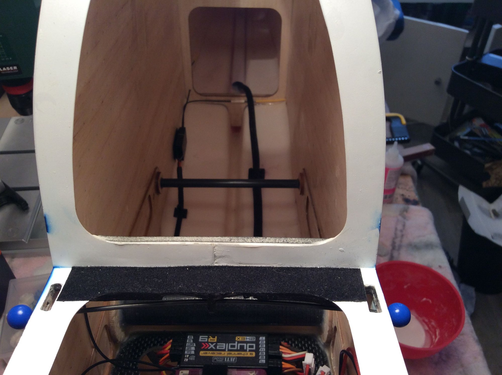

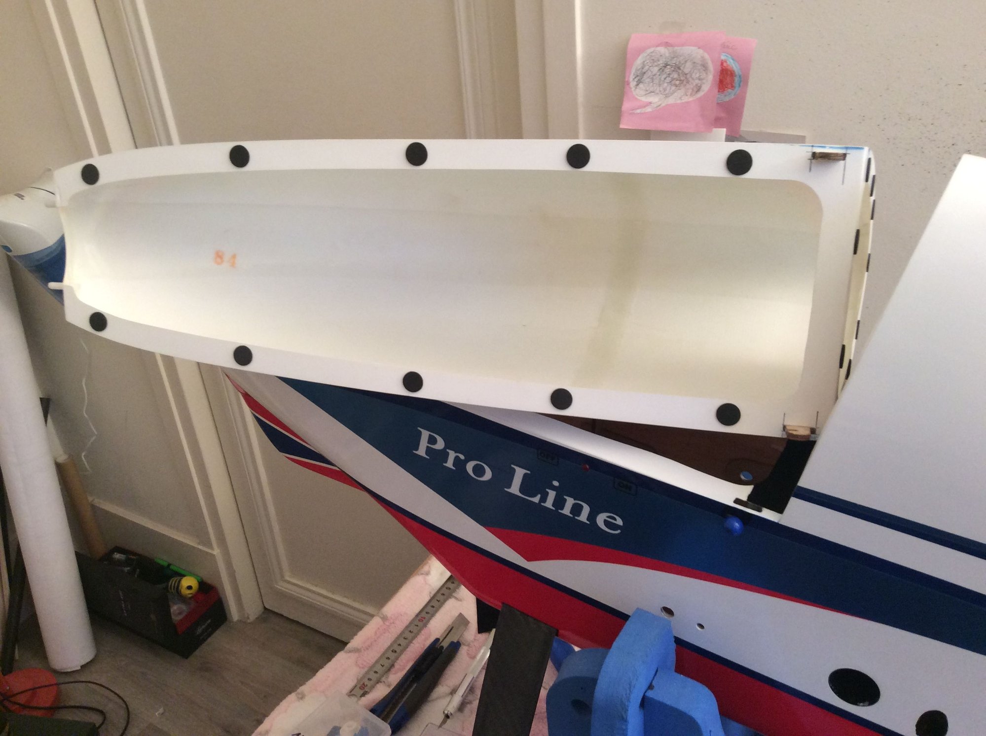

The canopy fixation is modified with a carbon rod, but this need a reinforcement ...

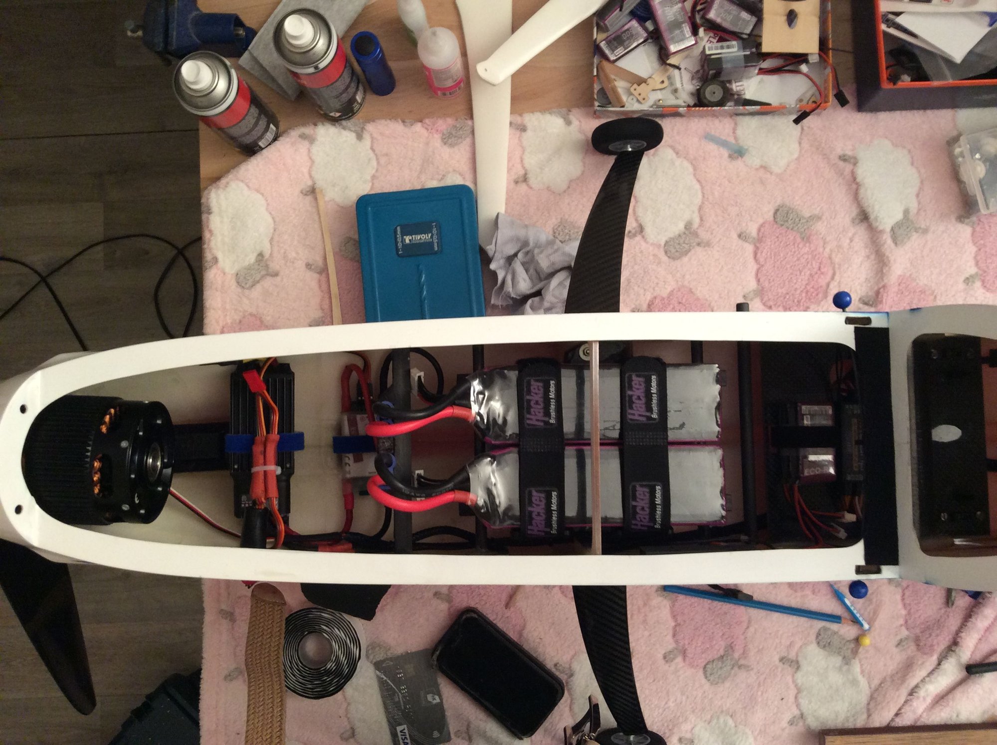

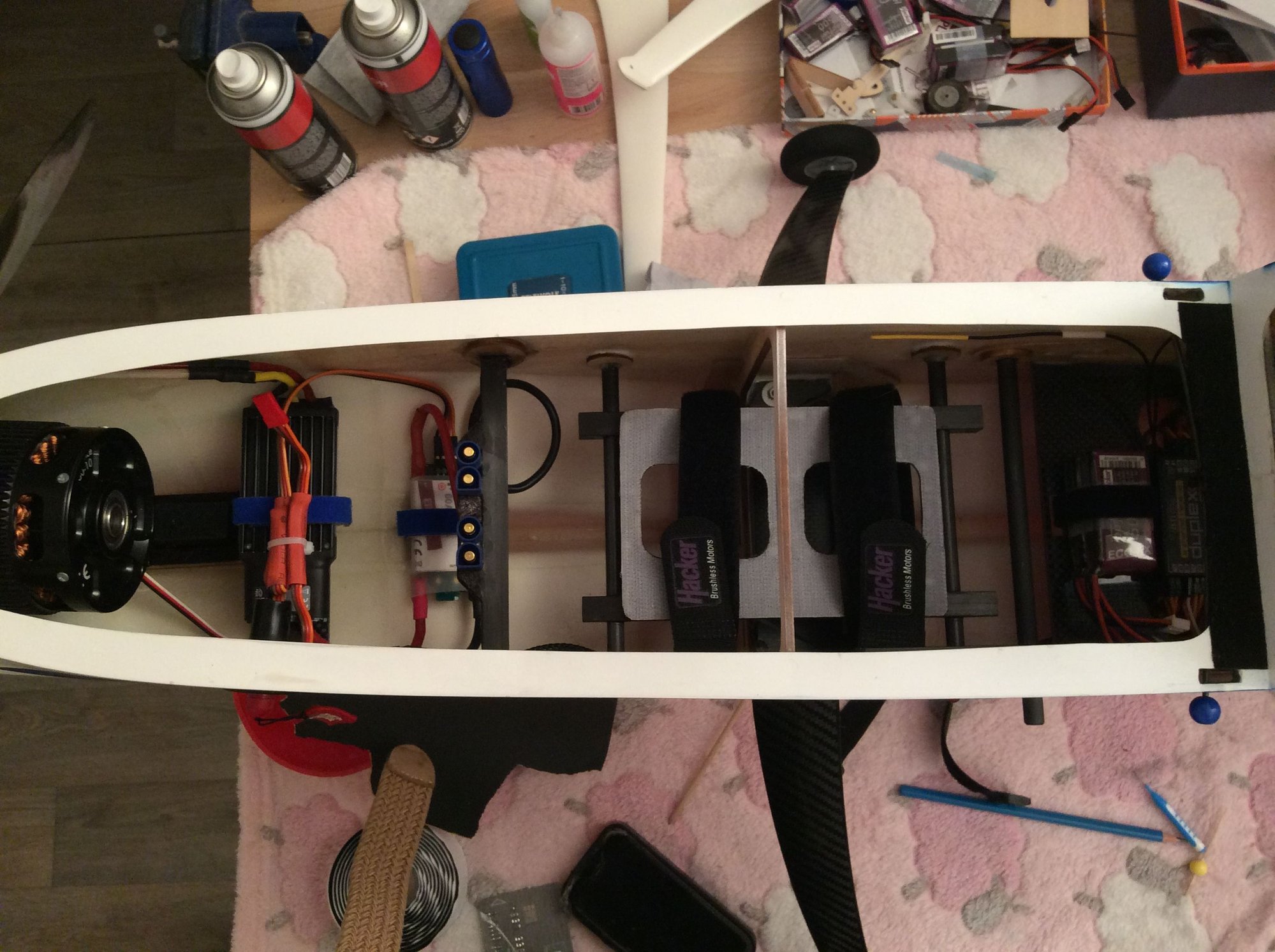

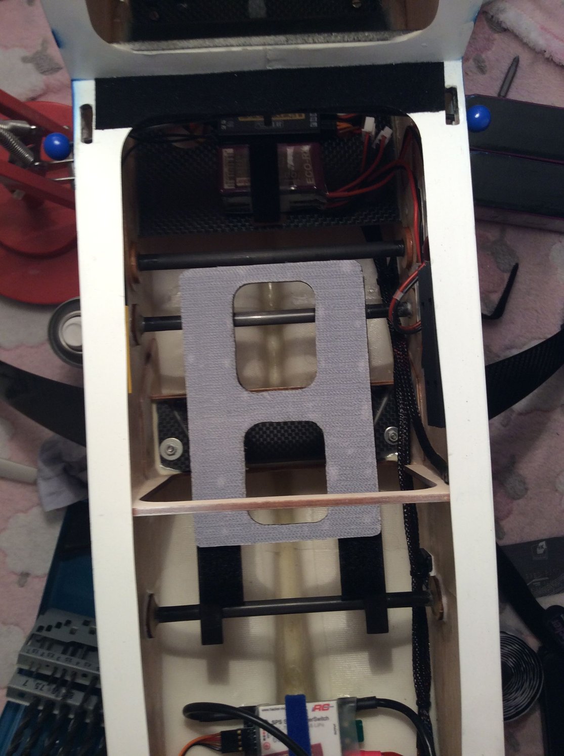

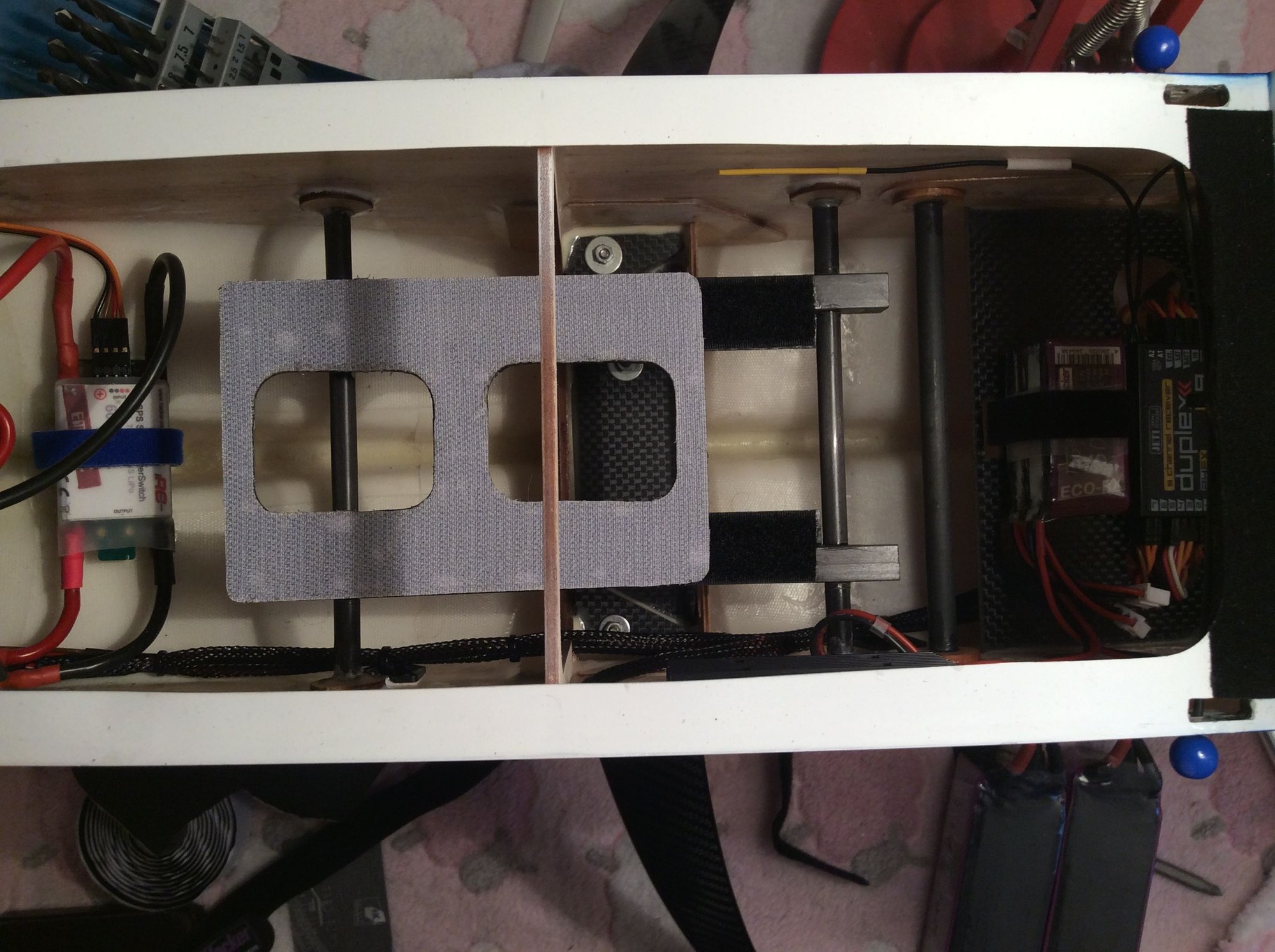

The battery tray installation is very similar to the IMMORTAL.
With all the extras, frudder and flaps servos, reinforcement, the plane completed and ready to fly comes at 4820 g with 5000 10S Dualsky Batteries and wheels pants (not on the pics).
The CG is at 180 mm from the leading edge for the maiden flight.....

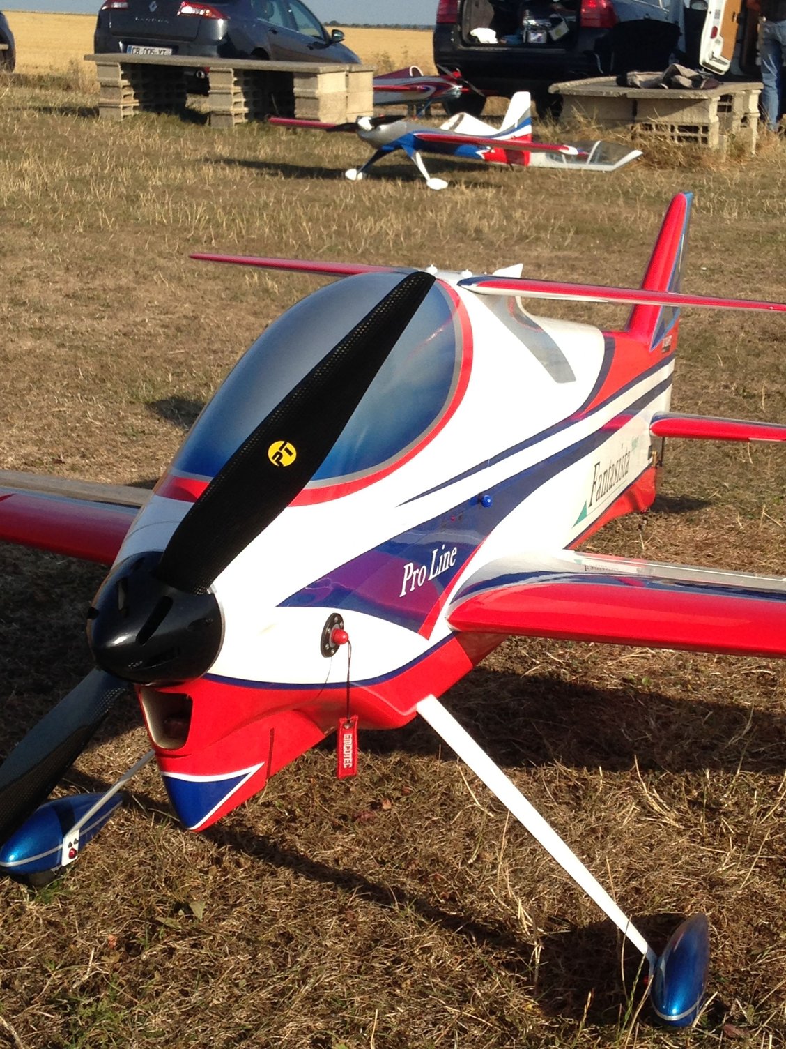

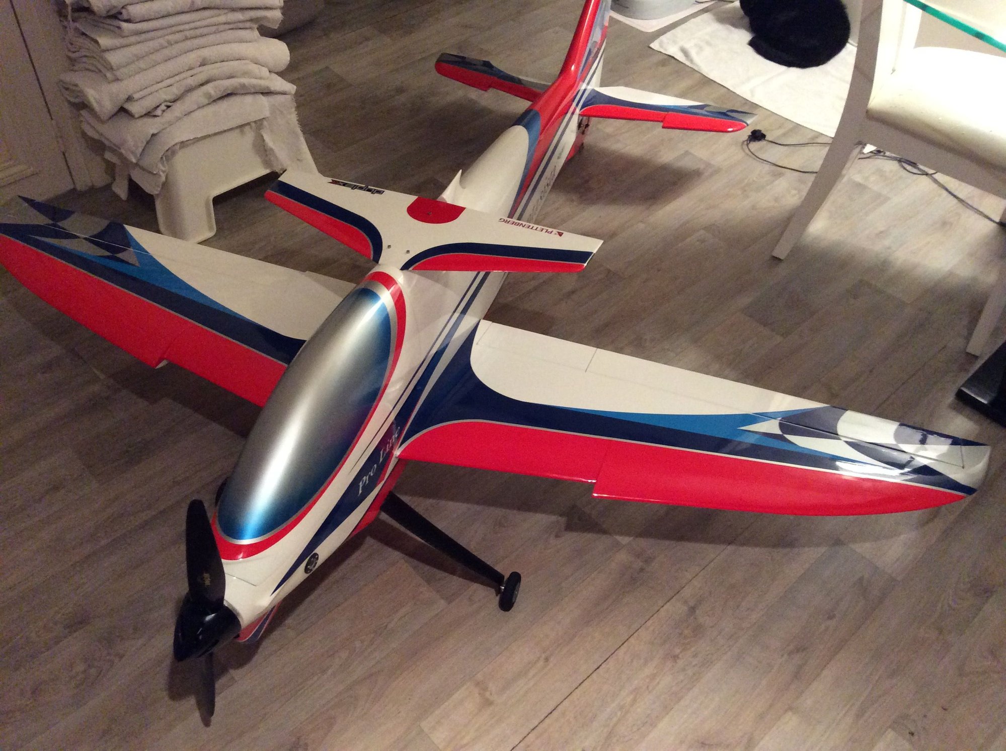

First flights of the SUPER FANTASISTA
With the National this week end, we had not too much time to evaluate the plane, but it's very encouraging :
Climb straight, no need to adjust the engine ( wing incidence is not adjustable)
Need a 2% to elev mixing in the downline
Knife edge don't apparently need mixing with the ailerons, and CG seems to be OK .
More testing next week...

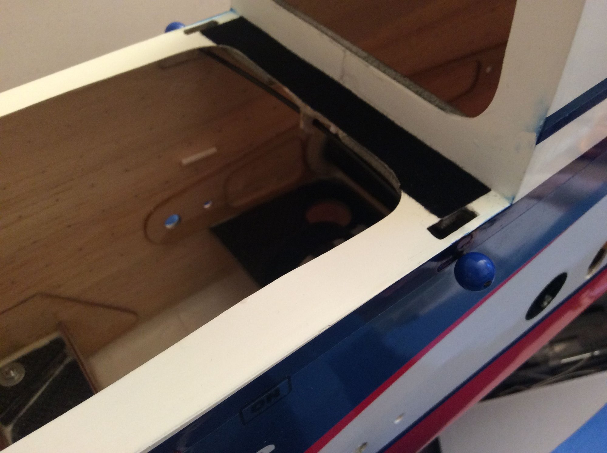

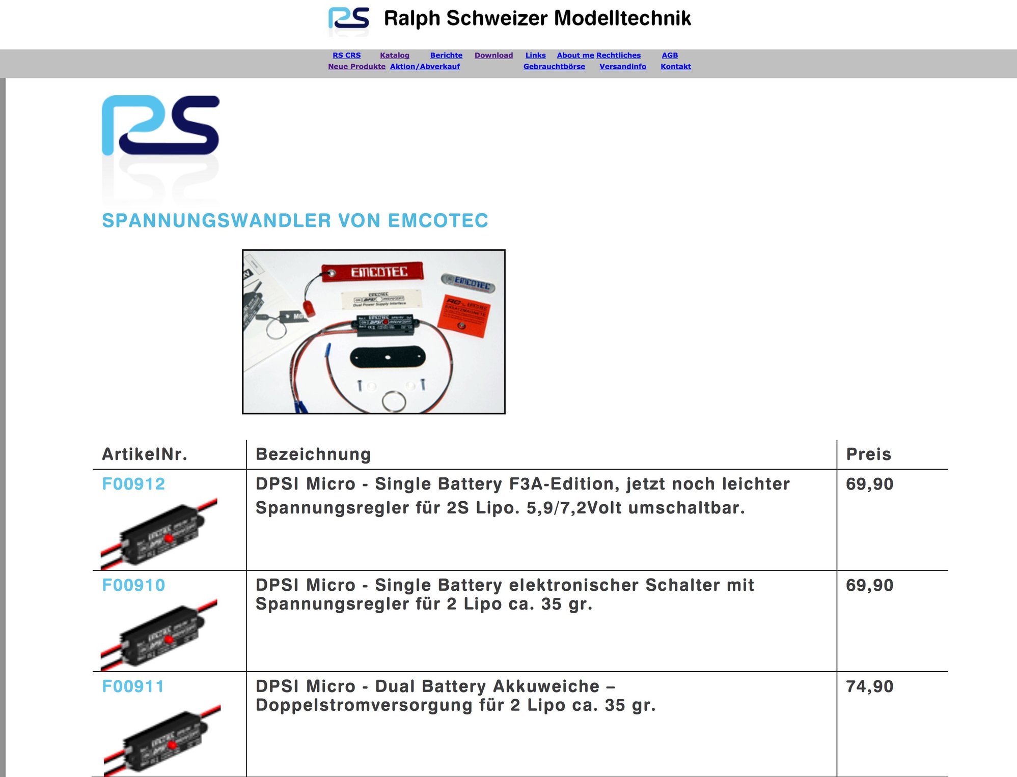

Hi,

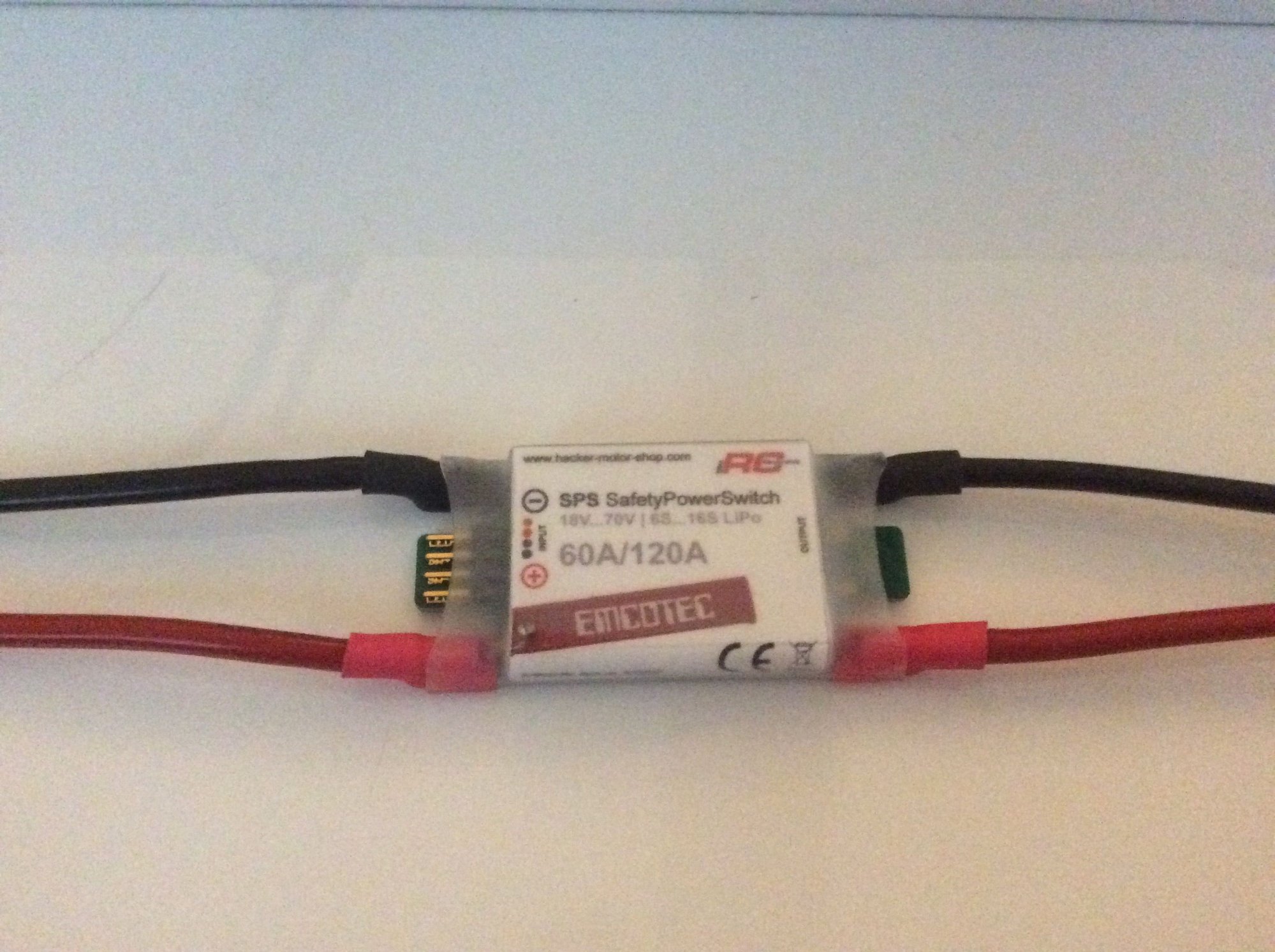

Is that 60A Emcotec arming switch large enough for the motor/prop combination?
Also, what is the heat sink device sitting up on the fuselage side under the canopy rail?
Thanks, I learn something every time I look at a new picture of your builds...
Old 10-29-2018, 11:50 PM
  #33
J-P
Join Date: Oct 2004
Location: Saint Nom , FRANCE
Posts: 329
Thanks for the comment Itc
We had no problems using this Emcotec arming switch after more than 200 flights.
What you ask for is an Emcotec DPSI Micro DualBat 5.9/7.2V dual power supply.
It exist too a DPSI Micro Single Bat 5.9/7.2V ( picture), a DPSI Micro DualBat 5.9/7.2V F3A Edition dual power supply and a DPSI Micro Single Bat 5.9/7.2V F3A Edition.
JP

Thank you for the information
I am a bit concerned at the 60A switch as I think it is only rated for 8s, not 10s, if Im looking at the right one
That would mean you are potentially exceeding MOSFET ratings .
I have always used Jeti DSM-10 or DSM-ESC; if I can get one here in the USA (if not just order it from RS), Id like to try the Emcotec unit for my receiver power in my next plane.
Old 10-30-2018, 05:00 AM
  #35
J-P
Join Date: Oct 2004
Posts: 329
Hi Itc
I think you don't look at the same product.
The one we are using is for 6 to 16 S .....70 Volts, and with a nominal 60 A and 120 max, it's enough for F3A.
JP
Old 10-30-2018, 05:41 AM
  #36
ltc
Join Date: Mar 2010
Location: Mendon, MA
Posts: 1,273
You're correct, I didn't know there were 2 60A versions; 8S and 16S
Thanks again

Does anyone know the recommended / starting balance point on the Fantasista? Using F3A Unlimited new alum removable battery tray and there is not much adjustment range after you get it installed.

185 mm from leading edge is a good starting point.

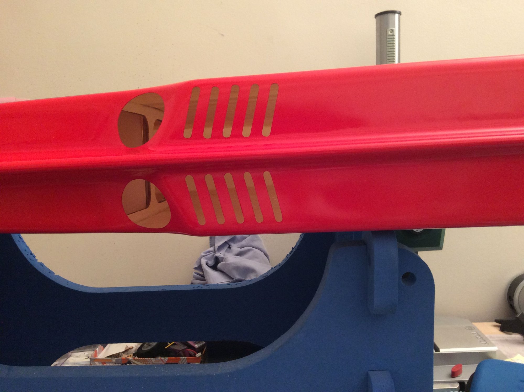

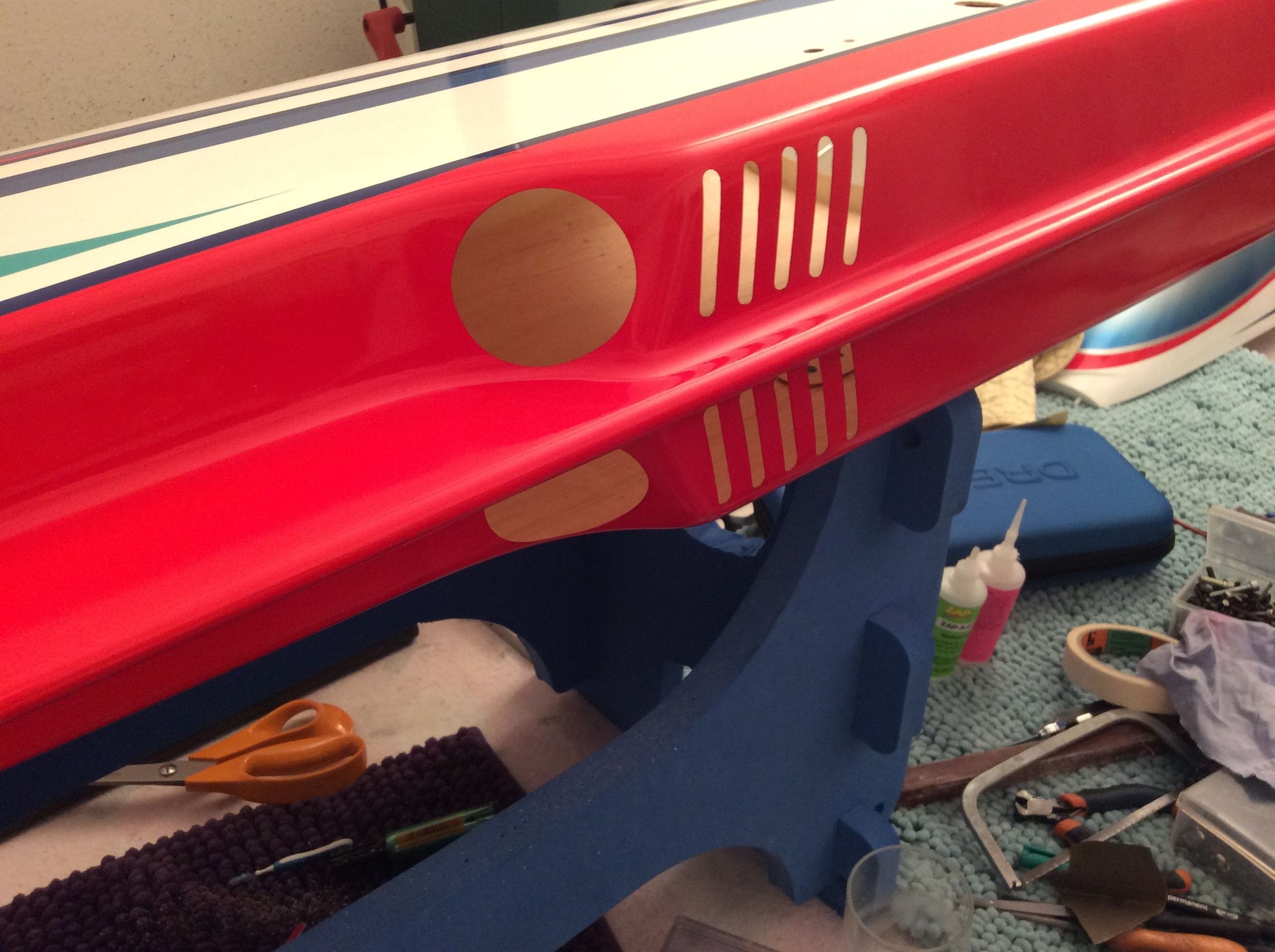

New air exhaust for the new SUPER FANTASISTA.

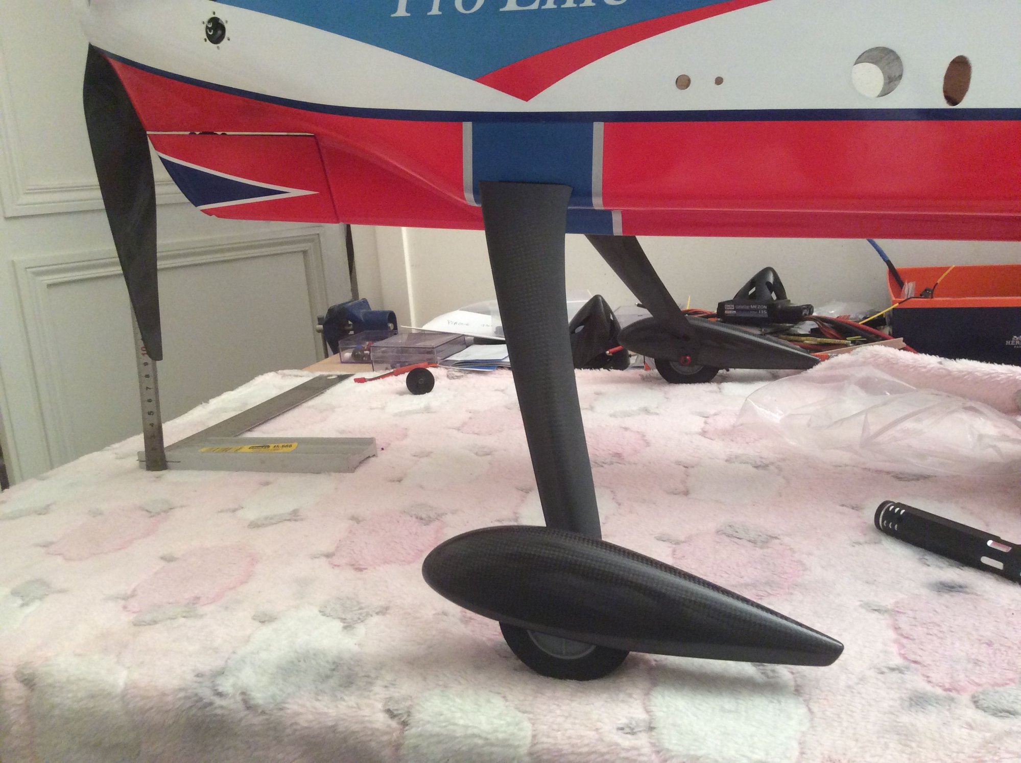

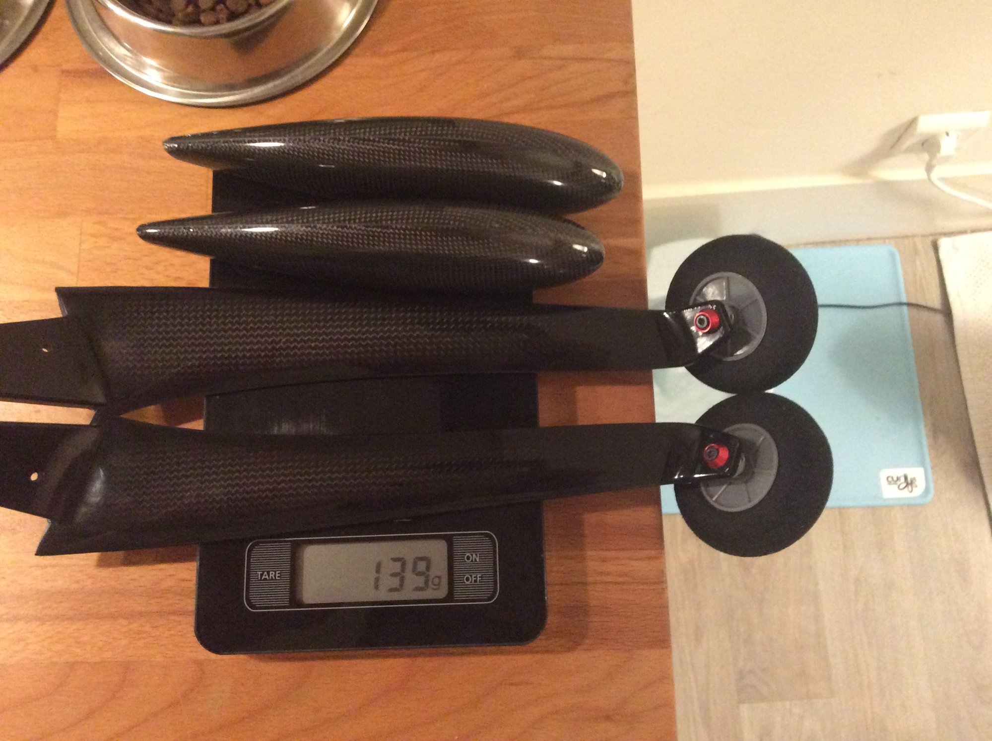

Second SUPER FANTASISTA have some upgrades ..
Falcon carbon gear and pants
New batteries tray arrangement ...

On this new SP FANTASISTA the stock landing gear has been replaced by a Falcon one.

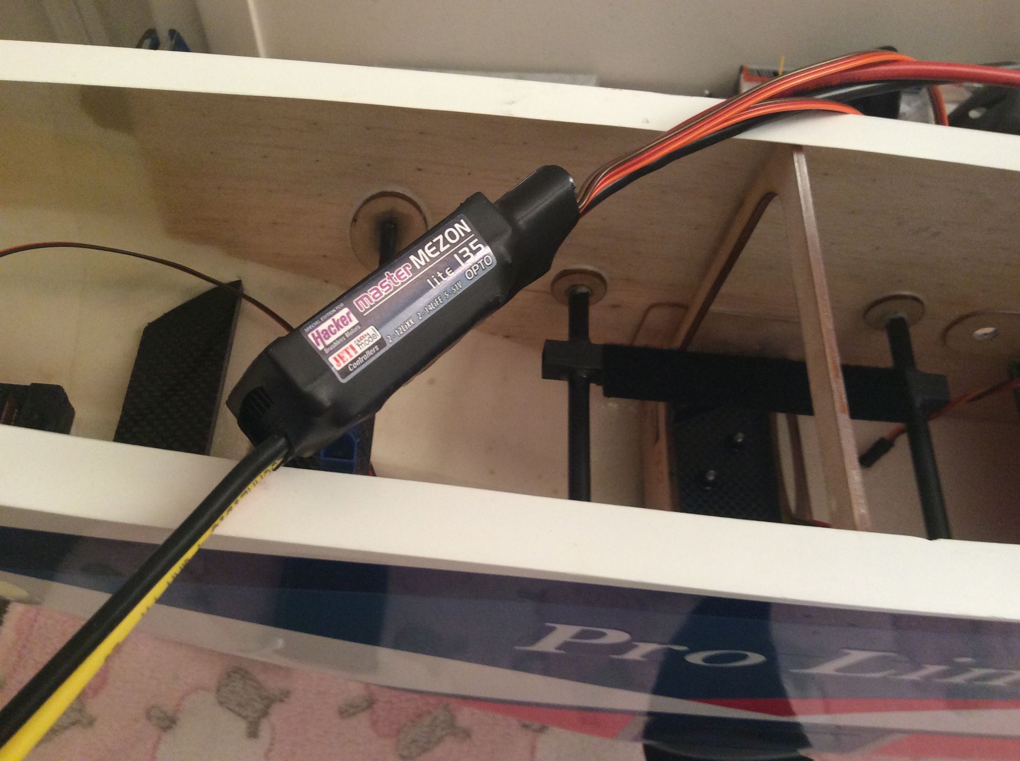

The prop installed is a 21, so no problem to go to a 22.
Following the recommendations, the 90 ESC has been replaced too by a 135.
Old 12-07-2018, 07:35 AM
  #44
wattsup
Join Date: Jan 2009
Location: Franklin, TN
Posts: 649
J-P, I see your new Jeti is an Opto 135. Very wise decision.

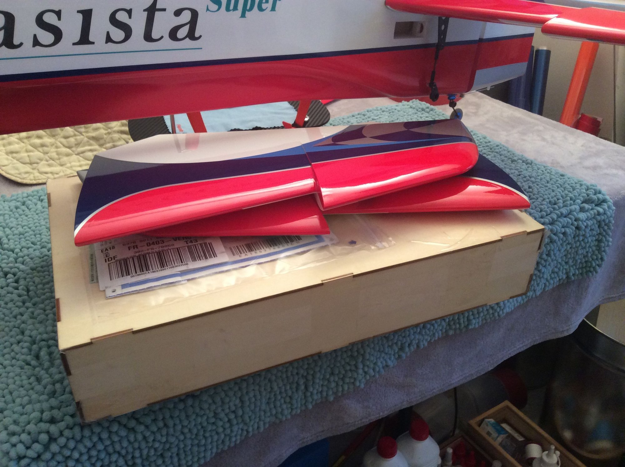

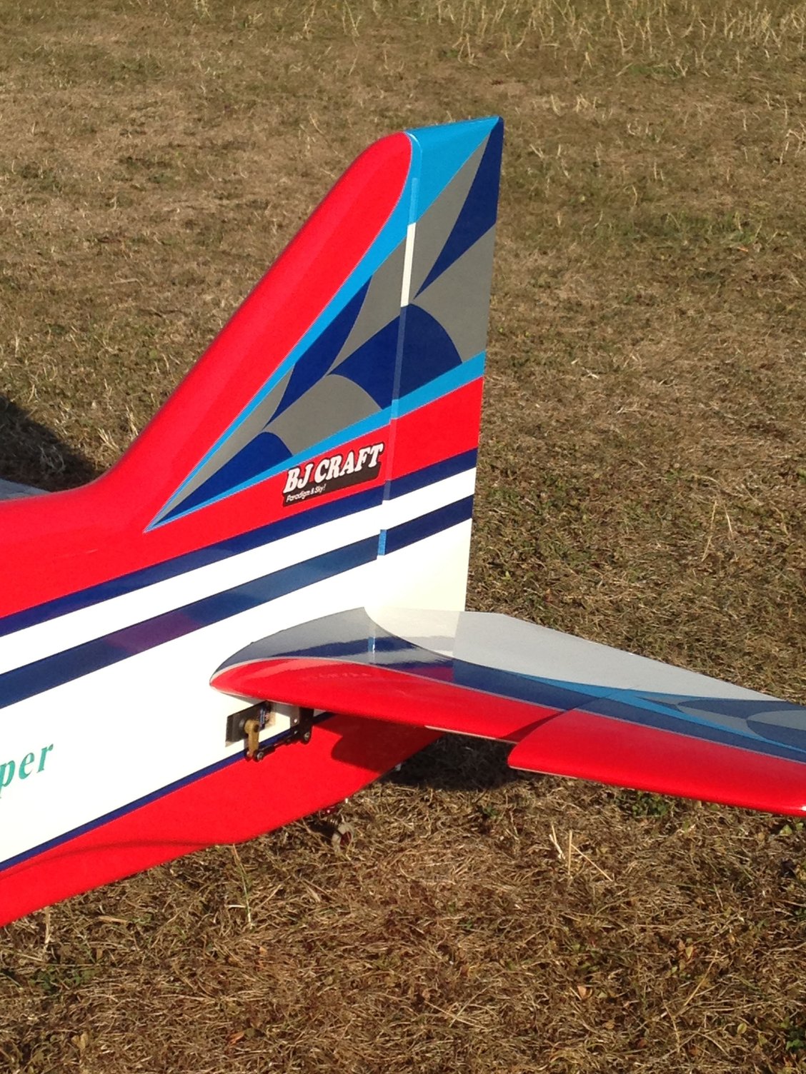

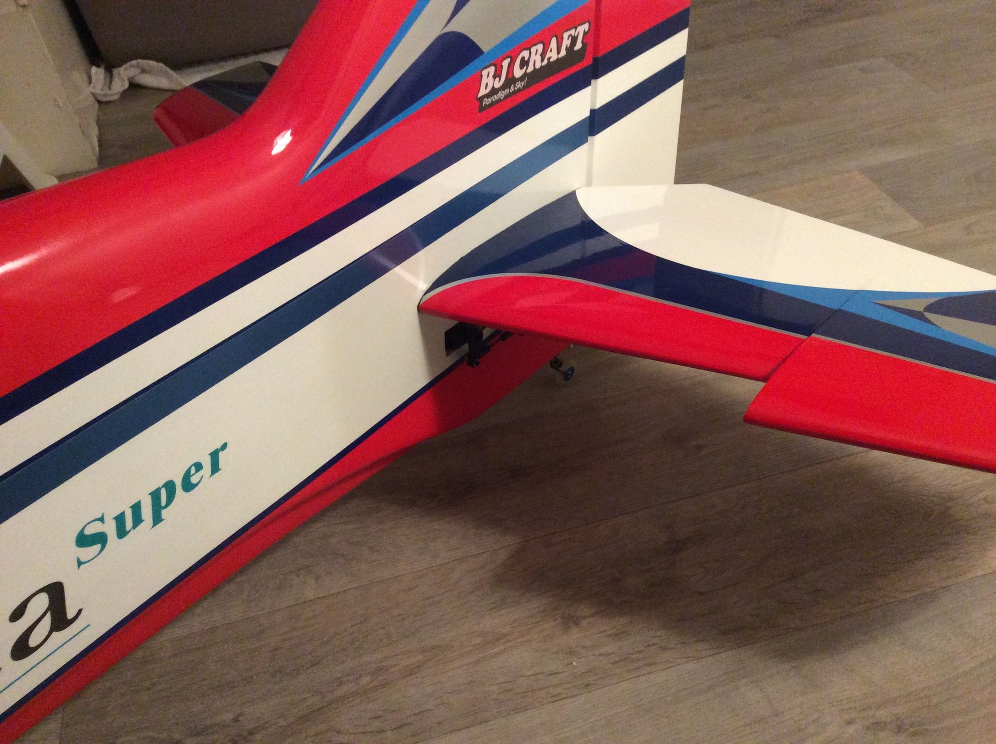

My buddy Fred had just completed his second SUPER FANTASISTA when he had an incident home, in France, and had half a stab badly damaged ....
5 days later, a nice wooden box arrived by EMS, with a full stab ....
Perfect packaging and service by B.J Craft
Fitting is perfect !!
THANK YOU B.J.
FRED & JP

Another new SUPER FANTASISTA ready to maiden in Paris ..
