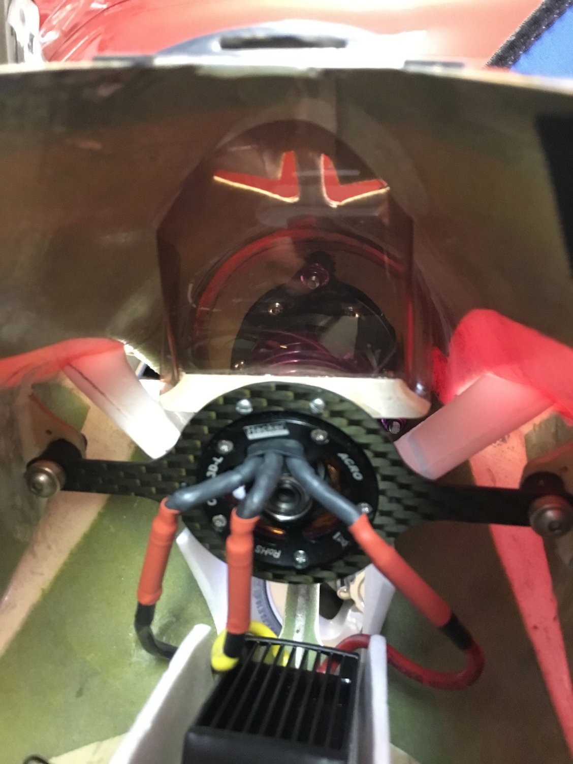

Hi,
I use Hacker Master Mezon 90 (with BEC) with Hacker Q80-14XS motor in my F3A plane since 3 seasons.
I read some days ago a safety warning that has its source from Hacker Motor, that is published at F3A Lorenz homepage in Germany.
I had one Mezon 90 stop to work in the air and it was toast and did not work after that incidence.
I have with the Mezon 90 I replaced it with several sudden stops when throttle was advanced during flight.
I think I need to change ESC for next season.
I have now read that Mezon 90 is not really suitable for our use in a 2M F3A plane.
Read below.
I also read a warning about Mezon Opto and third party receivers, I post that also below.
Just thought I would post it here to hopefully prevent any problem for people using any Mezon ESC described below in their F3A plane.
Translation is from German to English with Google translator, so myabe some not so correct translation but I think the most important info will be understood.
/Bo

Dear customers, there are still failures and fires of Master MEZON 90, Mezon 90 lite
and Mezon 95 opto controllers when used in F3A models.
The reason is as follows: These controls are all too small for use in an F3A model!
Reason:
1. Mezon controllers are constructed differently than e.g. Master SPIN controller.
Only a few power transistors are used in the MEZON's (only 6 in the MEZON 90!),
which have to carry the entire current load.
With the SPIN 99, for example, many smaller MosFets are installed, which are distributed
over a larger area on the heat sink.
The heat dissipation is thus much better, the controller has better "taker qualities".
A MEZON 90 is therefore not comparable to a SPIN 99.
2. The phase currents are significantly higher under load than the indicated current in the controller.
A regulator should therefore always be designed 20% -30% stronger.
3. MEZON lite controllers also have a smaller, flatter, heat sink than normal MEZON controllers.
To make matters worse, that this smaller heat sink is also covered all around by the shrink tube of the regulator.
4. A reduction in the regulator opening in the transmitter brings no improvement, on the contrary, the controller gets even hotter in operation, since it has to tackle constantly and never fully through can. Deadly in the summer for the regulator.
Please inform your customers about these things when buying. Our recommendation for F3A use is either a Master MEZON 130 as a BEC controller, or at least a Master MEZON 115 Opto, better a MEZON 135 Opto in the optocoupler version. With these stronger controllers, the Lite version is conceivable, if not optimal.
With our F3A recommendations in the Hacker shop you will find no indication of the small Master MEZON controllers.
The argument for higher weight or additional costs certainly does not apply. When weight difference we speak of about 10 gramm, at the cost of a few euros. If a controller that is too small burns down, the damage is even more costly.
Thanks for your support. With your help we can certainly reduce new failures in the F3A scene.

Hi,
Since I still have my Hacker Master Mezon 90 that burned up in 2016 I thought I might as well open it up and show what it is inside.
Enjoy
/Bo
Photo 1 and 2:
After taken the plastic label off the metal lid and then unscrew the 4 screws this is shown under the lid (no visable damage on this side of the curcuit board).
Photo 3:
On the other side of the curcuit board it is shown what has happened. Two FET's has burned and it is also shown black sot on the curcuit board. If I sniff with my nose on the black sot it still smell burnt. When this happened in 2016 it was in a flight flying a P17 manouvre, it was nr 3 Knife-Edge Combination with ¼ roll, roll, ¼ roll on about half throttle.
Photo 4:
Close details of the two burned FET's, more than half of the metal surface is burnt away.

Yep, cooling looks reasonable to me. Surprised you're seeing such high currents from the CRS/C54. Are you using the recommended props?
The maximum I've seen on my CRS is 73A peak or maximum and I don't use any limiting at all. The average current (throughout a flight) would be much less than this figure.
It would be interesting to know what your ESC temps are. I've not measured mine but it's limited to 100C which I believe is the default.
Regards,
Jason.

I use the Mezon 95 lite with Pletty in my Element and after 60 flights here in Greece with outside temps around 35-42 deg (summer) i don't have any problem..
I just fitted behind the air intake for best cooling results and after any flight i didn't measure over 55deg on the speed control.....
This combo works fine if you give your Mezon good cooling.... Also many top pilots fly with that combo...
Haris
Haris
