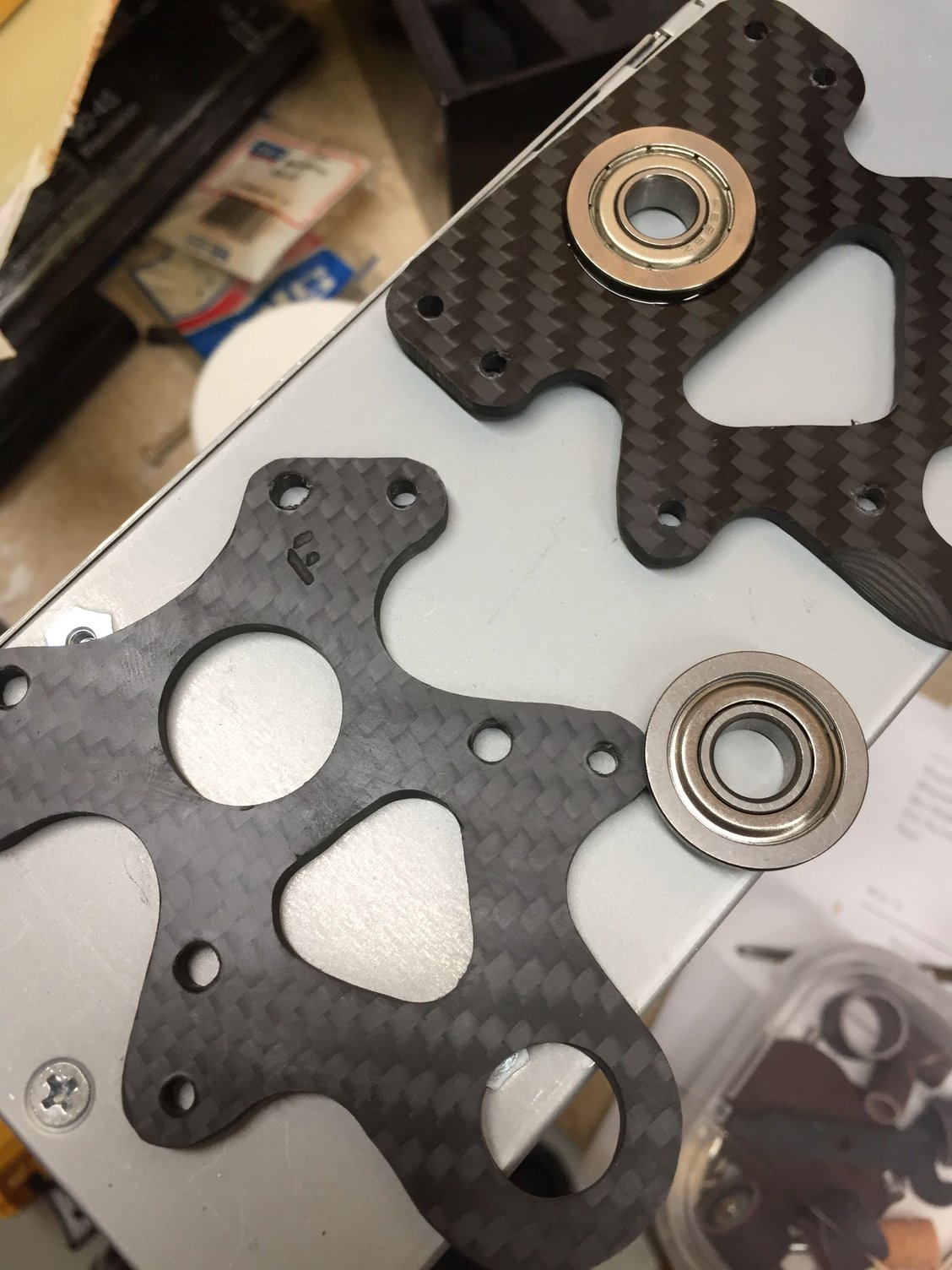

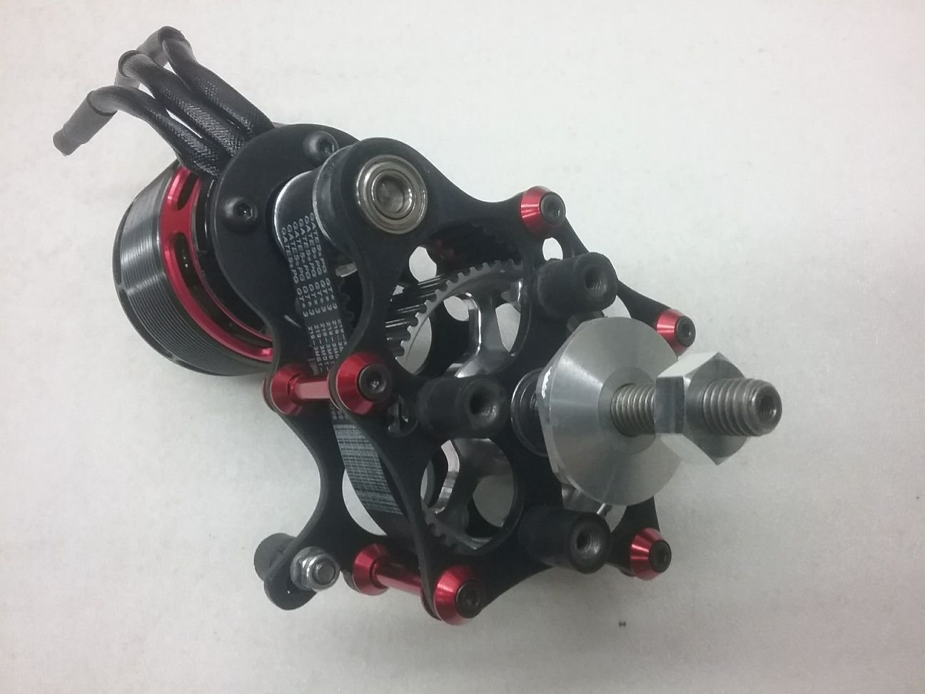

Hi,
Influenced by OS belt drive, contra systems and lately AR Single drive, I made my own for Sebart Miss Wind 50E:
At least as powerful as Hacker A50-16S but lighter. Runs very smooth and cooling is easy to arrange.
Shaft and prop fastening are spares from Hacker. Belt and larger tooth wheel are from ebay. Motor and smaller tooth wheel are helicopter components from 380 size (Goblin 380 etc.).
Design and cf plates are my own.

One more

Good job! How many grams? What prop are you turning? I was looking for an alternative to Hacker A50-16 but only found the 50 Products drive. Hard to justify the price on that one.

This drive was actually designed for 5S as I have plenty of those, half of 10S used in 2-meter planes.
Prop is APC-E 16x10, 16x12 is also possible.
Measured RPM in bench is a tad over 8000 1/min w. 16x10 with full pack.
Weight is 301 grams in configuration of the picture. Without prop drive (40 g), rubber insulators and back support it is 247 g. Bigger wheel could be made lighter but didn't bother, with this total weight.
I do not have actual weight of Hacker A50 but on web site it is stated to be 345 g. It is unclear whether that includes propdrive or not.
Starting point for all this was cooling. I used to have an AngelS 50E w. Hacker A50-14S. That was prone to overheating. A new slotted spinner could be the answer. Heat is also a symtom of lesser efficiency. My drive runs very cool indeed.
The above question of justification for all this is good. Why bother when the belt has friction and it becomes more complex?
The answer is in the nature of electrical motor, especially outrunner. A direct-drive motor has to be built heavy to provide enough torque and it still suffers when it is run at lower speeds with heavy load. A motor that runs faster works with significantly better efficiency and behaves better. This gives more benefit than is given away with belt. For me it is also an engineering challenge that is interesting. So, more power and longer flight times is the answer.
As an example a small RC heli Goblin Fireball has direct drive. The motor weighs 200 g. Similar sizes other helis use gearing and the typical motor weighs 70-80 g. Gearing is ~ 50 g or less.
I also have a bigger one in the works. Just wanted to test the concept with a smaller one first.

​​​​​In my tests I found that in sudden change of direction, the prop alignment tends to change as rubber isolators flex. Because of this I had to bring the back support further away from prop to keep alignment decent and to make plane more stable.
Also, I put the back support in the center so that the torque of the motor will be handled by front rubber isolators, not the the back ones. This is not a big issue but need to be considered when installing the drive in the plane. If you keep it like that the back support of the plane need to be strong and stiff enough to cope with vertical forces induced.

One benefit in this concept is that if you end up in situation where you want/need to change kV or behaviour of the drive, it is possible to change gearing. Normally you just change smaller tooth wheel and cf plates and the rest is kept as is.
There are more choices available than with current outrunners (+Plettenberg).
BTW, this is very silent. You can only hear the prop.
