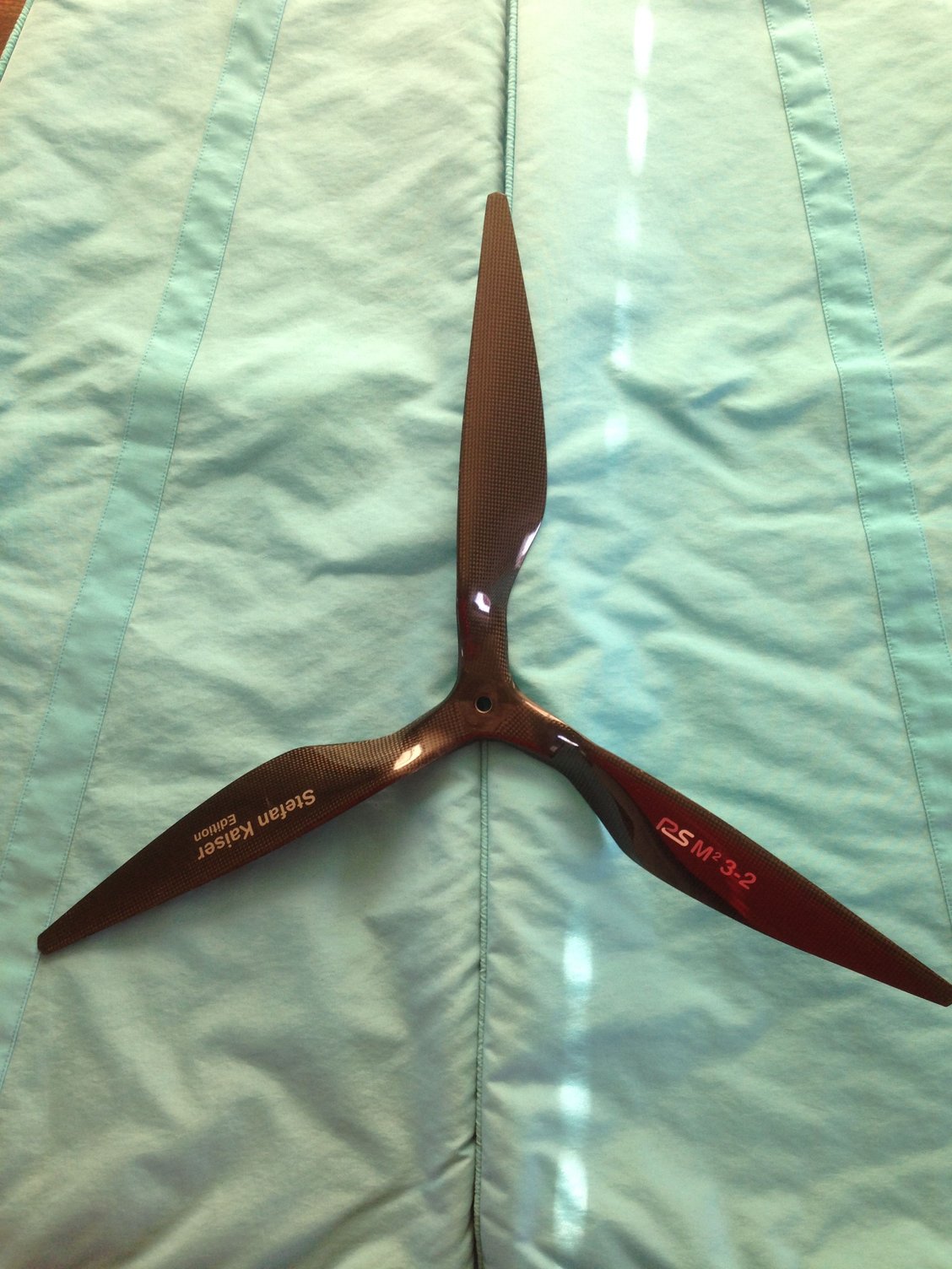

I have been flying 3 years with the OS Belt drive engine, and for the last year now with the Adverrun Single Drive installed on different planes :
- ACURACY mono
- IMMORTAL bipe
- ZEBEC bipe
- SUPER PASSION bipe
trying different two blades props :
- RALPH SCHWEIZER 21 X 14
- FALCON 21 X 14
- FALCON 21,5 X 13
- MEJZLIK 21 X 14 EL
- NURILA 22 X 12
- APC 22 X 13
- CK AERO 21,5 13
and the RS M2 3-2 triblades.

The ADVERRUN Single Drive turned it at 6200 rpm , I increased the brake % to 70 on the FUTABA ESC, and the average mah for 9 mn 30 s flight from T/O to start of approach and landing was 4400 , flying with THUNDER POWER 6000 mah.

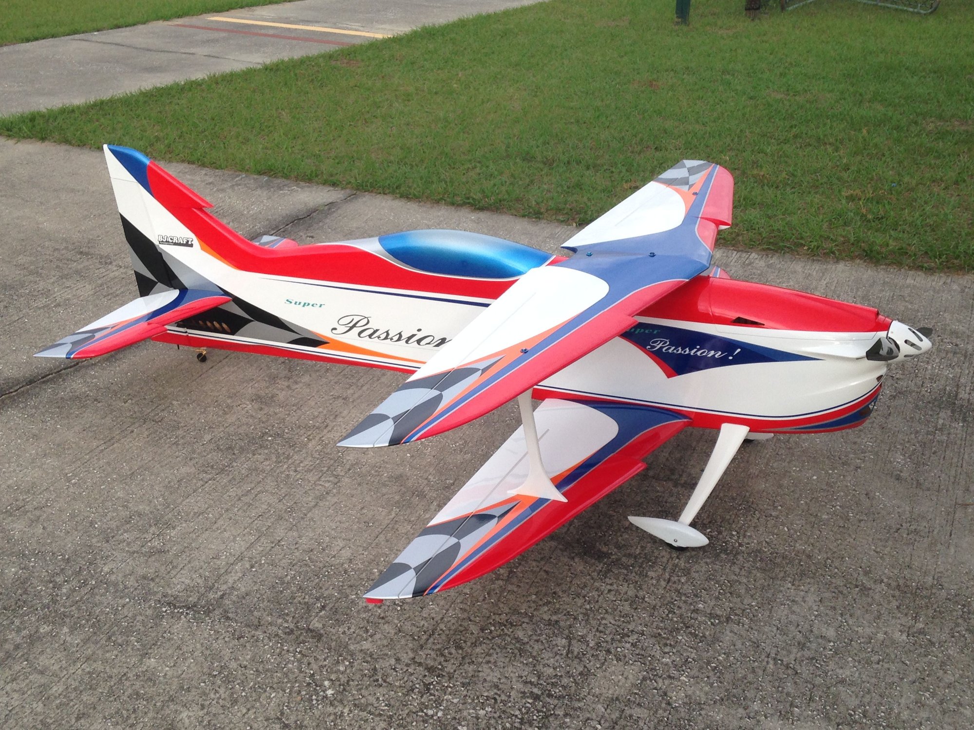

A couple of questions when you have a moment.
Did you originally have the OS motor installed before the Leomotion? Is it a version 1 or 2 OS belt drive unit? Did you notice any improvement or changes with the Leomotion?
How do you like flying the Super Passion? I have the original Passion biplane from Akiba (BJCraft) and was looking at the Super Passion or perhaps the Accel if I ever get a chance to buy one.
(I like biplanes!)

About the Super Passion ...the more I fly it, the more I like it.
The plane was designed for a contra and produced at a low price for people wishing give a try to the contra system told me AKIBA.
I decided to test it with the ADVERRUN Single Drive.
The plane is draggy and you need power, specially in crosswind days.
Fly really nice and close in on a no wind conditions, but can be flown fast too.
The ACCEL look nice, saw it flying in Italy, but it's a kit to build, and I don't know if a ready to fly model could be ship overseas.
