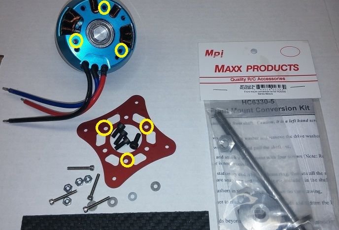

Need help to install front mount on himax
hc 63 i have conversion kits for motor
But can't figure out how the front support is attached.

Hi Mike,
I'm not sure which support is that, but have you seen this thread? It has detailed steps for the conversion process:
Himax 6330 motor front mount conversion kit
I hope this helps.

The Himax hole pattern is a little strange, because it was designed as an easy replacement for Plettenberg. It has the holes for conventional X mounts with 4 holes and also the 3 holes pattern used on the Plettenberg.
I don't use this front mount , but i think you need to use these 3 holes for the Himax:
