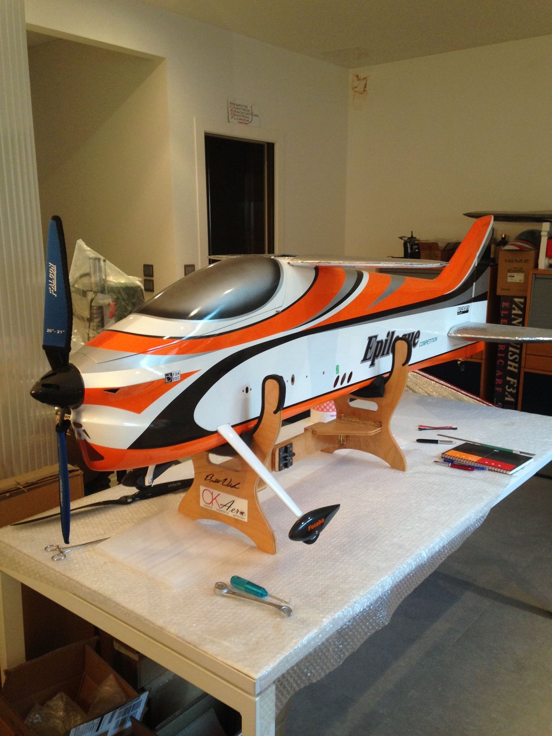

T-canalyser installation
A small shim on the right side of the fuselage is needed to have the T square
I did it with Bob Violett Poly Ply
Next is the stabilizer setting
There is no incidence adjusters
Both elevators are accurately set to operate parallel with BRYAN HEBERT magic tools
Then throws are set and checked with an Aero perfect digital

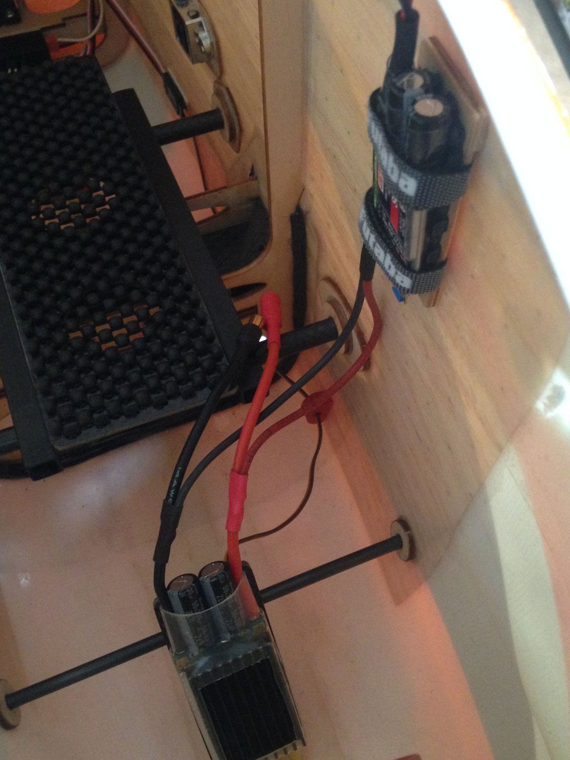

Battery tray
In order to be able to fly with 5000 mah THUNDER POWER packs or 6000 mah on a windy day, I determined accurately where to position the battery tray to achieve the recommended 230 mm to 260 mm from the leading edge CG
The 10 mm square carbon is drilled for the 8 mm carbon tube.
The bottom frame touch the landing gear box
The D3 ESC is mounted with velcro on a small balsa carbon tray.
Positioning the D3 in front of the air intake is very important according to Adam DEBOWSKI to have a good ventilation, specially on a hot day

Hi JP,
Just wanted to as hew effective the cooling for the D3 ESC is in that location?
Keith
Old 03-01-2021, 01:45 AM
  #35
Malcolm H
Malcolm H's Avatar
Join Date: Oct 2002
Location: glasgow, UNITED KINGDOM
Posts: 709
Received 7 Likes on 6 Posts
Hi JP,
Like Keith I'm wondering if your cooling will be sufficient? I have always mounted the D3s right up close to the chin inlet below the motor. A colleague had a failure even with the ESC mounted there until he opened up the air outlet holes.
Malcolm

Received 28 Likes on 18 Posts
I installed a D3 in the same way on 6 different planes
ACURACY MONO
IMMORTAL
ZEBEC BIPE
ADVANTAGE BIPE
OREKA
and now EPILOGUE
The ESC is barely warm after a 8 mn flight, even on a 28°C day
The ESC is positioned directly in front of the air intake.
The Exhaust air is roughly 3 times the air intake.
I had ZERO problem with this ESC.
