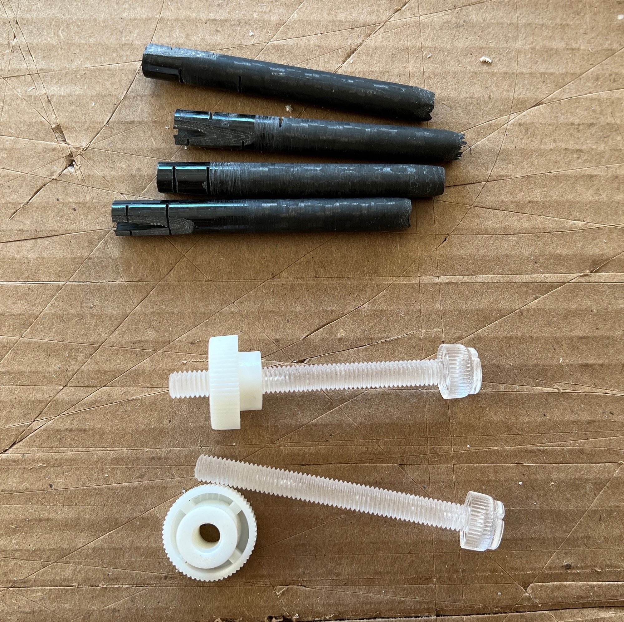

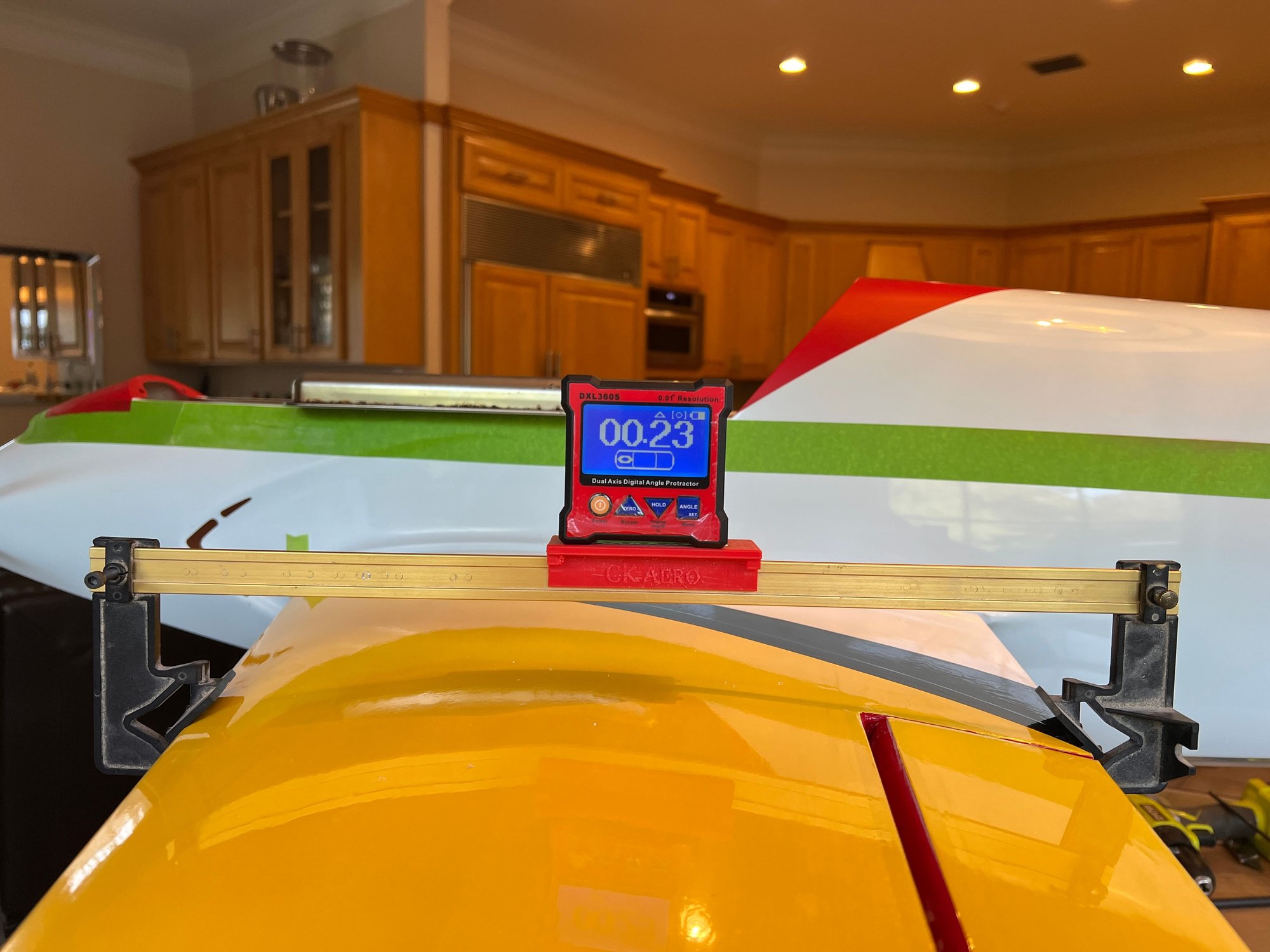

Default Setting the wing incidence
Preface:
Setting incidence on a small airplane like this, that is so light weight, is not easy. ANd luckily, plan from get go was to install the wing adjusters.
SO my goal was to install the pins as close to possible to o degrees.
so this is what I did
Had my friend come over and assist me. He held while I advanced the drill bit.
The materials I used:
I obtained these nylon bolts, that are M6 mm threads. And the kit came with the white thumb-bolt.
Then I obtained carbon fiber tube that has an 8 mm outer diameter. The CF tube 8 mm OD is for the anti-rotation pins. These will go in the forward and rear aspect of the wing root.
The nylon bolt will go just rear to the wing tube. To glue in the Nylon bolt, after drilling into in, then I will tap the plywood with M6 tap, and then glue in the clear nylon bolt and then cut off the head.
So, next step was to have my assistant hold the wing from the other side. The fuselage was held on a table by supporting the fuselage and not on the landing gear, and then assuring the hatch area was level to ZERO.
then, the incidence meter placed on the wing, while he held the wing on ZERO, as best we could, i then drilled all 3 holes, using long drill bits, from the holes on the fuselage side.

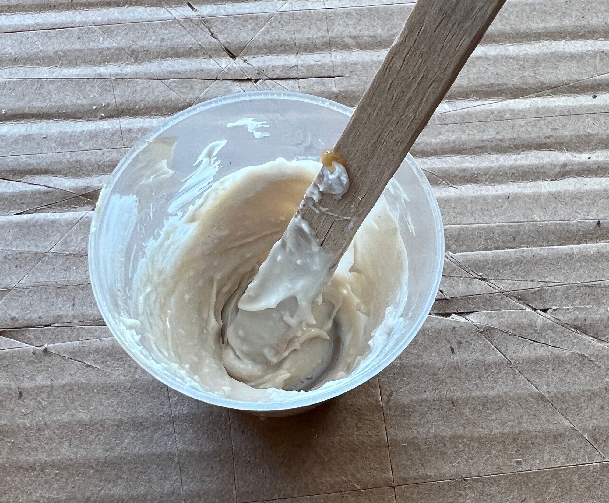

once all the holes were made, I then glued in the pins and the clear nylon M6 threads using HYSOL:
root of wing after drilling all the holes.
HYSOL glue
Mixed the Hysol with some milled fiberglass
HYSOL
after mixing in the milled fiberglass
Once all the pins and threads were glued and installed.

wing adjusters installed.:
I still have to glue in the short carbon fiber tubes, that have an ID of 8 mm, so that the pins enter those to be held in place.
Will do that soon, later today,

first, to show you all I got.
the motor is 12S. this is the V4 contra Drive.
there is more that came with it.
SO then, it looks like there is 4 cm space between the back of the spinner plate and the front mount of the motor.
In order for me to be able to even see how to install this, I had to do some disassembly:
once I removed the front cones, then I removed all 6 screws.
Now, I can fit the motor in from the rear and get a better Idea of what i have to do.
