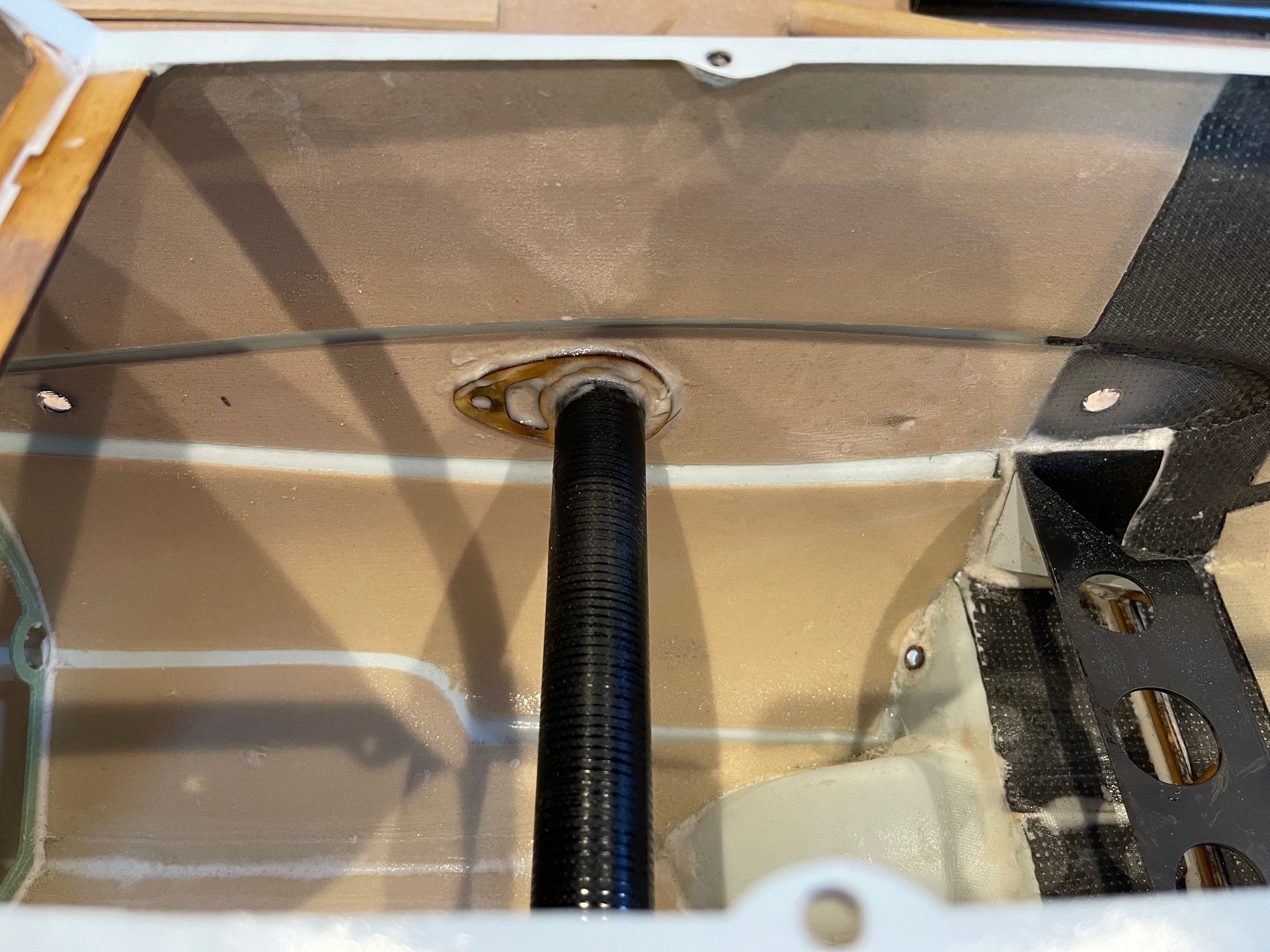

I did the cut outs in the fuselage sides for the wing tube phenolic:
cut out hole for wing tube phenolic
then I used a 7/8" wood dowel, and wrapped the end with sand paper, and then i rounded out the hole:
making hole round
i genlty went back and forth, until I was able to get the phenolic in there, with a tight fit. I will also check that the wing tube goes in smoothly before I commit to glueing it in.
test of the fit
this is the inside look. NOT doing the glue fixation yet. Still have to make measurements. The ply doubler is not installed yet either.
I will do that once I am happy with the measurements.
inside view
now, the next step, is to make measurements and assure the wing tube is aligned and in line with the stab tube in two planes.
I will use a laser light also.
Once I am happy that the wing tube is parallel to the stab tube from the rear view and also by making measurements, then I will glue it in.

My original measurements reveals the wing tube was lower on the right side. SO with very little sanding of the fuselage side on the top of the right hole and bottom of the left hole, it is perfectly parallel to the stab tube and perfectly perpendicular to the vertical axis of the fin / tail end of the fuselage.
tail end. the stab tube is perpendicular to the trailing edge of the fin.
It is apparent, the wing tube is not. Right side lower than the left side.
the right side. take note of the lower black line on the 90 degree plastic triangle.
On the right side, the wing tube does not line up with the left side. it is lower.

i did a test fitting of the wings on the fusleage, and noticed, the wing roots were not flush with the fusleage sides
SO i then did more measurements, I then adjusted the fuselage holes for the wing tube, slowly and carefully and frequently doing repeat measurements til i was pretty much square. then I glued in the phenolic tube into the fuselage.
I used 30 minute epoxy with the milled fiberglass, and again, went back and forth, to make sure the tube was square on in the two planes, parallel to the stab tube, and from the top view, looking down on the fuselage.
this is after sandind it down and flush.
