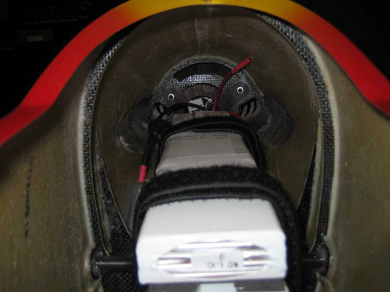

Malcolm,
thanks for that reply - always good to hear from you! Unlike you I would rather turn the plane over and then only undo one screw! I have gone ahead with fitting the batteries into the pipe tunnel, I made a frame to support the front, with the rear of the batteries sitting on the floor of the pipe tunnel - see the picture. Two velcro straps hold them in place, with a velcro patch between the packs and under them, to stop them all from sliding relative to each other as you suggested.
Once I have my motor sorted (see my other post) I'll be good to go!
James

James,
My big concern with your installation from the pic is that you don't appear to have much airflow gap round the packs. I would worry that the rear cells will not get as much cooling as the front ones and thinking about this further even the front ones will not get proper cooling unless the air can get out somewhere. I think you need to open up the hole that the batteries pass through to allow the air to flow through.
Hope this helps
Malcolm
