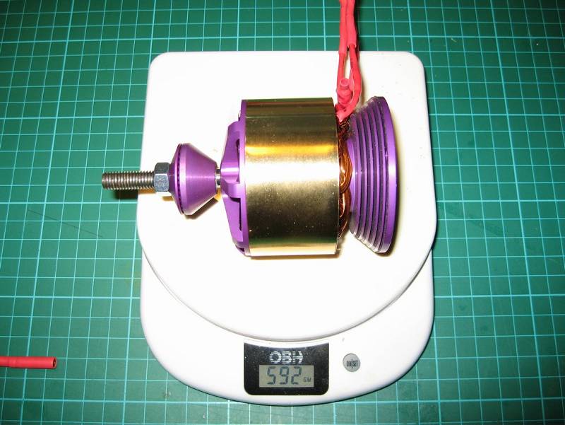

Joined: Mar 2004
Posts: 498
From: Moss, NORWAY
These prices and weights were easily pulled off of various websites.
Please note that this weight is misleading, as it does not include the prop driver, washer and nut. (But you wouln't fly without them.) Add approx. 30 grams for these items. Even the Competition version is more than 550 grams including these items.
Magne

Morten, is that first pic a cyclone?
Also, with the pletty, can you run a jeti 90 instead of a schulze?
Great info.
Chris
Great info.
Chris
Posts: 242
From: Henne, DENMARK
Yes, the first pic is of a Cyclone. I think they have changed the design a little since then (this motor was purchased in 2005). I also think there should be no problem in using the Jeti with a Plettenberg, however I strongly recommend that you get a controller with a proportional brake for F3A use. The new Spin series from Jeti offers this with their Spin programming box (0-80% braking), also the Hacker/Jeti Master Competition with the competition programming box (0-50% braking) offers the same.
