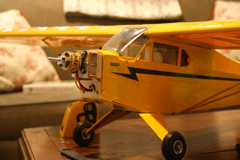

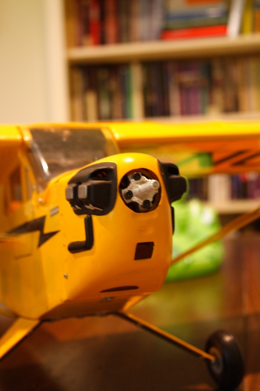

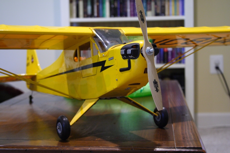

Old 09-07-2007, 01:37 PM
Geardaddys
Join Date: Aug 2006
Location: Ellicott City, MD
Posts: 339
Default RE: GP Elictric Cub Motor choice ?
I'm getting 12 minute flights so far, but I've calculated that 15 minutes with 20 percent reserve should be no problem.. Using a 10.5 wood prop (APC would probably work better, but you just need a wood prop for a cub!).. As far as the motor mount goes, I had to make one from light ply. I ordered the Great Planes Medium mount and it was too big for the cowling no matter what I did with it.. I'll take some happy snaps this evening and post for you.. Overall very pleased with this setup plenty of torque that's for sure.. I put a little more moto than it needed but that's because I want to put floats on it at some point.. Also I think that your wt. is a bit high.. I'll weigh mine this evening also with battery.. I don't think that it's more than 3 pounds ready to fly..
Old 09-07-2007, 02:17 PM
Geardaddys
Join Date: Aug 2006
Posts: 339
Bob,
Here are some photos of how I have the motor installed.. Also the plane is 2lbs 13oz.. That's with a Hitec Park flyer type receiver which I've had very good luck with and a TP 3cell 2100MAH pro-lite battery.. Let me know if you have any more questions.. Glad to help..
John..

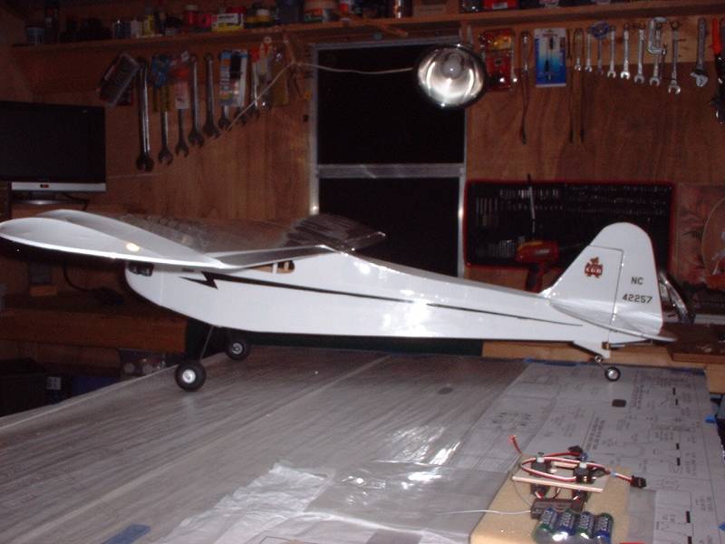

Old 11-06-2007, 07:03 PM
dignlivn
Join Date: Oct 2005
Location: Deland, FL
Posts: 1,993
Update pics.
Bob

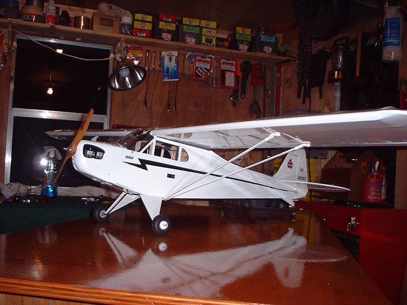

Old 12-08-2007, 08:33 PM
dignlivn
Join Date: Oct 2005
Posts: 1,993
Just an update pic,
Bob
Old 12-29-2007, 08:19 PM
dignlivn
Join Date: Oct 2005
Posts: 1,993
Hey guys, thanks for your help. I still have the lipo's
and new balancer & charger to get. Then balance her.
Bob
dignlivn
Old 02-29-2008, 12:41 AM
Geardaddys
Join Date: Aug 2006
Posts: 339
DignLivn,
Wow.. looks GREAT! Plane turned out fantastic.. I like the standoffs that you used to mount the motor with.. Sorry I didn't see this earlier or I would have taken some more measurements.. Have you flown it yet? Also, I was reading what I wrote a while back regarding flight times and I'm not pretty convinced that I can get at LEAST 20 minute flights with the 2100mAh battery.. Anyway, hope you are feeling better and can get some flying in!
GD
Old 03-01-2008, 08:30 AM
dignlivn
Join Date: Oct 2005
Posts: 1,993
GD
Thanks for your help, those stand offs came from lowes btw. I have
not flown her yet, matter of fact I just got a 4s lipo for my Electristar
and I think it is to big for the Cub. I'll re-research a lipo for the Cub.
The weather here is typical Feb. and now March weather Windy and
cold. I still need a couple of props for the Cub. The one in the pic is
23 years old 10x6 left from my earlier days in the hobby. I did get
a T.P. 610c charger, trying to learn that too (lousy instuction sheet).
