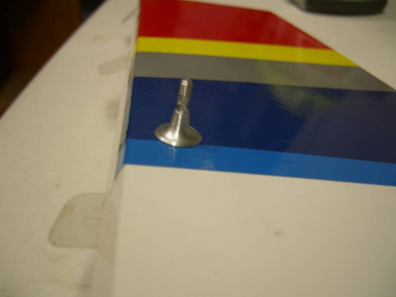

Now I installed the rudder horns. I had some short Mk horns sitting here, so I used them. The hole in the rudder was larger than any bolt I wanted to put in (weight saving mode) so I put in the Mk's. I did this by finding a bolt that fits the horns, cutting it to length.. Then I found a carbon rod that was the perfect size to fit the bolt in (inside diameter), the I drilled out the hard point to the (outside diameter) carbon rod. I then ca'd the carbon rod in. Then installed the bolt (again with ca) and put the horns on.
Old 09-18-2008, 11:45 PM
patternflyer1
My Feedback: (11)
patternflyer1's Avatar
Join Date: Jul 2003
Location: Tracy, CA
Posts: 2,080
Default RE: Fliton Element 170 ARF build
Finished horn

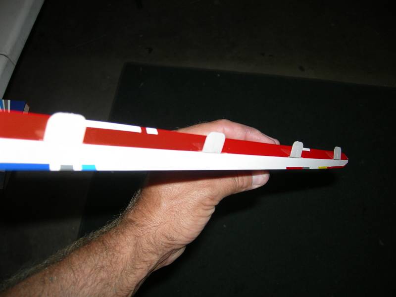

Ok so next, I took and put the elevators and rudder on with the ca hinges that are pre hinged.
I always take and bend my ca hinges in half several times so that they already have a natural bend to them. It also helps keep the hinge in the right position when pushing the rudder on.
So when I go to install ca hinges, I cut a small amount of covering away from the pre cut opening. Then I obviously bend them all, then I insert ca into all of the holes on (one surface) the elevator (or rudder) (fairly quickly I may add), then I push in each of the four hinges into the hole to the bend point, then I push the control surface into the appropriate stab, and gap it. Then I finish the ca process on the whole hinge. Usually a couple of drops per side per hinge.
Make sure to keep a clean dry terry towel available (or paper towel) in case you have a ca run. Obviously try not to let this happen.
ID:	1035962   Click image for larger version
ID:	1035963   Click image for larger version
ID:	1035964   Click image for larger version

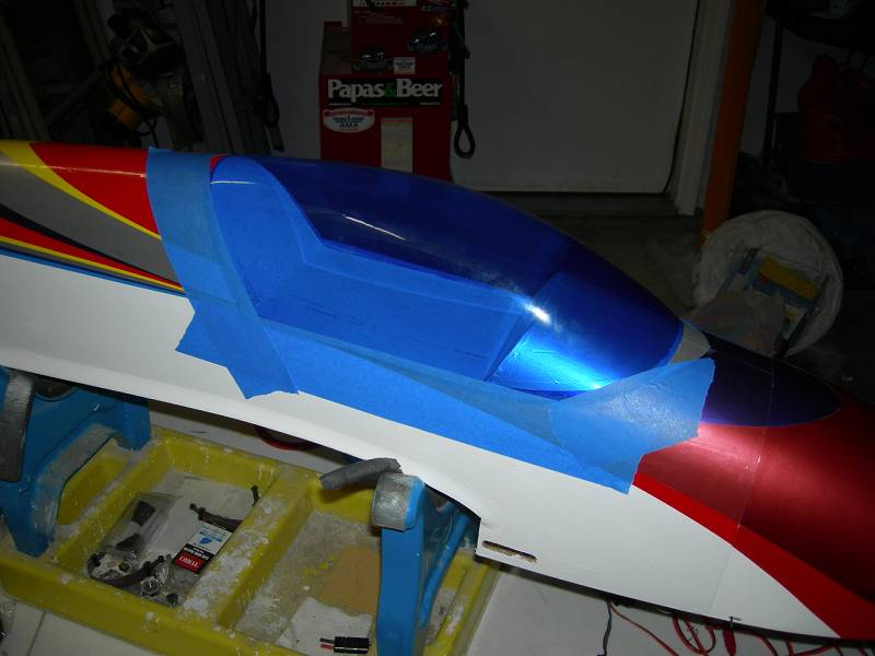

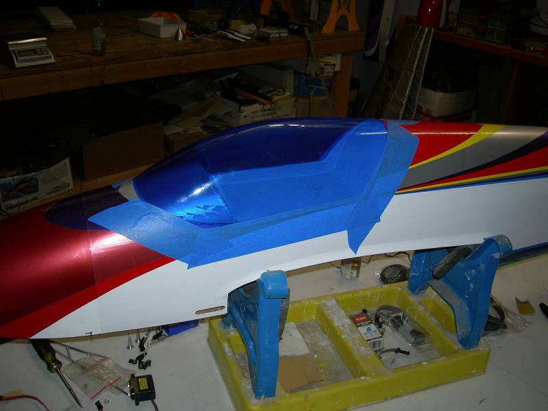

Then I painted my canopy Candy Blue, trimmed it to the size that I wanted (it does come pre cut already though) , and glued it on using canopy glue. Not sure I like the Candy Blue on the Element yet, need to see it outside. Although, I guess it's too late. lol
Edit: Oh, btw, before I glue any canopy over monokote, I ALWAYS run an iron over the area. That way it doesn't bubble up under the canopy. I also do this before I glue on the control surfaces. It is an ARF after all.
ID:	1035966   Click image for larger version
ID:	1035967   Click image for larger version

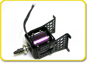

Tianci,
Here is the A60 mount. Has a rear support also.
Sold here http://www.espritmodel.com/index.asp...OD&ProdID=4646
ID:	1036108   Click image for larger version
