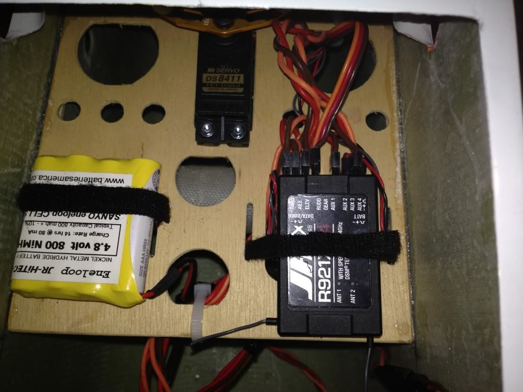

Simple redundant pwr. Battery + BEC.
Join Date: Oct 2005
Location: pound ridge,
NY
Posts: 608
I brought this up a few months ago and there were lots of ideas and concerns. Today was a rainy day with some free time so I did some experimenting with parts I had on hand. I put the setup shown below together on the bench with a rx and 6 servos. Amazingly, I found it did exactly what I have been wanting and I've had these parts at home all along. The key being both the BEC and the regulator were designed to be run in parallel with another BEC/regulator so by simply off-setting the voltage between the BEC and the regulator by .1 volts it caused the higher set BEC to be primary while the secondary regulated Lipo unit never showed any current draw until I unplugged the BEC's battery pack to simulate a failure. Even though I wasn't able to simulate a draw large enough on the bench to overwhelm the BEC, the regulated Lipo should kick in the moment the BEC falls below 5.9 volts if it is over taxed, so that means this setup is good for 5 amps even though the BEC is only rated to 2.5 amps, but as the vast majority of F3A work is done at a draw much less than 2 amps this should rarely happen and never meaningfully drain the battery. Obviously there is no internal monitor for the backup battery, so one should check the voltage before each flight. I have already put this in my Delro and will be sure to give an ongoing report during the coming season. I have several servo current sensors that I intend to put in series with the BEC and the regulator so I can keep track of what's going on for the first several dozen flights. The best part is that with a 250 mAh battery rated for 10 amps this setup weighs 49g which is less than the weight of most rx batteries+regulator setups in use today, and no the BEC can not charge the Lipo as Ed's regulator design is top notch and includes a blocking diode so current doesn't flow backwards through the regulator.
To copy this setup you'll need:
[link=http://www.dimensionengineering.com/VHVBEC.htm]Dimension Engineering VHVBEC[/link]
[link=http://www.tech-aero.net/plr5-e]Tech-Aero PLR5-E[/link]
[link=http://www.hobby-lobby.com/pro_lite_v2_2_cell_250_mah_7.4v_20c_lipoly_w_jst_c onnector_323357_prd1.htm]250 mAh 7.4 volt Thunder Power Pro Lite V2[/link]
Cheers!
Joe

Joe, I’m a bit surprised you’ve had no replies on this post. I think what you’re discussing here is extremely interesting. Even if one were to keep their existing power setup and use the VHVBEC as a backup source at 5 volts it’s a good insurance policy for only 17 grams (0.6 oz). I’ve recently been thinking I should consider using a backup battery again (I stopped due to weight limitations when going electric), this is an excellent solution.
Assuming your assumption is incorrect about the 2.4 amp draw, you are correct that the small battery should take the load for the spike (not sure if trying to overload the BEC will cause damage). I look forward to you testing this and showing amp draw under load.
However, if anyone is uncomfortable with this then another .4 ounces can get you the CC BEC Pro that will go to 20 amps!
Keep up the creative thinking and let us know what the amp load testing shows.

Keith,
I'm a little surprised myself, as I would think a redundant power supply for the rx plus the ability to eliminate the need for rx battery recharging would be attracting a lot more interest, but none the less, I am excited to get this out and fly tomorrow. Been rainy last couple of days so lots of tinkering in the basement, but no flying yet. Also of some minor interest, prior to making this change my plane weighed exactly 3720g (minus main batteries, but with the rx battery installed) and now with a BEC and a 250 mAh rx battery the plane weighs 3721g. Go figure!
Its not like I'm worried about weight in this plane so actually I'm thinking of taking this setup one step further by paralleling two BECs as extra-extra insurance. If I join their outputs through a y connection into the same rx power input, I'll have 5 amps of power on both the primary and the secondary power source plus if one BEC failed the second should be capable of handling the job all by its lonesome. I'd really love to find a small electrical board and put it all on that so I could make it "look" tidy. Guess I'll have to do some Radio Shack shopping

Joe, I think I will use the CC pro and a Tech-Aero on the next install. I have the CC program link and Ed's programming box so I am set to go.
Here is my plan for my next plane. All high voltage servos. Tap the low end 5S at the 3S pin on the balance connector and feed it to a Jaccio Perfect Switch Harness/regulator set to 8.2 volts. This is connected to the receiver. Connect a small 2S LiPo directly to the receiver through a conventional switch that allows current to flow in both directions. The system essentially runs off the motor power pack. This also keeps the small LiPo charged to 8.2 volts. The small LiPo, in addition to being a backup also serves as a large capacitor to keep the voltage constant. What do you think?
Jim O

Bob, I have thought of doing similar dual BEC setups. However, I note on the description page of Castle Creations for the BEC/BEC Pro they have the following warning:
NOTE: CC BEC Pro should never be operated in series or parallel with another BEC or backup receiver pack connected to the RX/Servo side of the circuit.
Any idea what the real-life limitations are for dual switching BECs or a switching BEC with battery backup?

Jim, I think you know far more than I do, so I will just stick with the tried-and-true dual regs and Rx batteries.[&o]
Sometimes I know just enough to get myself into trouble.
Don, I had not seen that warning from CC. Thanks.
