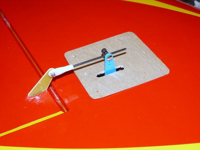

Regarding aileron servos I was almost decided to get Futabas 9551s but then due to current lack of funding, I decided to try to fit DS821s I already had so that it not only works properly but also looks nice. As you may remember DS821 does not fit nicely in the wing but sticks out of the wing more than I can tolerate.
That required some "exacto-knife and glue" work on both wings, and I was lucky to have a friend and scale master builder Mirce to help me fix it.
We removed planking between the two ribs, just beside the original hole and glued couple of hard-wood sticks as a support for the cover holding the new mount for the servo.
The rest of what we did is simple, couple of wood blocks glued to the cover, servo screwed into the blocks and servo arm sticking nicely out of the wing.
I think pictures will descibe it better than my English :-)
Note that this is not a finished "product", I'm going to put some carbon fiber-like sticker over the cover and screw it in the wing like that.
Now that should look cool I think!

Join Date: Jan 2004
Location: Orange County,

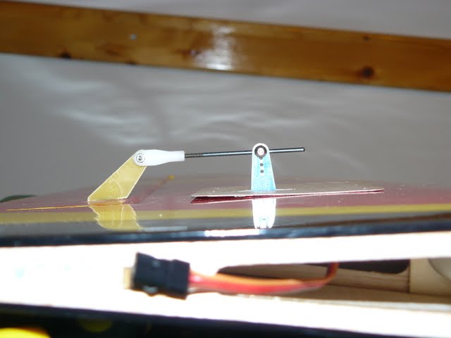

Just measured my throws. Keep in mind I only had a 5 minute flight with a warped aileron so it wanted to roll to the right. I have both the ailerons and elevators at 8 degrees. OR, looking at the radio settings, I have the end points at 100% and on low rates I have 25% with 40% expo. I only use high rates for the stall turn and I'll probably set them at 75% with 40% expo, but I try not to use the elevator and aileron in the manuver.
As far as rudder, it's at 60% low rates for snap rolls, and 75% high rates for stall turn.
Hope to fly again Friday, I'll post results after that if you are interested. Your results may vary.

That is great info. So 8° each way on elevator and aileron. Your picture looks just like my plane! I went down the hobby shop this morning and bought a packet of Dubro ball joints and 2-56 all thread. I couldn't bring myself to use the supplied hardware. Also some of the supplied ball joint were very tight. Generally a good squeeze in a vice, or pliers, will free them up. The squeeze deforms the plastic a bit. I am a lot happier with the double ended ball joints. Did you also fit a Sullivan tail wheel? I plan to,

A quick observation. You are betting the life of your aircraft that the knurl screw holding the Aileron linkage to the servo arm is not going to vibrate loose! I know electrics don't vibrate as bad as Glow but my 50 + year experience says sooner or later it will come loose!!
