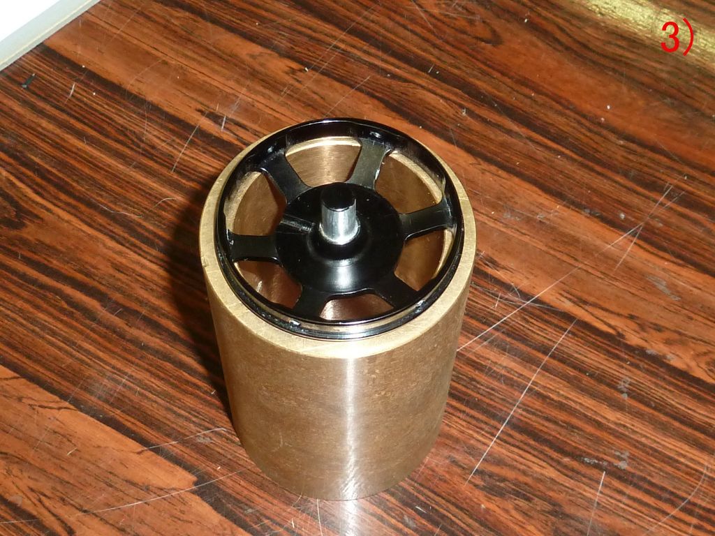

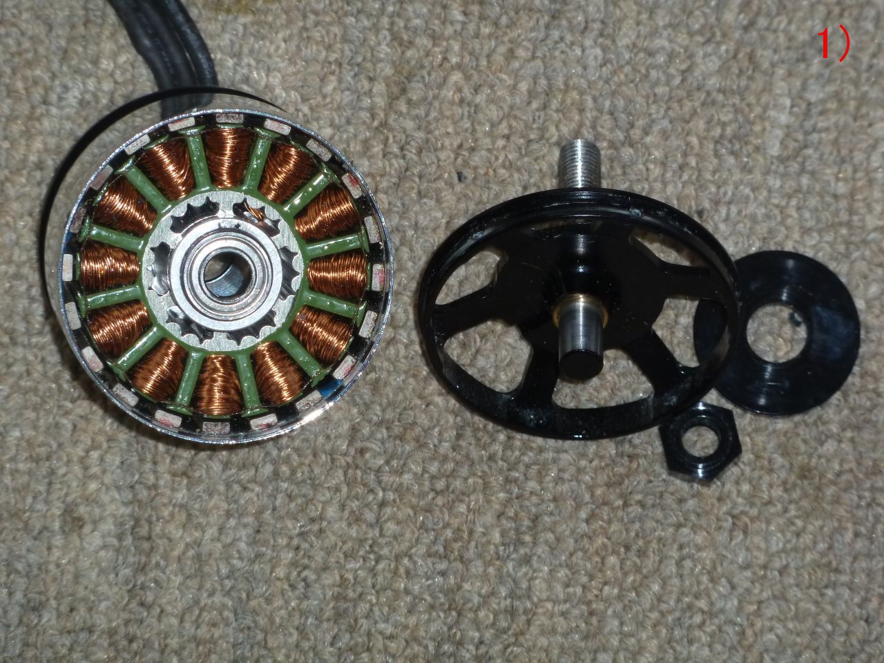

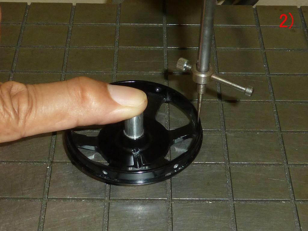

3 Attachment(s)
Hi ken
I also have the same experience as Ken.
In my case, a cause of the deflection of a main shaft was distortion of a bell.
It is three photos and explains my repair method very briefly.
1) Disassemble a motor and separate a bell.
2) Measure distortion of a bell with an easy measuring instrument.
3) The bell was put on the cylindrical 冶 implement, and distortion was struck and corrected with the hammer etc.
http://www.rcuniverse.com/forum/atta...mentid=2031280http://www.rcuniverse.com/forum/atta...mentid=2031281http://www.rcuniverse.com/forum/atta...mentid=2031282
kobago
