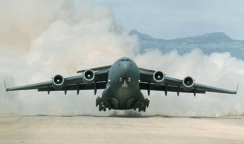

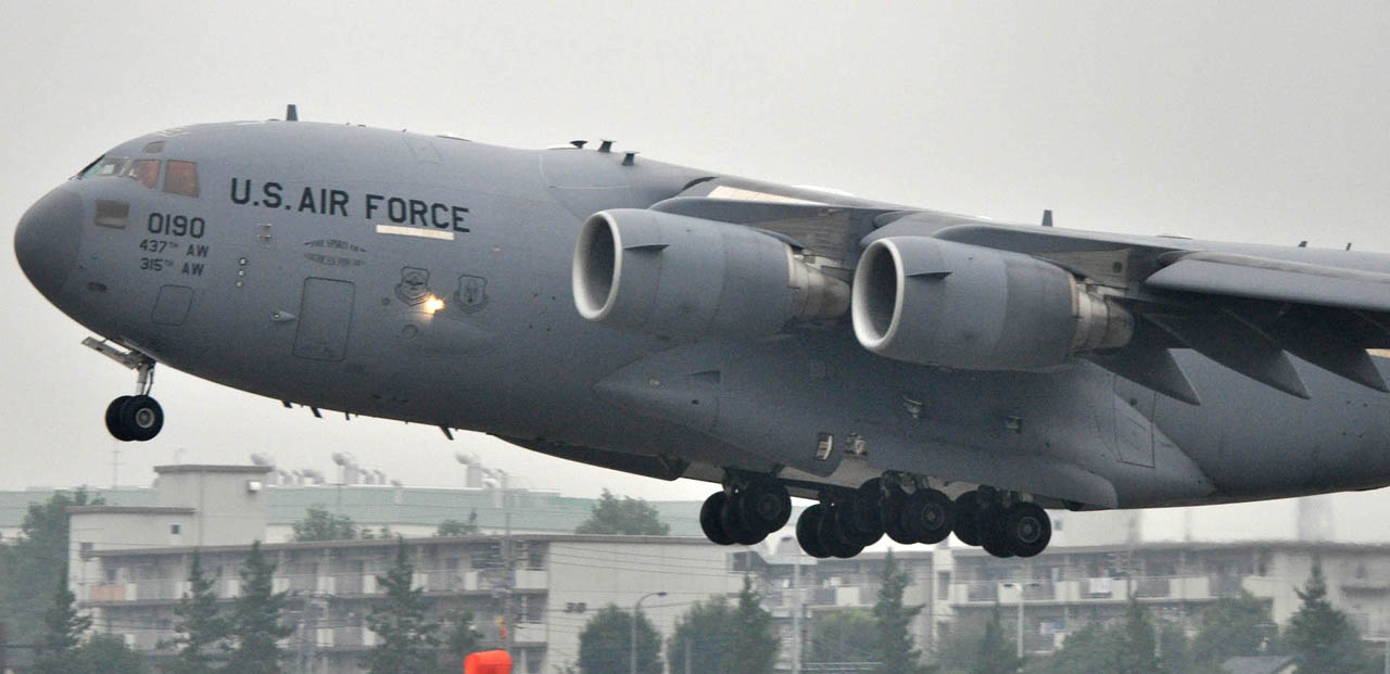

mithrandir 10-31-2013 03:08 PM
2 Attachment(s)
Originally Posted by gaRCfield (Post 11651541)
This is interesting to read.
Cool huh??
and at high speed.. they align with the local flow...so no big drag penalty!
http://www.rcuniverse.com/forum/atta...mentid=1935423
http://www.rcuniverse.com/forum/atta...mentid=1935424
http://yokotajoho.cocolog-nifty.com/...101004h868.jpg
http://www.fas.org/man/dod-101/sys/ac/c-17.jpg
