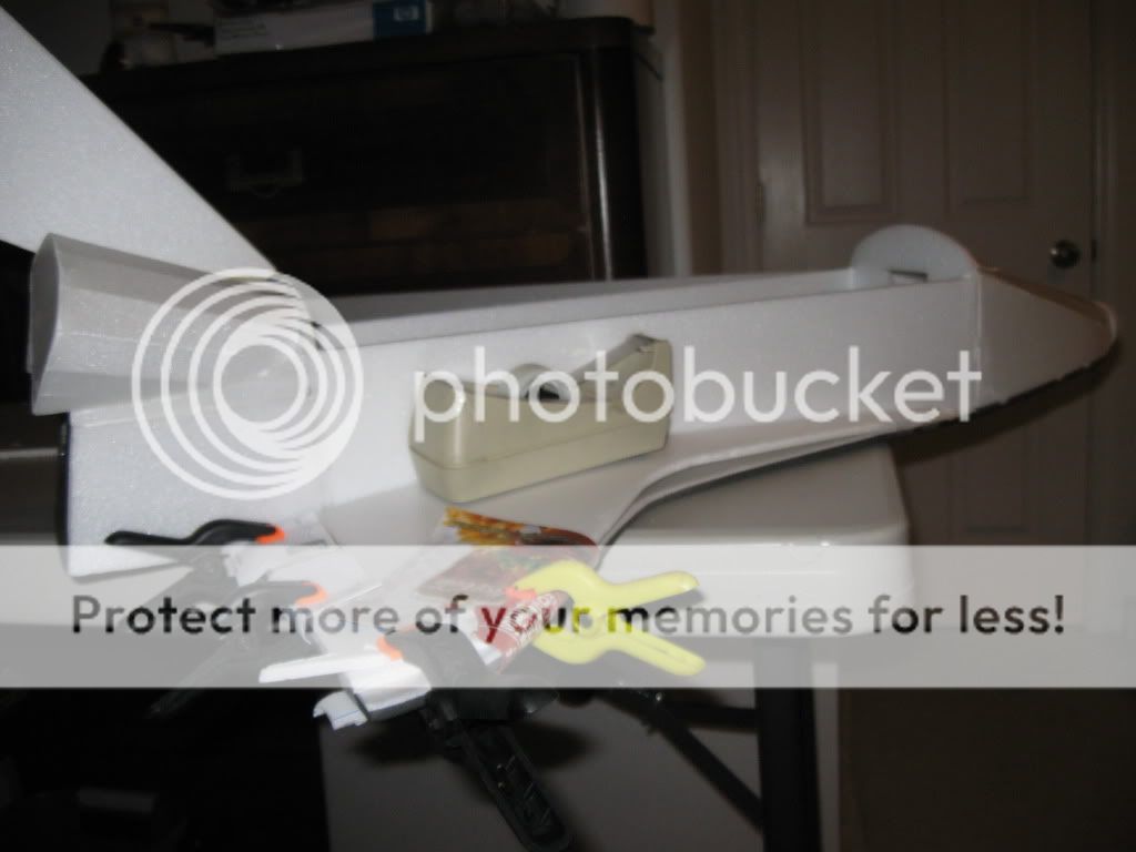

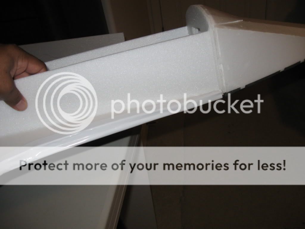

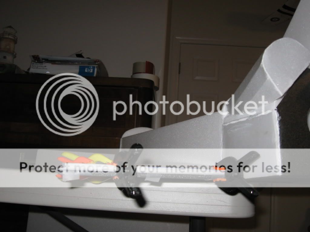

Hi Guys!
Today, I was not feeling 100% so, I stayed home and right about late in the afternoon all rested and energized I went right into the Space Shuttle Project.
First, I took out my notes from what I disucssed with Mark (co-worker, real pilot and Flight Crew Engineer Member) about the Airfoil top location, slope and other technical data about Wing Airfoil.
For a scale off of 26 inch wing span the top (highest point) should be a little more than one (1) inch but, I really did not want to create too much drag so, I decided to use no more than 3/4 of an inch as the highest point where the top wing assemblies would rest and this highest point is a few inches behind the Center of Gravity mark.
Okay, here is a few pictures showing the progress and I am happy to announce that it is looking like the Space Shuttle.
Cutting out the Top Wing Panel:
Panel Weigh-In:
Stand-Off foam Airfoil former at the Root location:
Top Left Wing being glued down:
Top Right Wing Panel Being Glued down:

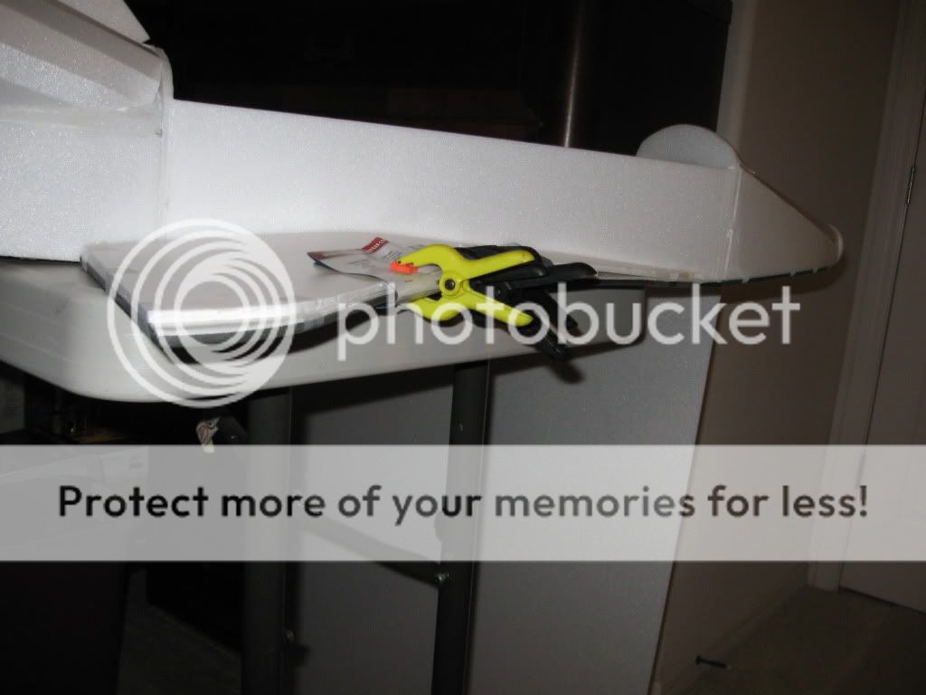

Hi there again guys!
Could not sleep so, went back to finish the leading edge gap openings on both wings using left over 5mm foam board material.
Some 5-minute epoxy and then, a little sanding is all that was needed.
Of course, I plan to use some ORACAL 561 intermediate Adhesive Film to dress up the entire leading edge of wings.
As usual, some more pictures.
Leading edge wing piece:
After a little Sanding:
Right Wing Leading Edge being glued in:

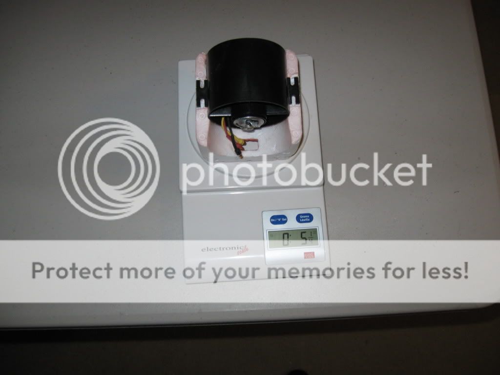

I did have time tonight to tinker with two EDF's. One is from Freewing, 64mm EDF with Motor and the other is from StarMax, 70m EDF with motor.
I am posting the weigh-in differences of both and feel that the 70mm is a better deal for the additional of 1 oz. more not withstanding the Foam cage on the 70mm from StarMax.
I did notice that the Freewing EDF unit housing is somewhat flimsy and the blades do make contact when you hold the housing. Also, the StarMax 70mm EDF came with a 50-AMP ESC and with an external BEC.
Here is the FreeWing 64mm:
Here is the StarMax 70mm:

This is the EDF I will be using on my final version of the Shuttle
Description:
- Outside Diameter: 67mm
- Rotor Diameter: 64mm 5 Blade- Material: ABS & Special Aluminum
- Weight: 176g (Whole Unit With Motor)
- Motor: 28mm Inrunner Brushless Motor , 4,300KV ( Include & Installed )
- MAX RPM: 49,000 - 52,000 rpm
- Max Power: 750W
- Battery Required: 11.1v - 14.8V 1,800 - 2500mAh
Static Thrust:
11.1v Around 950g ( 37A ) , ESC Timing Mode : High Position
14.8v Around 1,200g ( 48A ) , ESC Timing Mode : Middle Position
