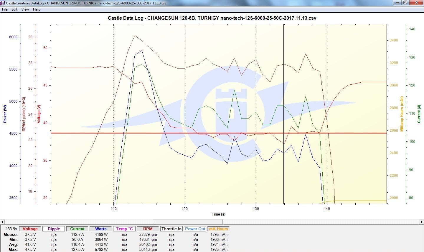

I used 2 types of accumulators during the CHANGESUN Ø 120mm 6 blades 12S test.
I started the test with 12S TURNIGY nano-tech 6000mAh 25-50C.
At higher rpm the EDF pulsed.My friend’s opinion is that the discharge rate(25-50C) is not enough for this test.I tested the EDF twice and got the same result.
Then I tested this EDF with an old 12S ZIPPY 5000mAh 45C. During these tests there weren’t pulses.I tested the EDF at 50N.
If somebody has opinion on pulsing of the EDF, please write me(us)!
