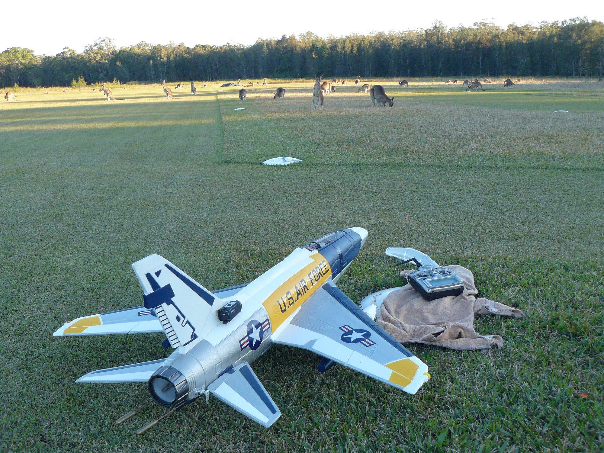

She is really something on full blast at 50 volts.
In action.
I still enjoy my 10 pounder on 12S.

My favored color scheme.
Simple/solid LG to handle the extra weight off the grass.
So nose heavy with 12S, aft balance was a must.
Enlarged extra intake with mesh.
Flying with the wild life.
Quote, - WOW! SHE sure lools Great! Could you Please send/post some more pictures....... Up Closer and of the back, bottom, gear,/Retracts.
TX, it is one of my favored color scheme, very attractive color combo and easy to see, I based on my 2nd. IC DF jet I built many years ago before getting into turbines. (Saber pic.)
On 6S set up, at least you can keep it very light for fun flying, I build some of my EDF foamies purposely heavy with 12S upgrades as a trainers to fly some of my heavy jet turbines and some seriously heavy and large EDFs.
With this Hunk ranging 4.45 to 4.7 kg I get 3.5-3.7 kg static pull on level ground but when holding vertically in hands it just about hold its own weight, meaning it really frees up dynamically especially in the air flying.
Originally I fitted DSR, E-retracts but for my grass fields they were useless so I redesign my own made up fixed gear for reliable service. I fly my jets a lot off the beach sand where salt&sand creates problems after long use so with fixed gear there's no issue. If you have luxus of proper sealed strips go for any decent size retracts that can handle 3+ kg models.

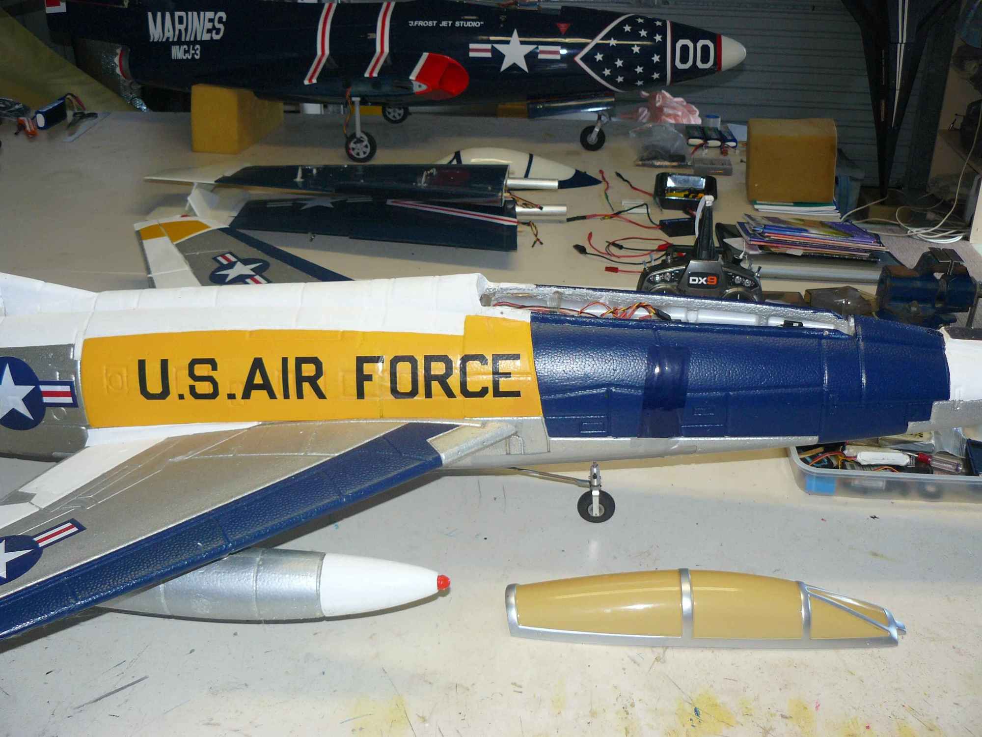

Setting it up.
My favored sand pit.
Adding few more flights to my log book, 385 to date in the last 8 years, not bad result for a foamy. Yesty flying it off my rugged grass strip, today off the beach sand, tho little marginal for comfort.

Hi Body, I run 12S power set up, Wemotec fan on 1100kv motor off 120ESC. 4 to 4.5Ah I fit in in tandom, very tight fit for the larger capacity. Extra 5cell batt. for receiver. I use my own design short fix landing gear to handle the grass strips I fly off.
Unfortunately there are no retracts on this planet that can handle reliably models of this caliber to fly off the goat tracks like my field. I love flying it off my beaches but conditions don't always prevail when I feel like it.
My maiden flight was with plastic cased DSR retracts that ripped off the first landing on the wet grass strip, the second flight was using simple fixed gear that holds so well to date just short of 400, 3-4 min. flying sessions, Cheers.
