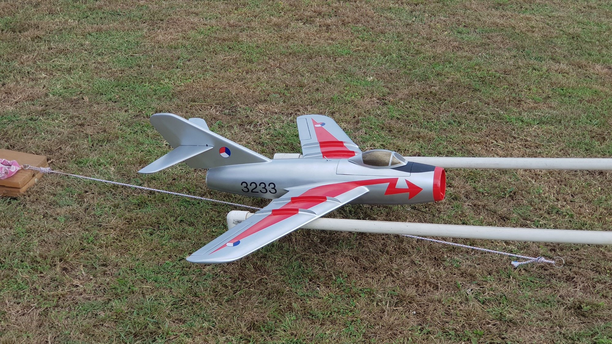

In 2014 started build, discontinued and recently finished.
Superb flying characteristics, smooth and quiet.
Edf freewing 64 mm edf with outrunner
esc 45 amp
lipo 3s 2200

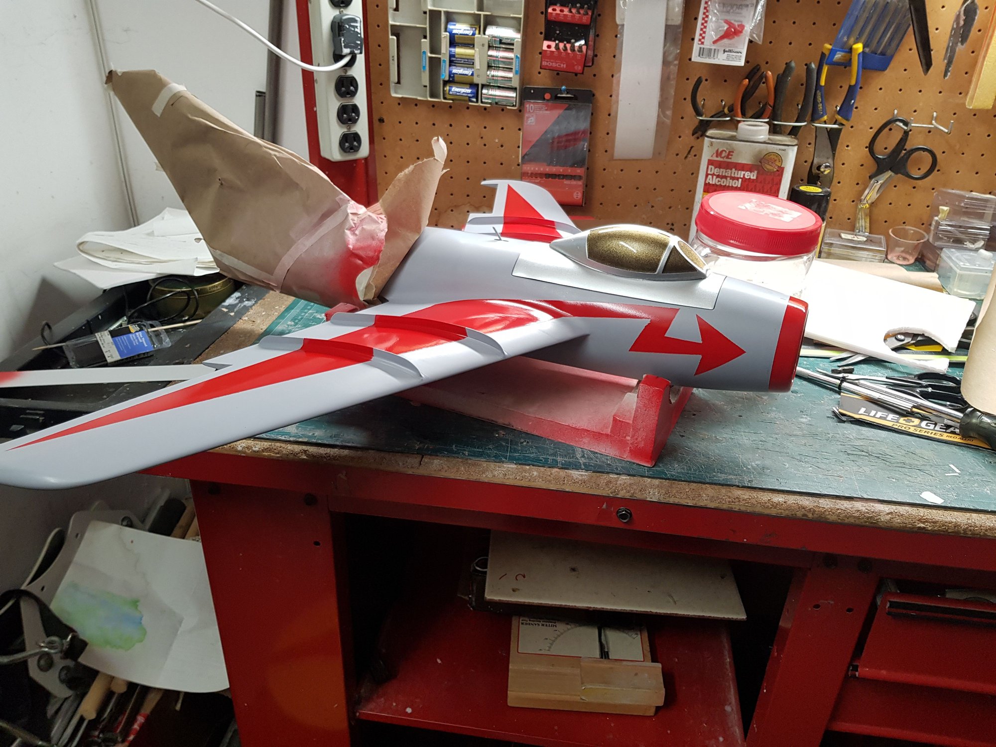

Ready for painting

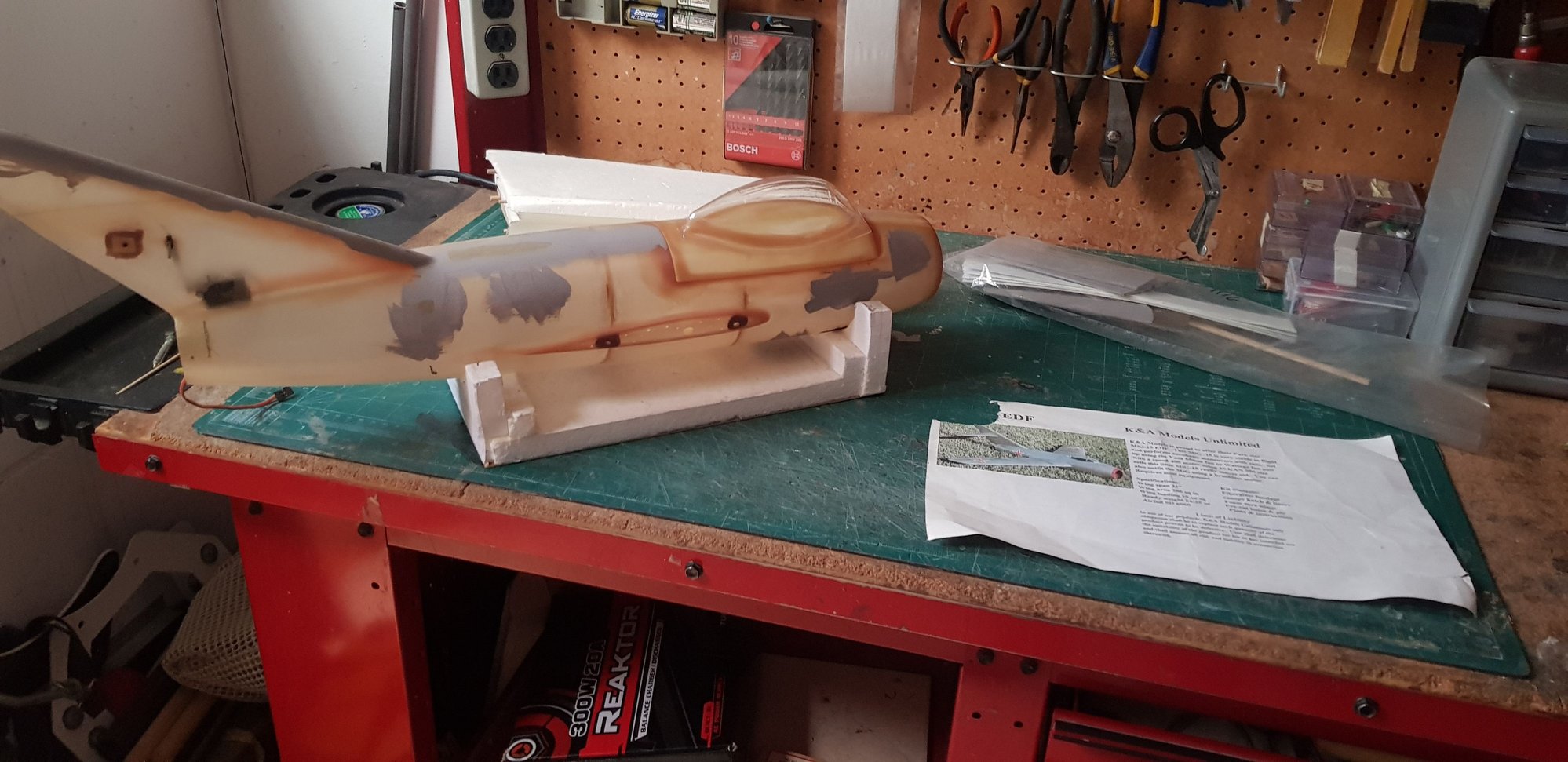

Equipment to go insid3

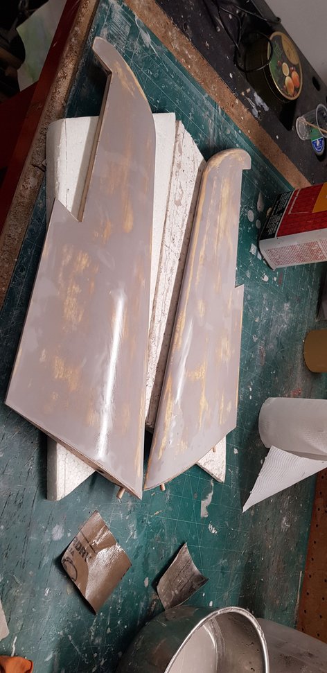

Fillet in wings
Glassed ruder

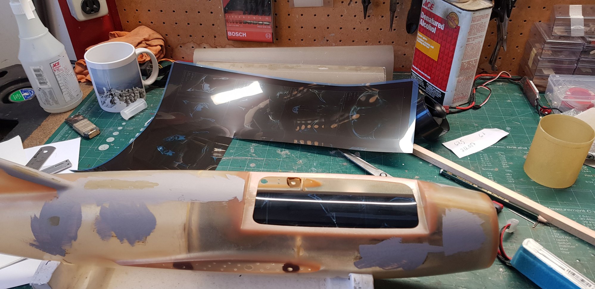

Primer sanded of
Xray as front duct
How wings glued with epoxy and microballons
