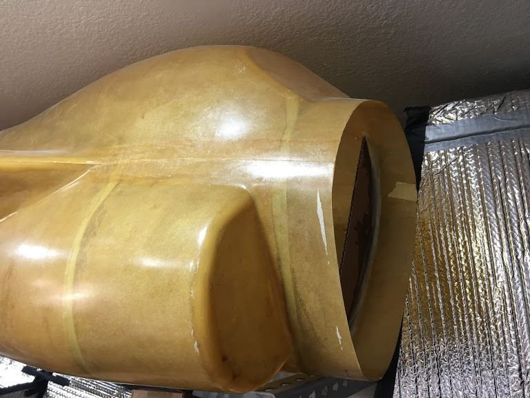

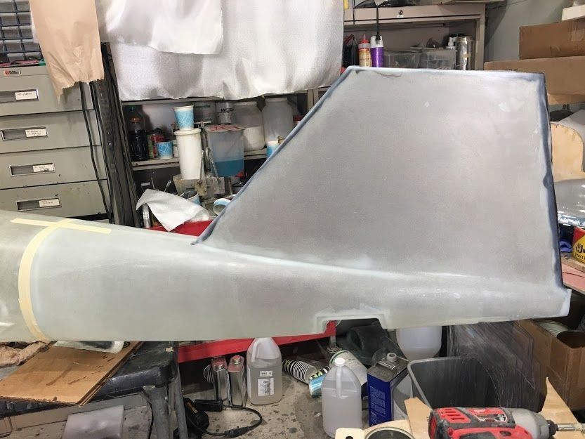

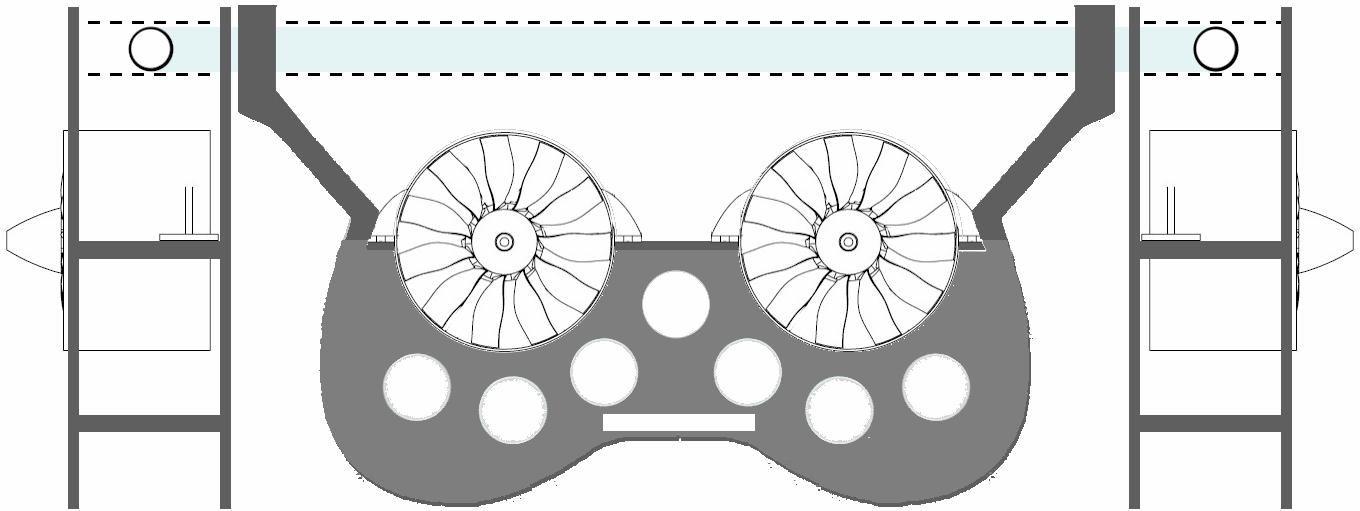

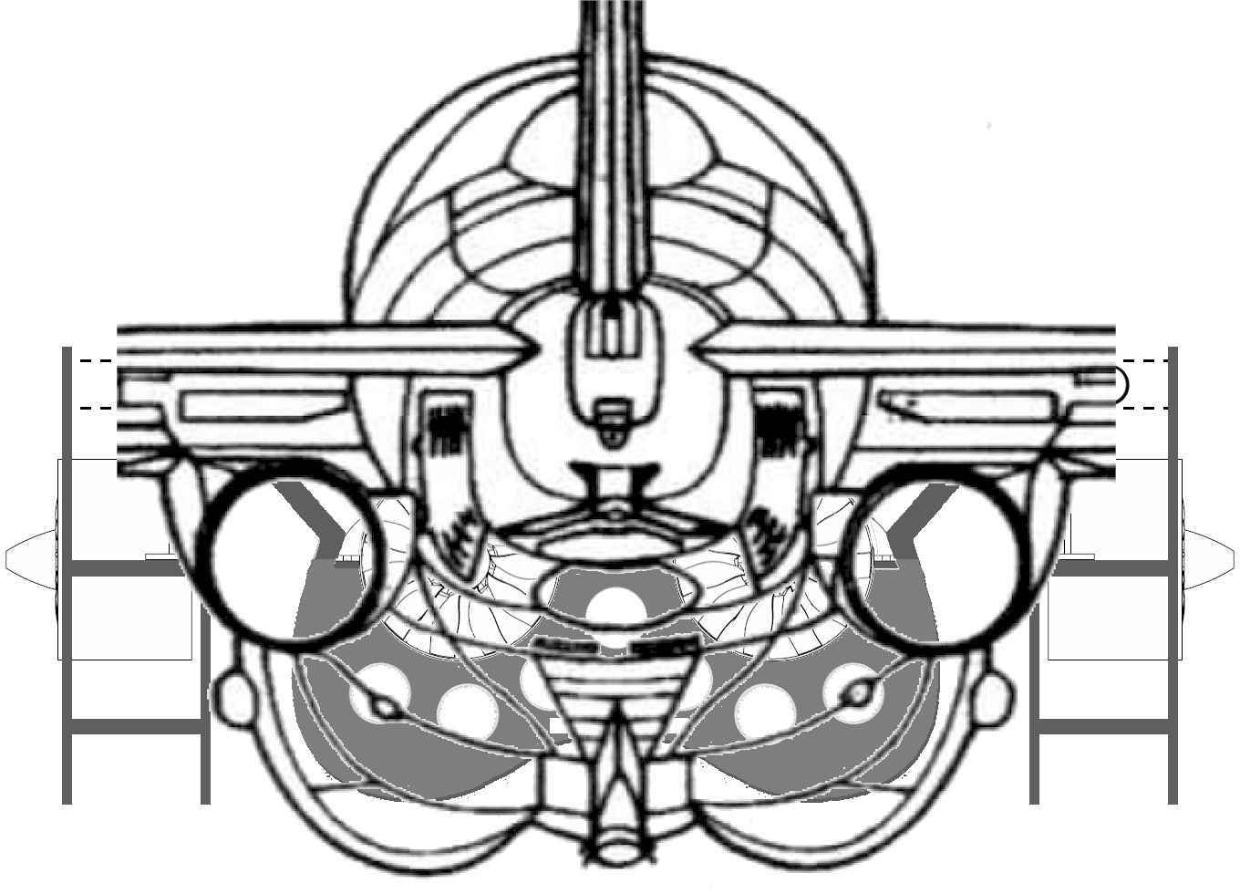

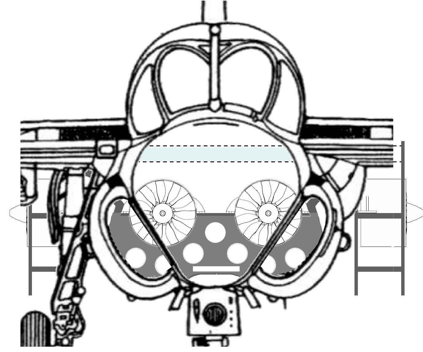

Any recommendation for placement of our pair of JetFan 110 Pro?
Old 02-19-2021, 12:40 PM
mongo
My Feedback: (15)
mongo's Avatar
Join Date: Dec 2001
Location: Midland, TX
Posts: 3,165
Received 51 Likes on 43 Posts
i tend to lean towards the rearmost end of your location bar.
get all the disruption to the airflow at once, and be done with that part.
Old 02-19-2021, 01:27 PM
Flite-Metal
Flite-Metal's Avatar
Join Date: Jun 2020
Posts: 337
Received 14 Likes on 13 Posts
The position just ahead of the dog leg is what is proposed. I am waiting Rainer's reply.
Old 02-19-2021, 01:44 PM
Joseph Frost
Join Date: Nov 2010
Location: Coffs Harbour NSW, AUSTRALIA
Posts: 1,261
Received 44 Likes on 42 Posts
It will make a very little difference where you place it, thrust-wise, from the pics above.
The more important thing is to place both power units in appropriate place to achieve the proper CG balance as you'll have to carry some serious battery load.
I would go as far back as the last pic. (R)

That is the game plan. Balancing is not an issue with a 120" fuselage. However there is a lot going on mechanical wise in that area. Wing tube with half former galley on either side , bulkhead, retract rails with half former support, and of course these ducts. JetFan 110mm....each on 12s.
Rainer's test with a inlet ring but no exhaust duct produced 21.4#. AUW is estimated to be 34#. We created a three piece fuse mold for transportability vs. the movie fuselage which was nearly three times heavier than our layup. It was powered with twin ByroJet recip with two baseball bat pipes...and a large screen covered hole in the bottom to enable its flight off the Washington coast cliffs.

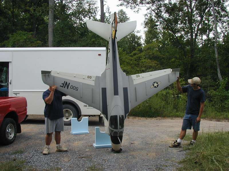

Impressive looking model, couldn't these guys just catapult bungee launch it rather than chuking it off the cliff? Mate, I would expect the AUW lot more than 34#, by the time you'll finish it off, ready for its maiden. Looking forward to its premier flight.
Old 02-20-2021, 08:09 AM
Flite-Metal
Join Date: Jun 2020
Posts: 337
Default 1:5.5 Grumman A6 Intruder
Joseph,
We expect to weight right at 34~35# due to the fact our fuselage is 1/3rd the weight of the movie model. All but two movie 6's had no gear and weighed 22# . Bungee launches failed to reach adequate altitude for filming. Powered soaring permitted filming look-over-down perspective.

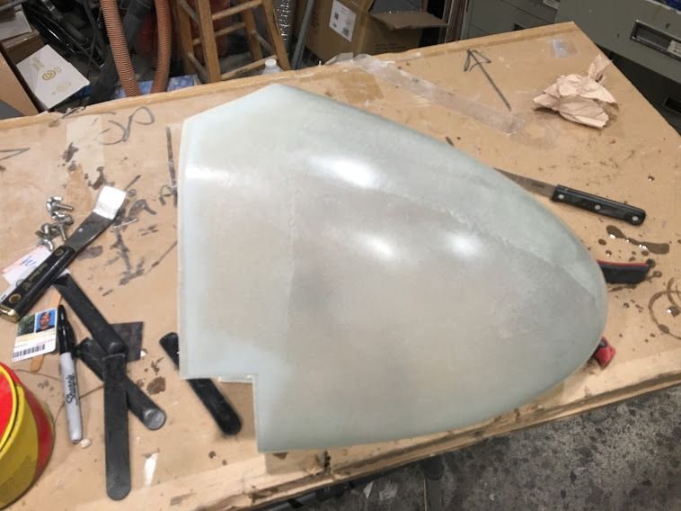

Default Then There Were Gear Doors

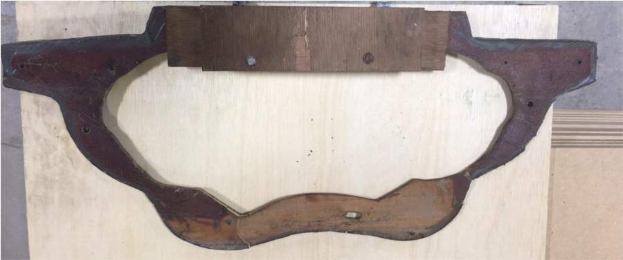

I am pleased to post that there have been no shape changes on the cut out gear doors. Only cut the left side until I install bulkheads to
assure the symmetry. Until I create the vacuum formed door interior to prevent door oscillation I am using 1/4" carbon fiber rectangular
tube for T/C.

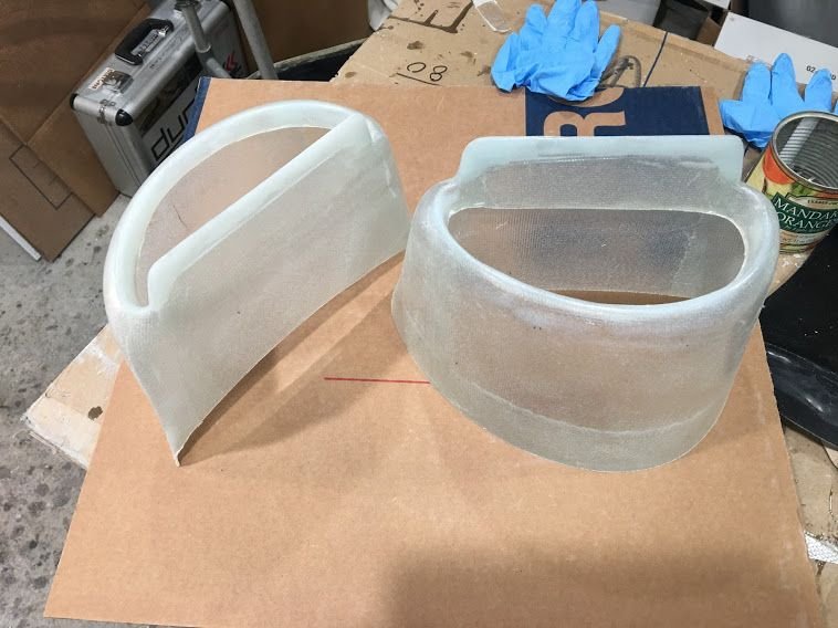

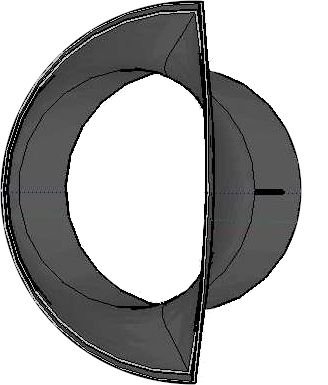

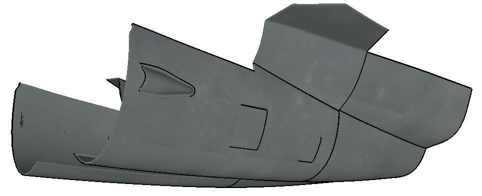

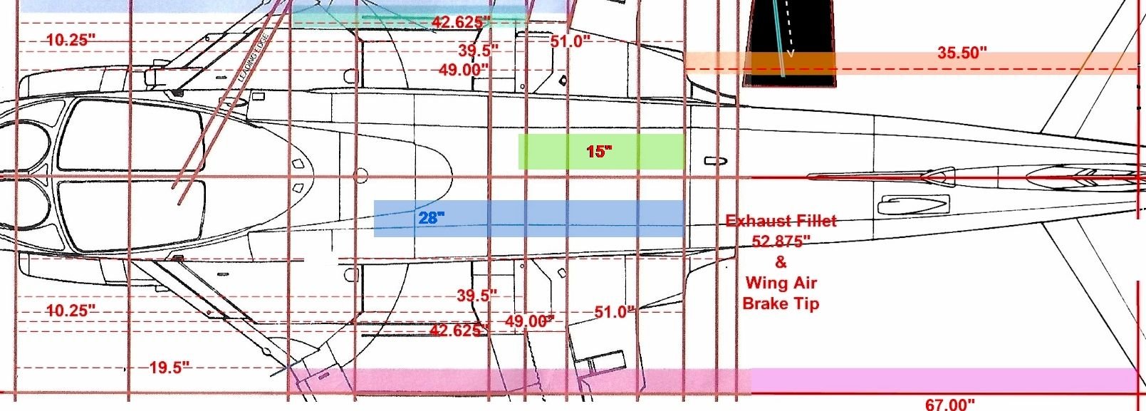

Unlike the original with its piped 90 recip powered ByroJet pushers mounted forward with no inlet ducting this is replaced with an EDF cradle between a pair of half formers with an overhead wing tube galley. Ahead of this is a 105% FSA inlet and printed inlet duct.
Rear bulkhead is 15" forward of exhaust outlet, forward one is 28" forward of the outlet. Inlet was CAD'd
From:
And
To:

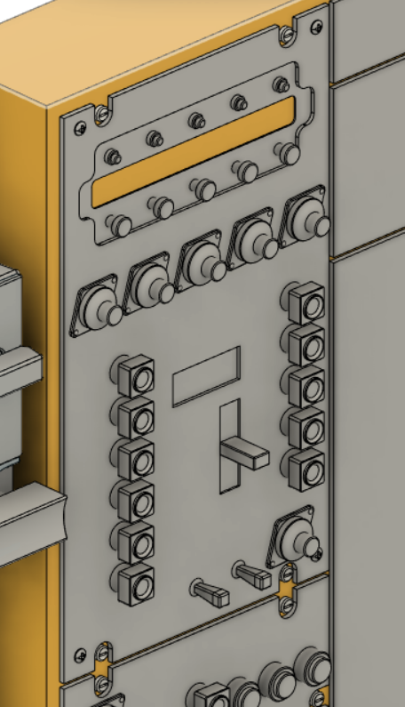

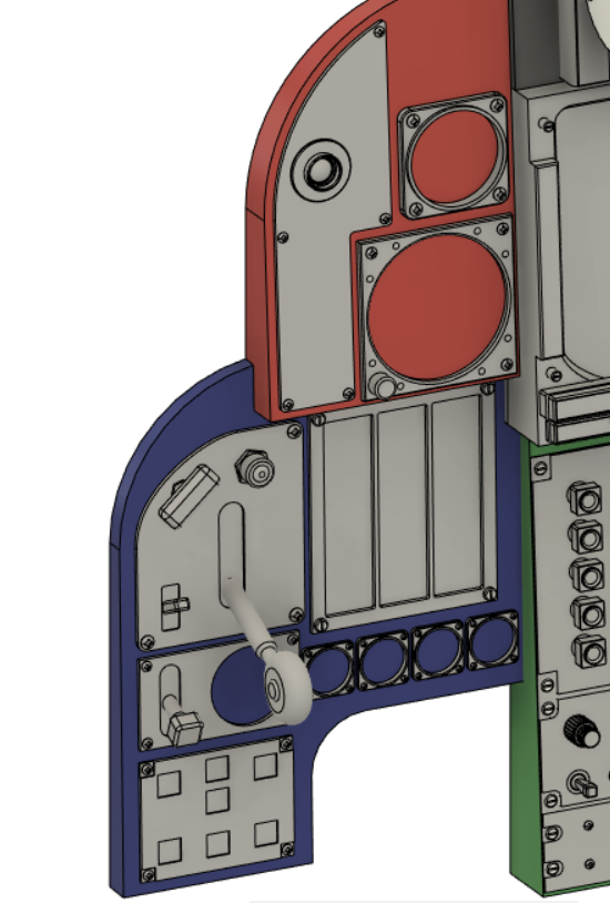

Default A6 Panel Is Filling Out

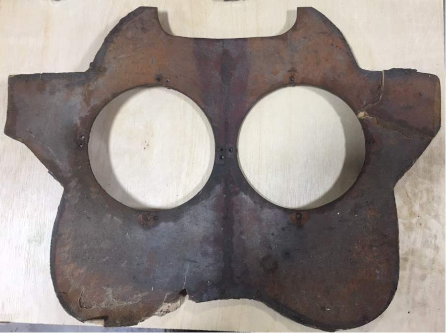

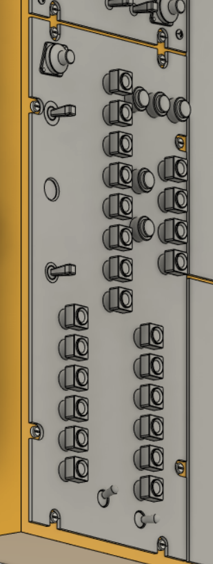

Instrument panel is coming along. There are two base panel designs. One design for the A/E/EA and a second for the K (tanker). The left half of the panel is complete. This week we hope to have it completely finished.
