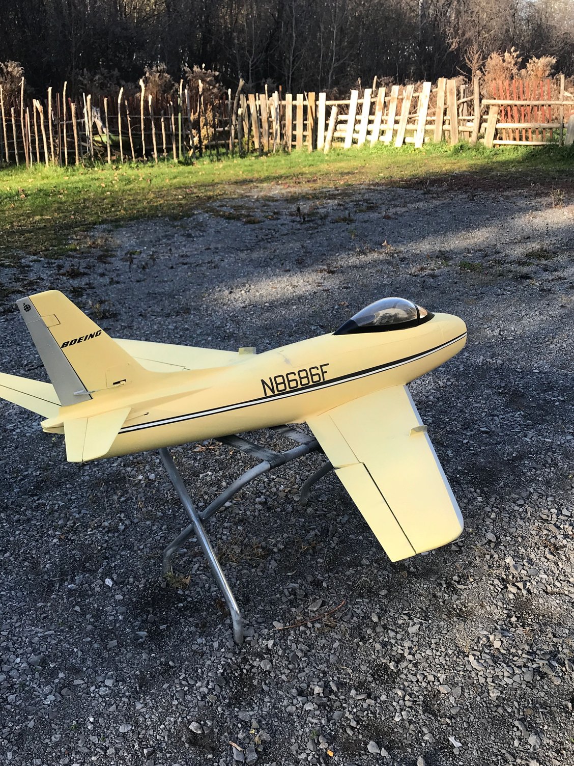

This is a the smaller 63" BVM F86 that I have for sale. If it is at least 60", BVM's retracts will work. There is also a lot larger one that is made by Skymaster. Also look into HSD F16 nose retracts if it is a smaller foamie.
