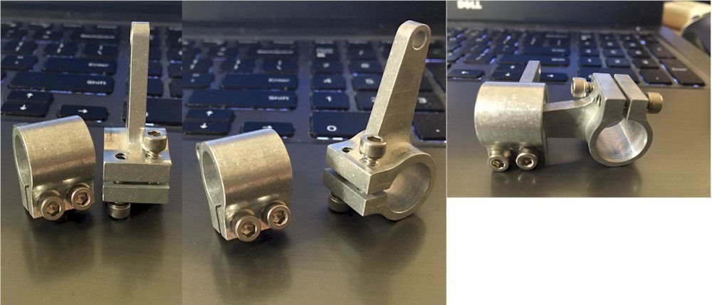

Thanks for the feedback which is actually confirmation of this 23% of MAC setup, I may have posted an image where the axle appeared closer to 25%.
A tapped hardwood plug is inside CF tube to prevent wollowing out the hole via thread abrasion (per recommendation from another thread).There are all metal roller rod and ball rod ends on servo to CF tube connections. I am using a short (3"~5") fiber glass arrow shaft between servo and CF tube connection to assure there won't be flex. I was at a loss for a 1/2 inch dia aluminum control arm since Yellow Aircraft is no longer a source (F-18). Good idea to call Darryl to see if he has them in stock. Surprised to learn robotic parts for it do not exist.
I was trying to not have to add another access hatch directly beneath the CF junction...but it has to be. Stab removal during transport is wise due to width and removal if there was an issue with linkage. Access panel and surround of opening will be glass and CF laminate to assure no flex. The fuse at that location has a vacuum bagged CF, poly foam, and glass sandwich. Each stab is driven with a 25kg servo.
The A6 flying stabs are removable for ease of transport. .50 I.D. aluminum control arm clamps around .50 diameter aluminum tube.
Wood dowel is inserted to prevent tube collapse. A pair of wheel collars are each side of control arm tto snug up against counter
sunk bearings in stab cradle frame to retain inboard end of aluminum tube.
A second tube with an anti-rotation paddle on outboard end is embedded in horizonal stab. Inboard end of stab tube is slipped over
outboard end of stab cradle tube. The slip tolerance tubes are drilled and tapped to receive 4-40 hex head bolt. From the tube specs
below I welcome your recommendation for wall thickness and proper slip tolerance of the two aluminum tubes.

Hey Ed,
In post #8, I have some questions or clarifications:
1.) What is the purpose of the 4-40 Hex Head screw? Is that taking (or transferring) all of the torque loads out from the stabilator, and dumping it to the control arm? If so, #4 is a pretty small screw. Loadwise it will likely be okay. But I think it will wear the tube after some flying cycles - I think you'll wallow out the holes... #6s might help because the load will be spread over a larger surface area on the screw. I'm also assuming if this screw is removed, that is what allows you to remove the H stab (and CF tube?) I guess also adding another screw will halve the load, and probably the wear too.
2.) Are you still using a CF tube? It looks like perhaps the tube is sliding over the aluminum and wood setup that is attached to the control arm. If so, I suspect the CF tube will get the short end of the hole wallowing from the 4-40 screw... I'm guessing the black outline you show is a CF tube. ?
3.) More importantly, is there a way where you can move the outboard-most plywood wall closer to the green fuselage side? The farther apart you can space those plywood / bearing assemblies from each other, the easier your structure will be able to take the bending load from your H tail.
4.) Are your H Stabilators going to pivot/operate as tailerons (meaning, you are also using them for roll)? Or will they only move in unison, like one big H stabilator? If they move together, you might be better off using a single common inner tube that operates both the LH and RH sides. Plus, this will allow you to get rid of 2 bearings (weight savings). You can still use 2 servos if you want, and 2 control arms. And there are ways to address the issue of servos fighting each other... If the tail operates as a Taileron, then this idea won't help of course. I'm not familiar with how they operated on the full scale.

Regarding post #10, If the tube assembly that resides inside the fuselage is .500 OD, then the outboard tube that will be attached to the H stab will have to be greater OD ...So in your table, it looks like you'll need something in column 3 (.625 OD).
You will probably want to try the 0.625 OD X .058 wall AL 6061 tube. That will give you 2 X (.063-.058) = 0.01" slop inside the tubes. It would be nice if it were a bit tighter, but that is the best option you have. If that is too sloppy, you could wrap the outer portion of the .500 tube with a single wrap of something like, Flite Metal...
I know a guy...
If the outer tube is .058 wall thickness, then for the tube inside the fuselage, I'd want a wall thickness equal or greater than the .058" on the outer tube. I'd go with the .500 OD X .065 wall 6061 tube.
Then your next wear point would be where you notch the tube over your paddle. The notch can get stressed, and also the paddle. Is the paddle plywood? Can it be something harder?
These are things that can be made and played around with, before making your final version.
I'd buy some short pieces of the stuff first and play around with it a bit, to see if you're happy with the stackup.

First of all...thanks Ron for your contributions to this thread! The reason for posting is to benefit from the experience of others in specs we have never worked within. There are no answers without seeking the generious "experience based" knowledge. These drawings are not to scale nor are the materials and specs a fixed item. They are in constant revision until the half rear fuselage lay-up is done. Half fuselage enables assurance rear formers and fittings are proper to enable embedding during lay-up.
The final tubing spec is: .500 x .058 wall aluminum outside tube, 3/8 aluminum inside tube resulting in .0040 slip tolerance. This subject to sourcing. Tubing vendor will send short lengths to permit check of slip fit.
Now that the final tubing spec is known bearings can be sourced. The bearing OD and width will effect the revised drawing. That area of the drawing is a WIP. Bearing/tubing support is made from multiple hardwood ply layers. The actual number of layers will be determined by bearing cross section and available interior fuselage width. Final drawing rev. is 50% complete. From this comes .svg perimeter line drawings for laser cut ply. My editor permits conversion of analog drawings to .svg and other formats for cutting and printing.
6-32 heat treat hex head is the better choice. 6-32 will resist cross threading as well. All areas to be clamped and drilled for threading are hardwood plugged. Stab paddle is planned to be a pair of G-10 with a single layer of C/F veil laminated between...though that too is open to suggestion. We are trying to stay away from cutting solid C/F within our facility for sake of not having to deal with shards.

I had someone who assumed the inner telescoptic tube ended just inboard of the 6-32 hex head bolt connecting the inside to the .0500 outside tube. Below is a revised illustration showing the actual config. Additionally the cradle is a box frame to distribute torque/stress..
They arrived...excellent 1/2 inch control arms. Darryl did an excellent job making these. The fact it is threaded all the way through and the arm is centered permits adjustment/ inspection access 180 degrees out. There's nothing more frustrating with hex set hardware than the adjustment access is usually in the wrong place.
Correction, thread in the above stab control arms is in the arm side. In our production arms the bolt is inserted through clearance hole on the control arm side. The clearance hole tolerance is only 2 1/000's. This permits arm adjustment through bottom hatch.
