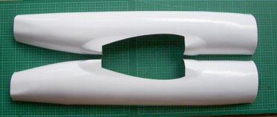

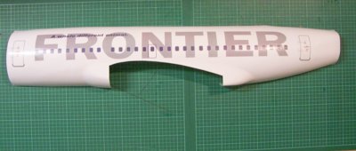

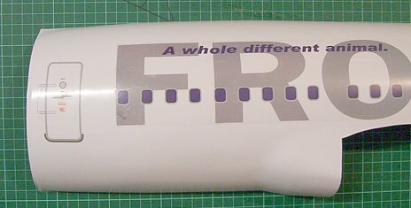

301 fuselage design.
The model under construction is to be completed in Frontier colours.
The fuselage is trimmed to size. The 301 comes with a standard set of window decals and these have been modified to include the Frontier graphics.
Decals can be produced in two ways. Use a graphic modelling website that will produce water slide decals to your specifications, in true colours. The results can be exciting. The second option is to produce your own on your CAD program and print to self-adhesive film. There are a few things to consider. Wing profiles for a model airliner tend to be thicker than scale. Therefore, if the graphics extends to the wing, (as they do with Frontier) then scale adjustment needs to be made. Decals are applied with patience and attention to compound curves. It can be much easier if an airliner scheme is chosen that has a solid colour along the body (which could be painted) and then decals can be applied over top.
Also attached an example of a Bruno Zimmermann built model. In conclusion with care and attention, graphics make the model.
Ian.

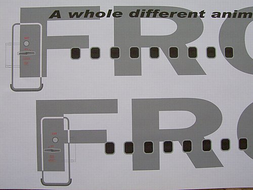

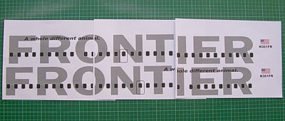

More detail work on the decals today. I have decided to take the name ‘Frontier’ through the fuselage doors as it is supposed to be. Strategically cutting the decals in a few places solves the compound curve issues.
Ian

Ian,
Something in the Frontier decal just caught my attention: The American Flag: Is it supposed to face the same direction for both the Port and Starboard sides? Some airlines in US have the flag face the different direction for the port and starboard sides. How is this for Frontier?
Serdar
Serdar
Join Date: Aug 2004
Location: Queensland, , AUSTRALIA
Posts: 134
RE: EDF Airliner build thread
Serdark
Cheers -yes I do have a copy of window decals in black. If you need a new set let me know. You are the second person to make the comment, so I will include the black set in the kits. I orginally thought grey was better was black was too bold.
Yes, well spotted the US flag is reversed on Frontier planes. Never would have picked it up.
Not sure about the lost rocks bit.
Ian.
Ian.

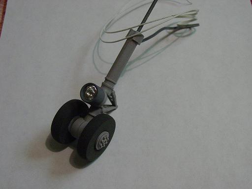

Thank you Ian,
The Southwest B737 I am building will have transparent windows, so I will use the decals for the doors only. One question though: Can you print decals in white? Southwest has white trims around windows and doors, but I do not know of any printer that can print in white.
I have attached a pic of a Southwest 737 for those who has not seen one.
Serdar

The easy (and perhaps only way) I can see of handling the white around the windows and doors is to have a sign/graphics company CNC cut white vinyl for you.
Now this should not be too expensive –the windows one constant shape that only needs machine time to repeat. The rear doors are slightly thinner than the forward.
The window masking templates you use on the inner fuselage surface are then the inner of the CNC cut vinyl. Solves two problems at once.
The door decals provided in the kit are unlikely to show up against such strong fuselage colours and so vinyl white for door outline I suspect will be necessary.
Nice nose gear. Just remember not to permanently fix the leg height such that it can not be easily altered. Nose wheel height adjustment is important on pre-flight final inspection. Wing root incidence angles need to be checked.
Ian.

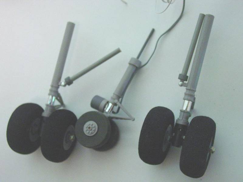

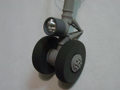

Hello All,
I have completed the rough assembly of the main gears also. Attached are pictures, sorry for the low quality of the photographs. The main gears have the main and the side struts. The side struts are hinged and will be tied to down-lock struts during the final retract assembly.
I have also applied chrome vinyl over the shock absorber pistons, although they are not working shock absorbers.
Cheers,
Serdar
