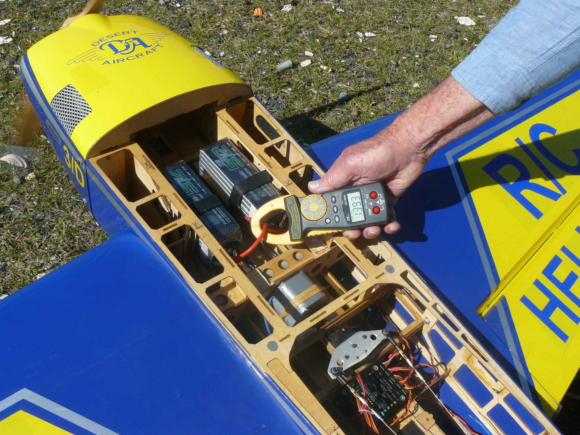

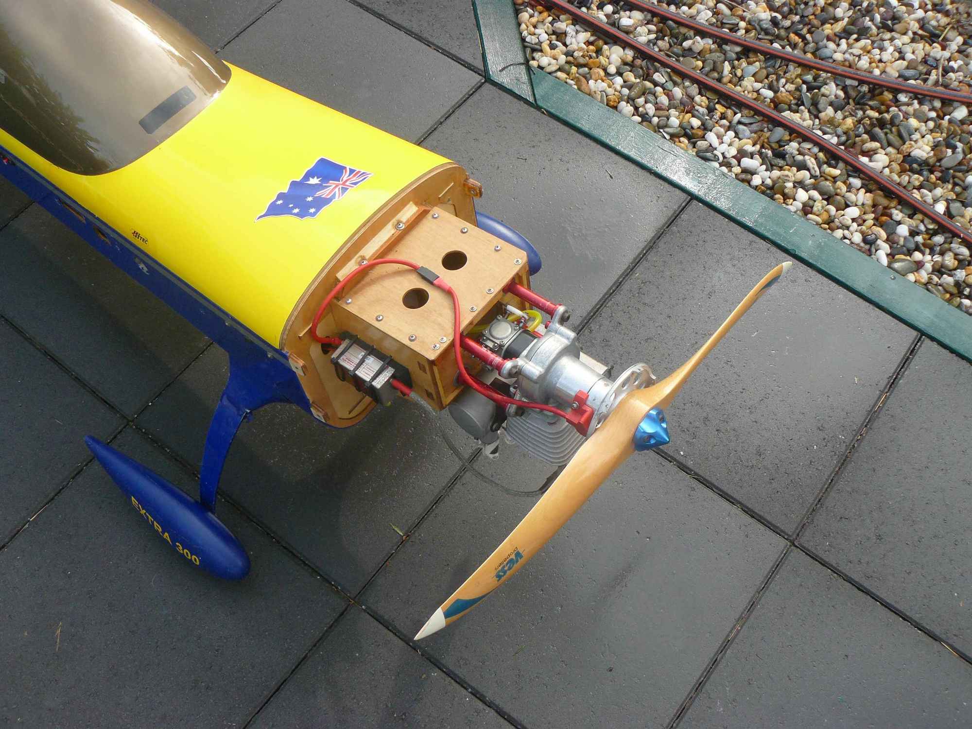

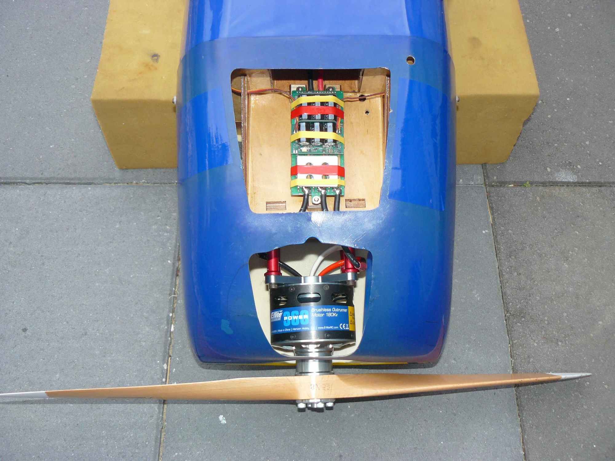

Now days you have a great variety of electric motors to choose from, it's all up to your wallet. I recommend Eflite360, I have converted from DA50 to.
180A speedy, running on 12S spinning 26x10 prop, giving me 16+ kilo pull at peak in "Extra 300", (~9kg/AUW) compare to 11/8.5 with the old IC set up. Just plug it in and off you go, no more hassles with the noisy old nuisance crap.
After a decade of this -
- to this.
Should have done it long time ago!
