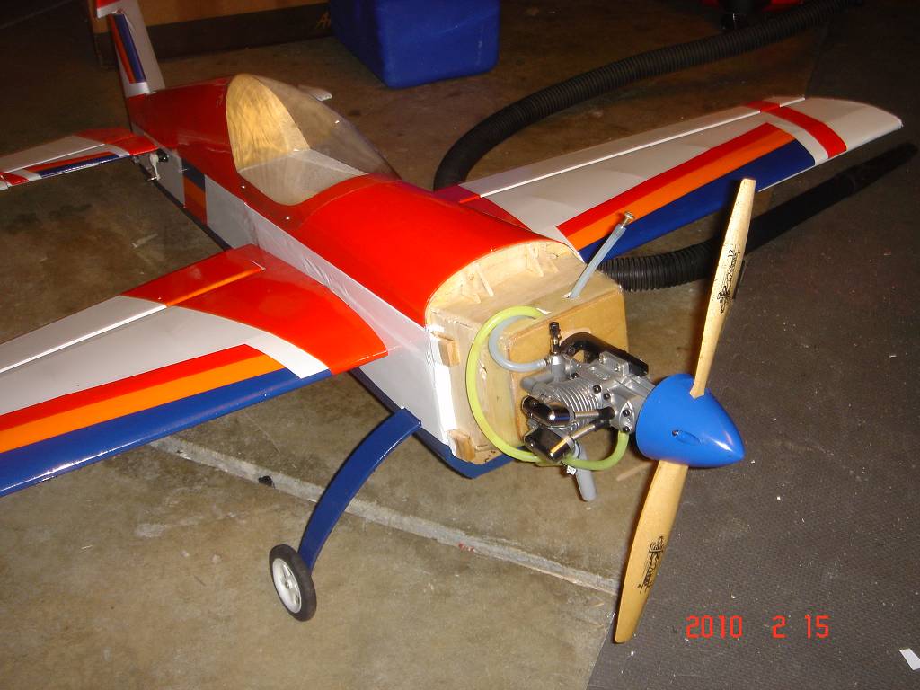

I had it laying around with some nose damage and havent flown it in two years. so looking at the saito 40 13x4 apc 35% nitro and 50 ounces ready to go. has anyone else done this?

yes have been working on it. I checked everything last and it will be at 51-52 ounces. just about 4 ouncs more that the electric is supposed to be.

I have about 6 flights on it now and what a great small gas plane. lands at about 5 mph. it will hover and pull out but not extreme pull pull. hover at about 1/2 -3/4 power. i will get some pics up soon.

one pic of it.

See, who says you need a 40% plane and a DA 150 to have fun? Looks like you've got a real winner there. Congrats!

this thing does very good in 3d and high alfa I still have a bit of wing rock upright but working on it. i will put the cowl on it soon. it is 55.5 ounces with no gas. I have a four ounce tank in it. it will hover and pull out but not the best but that could be in the prop too. it does about 40mph max in fwd flight lol but doesnt need to go fast. i will have our local 3D expert fly it soon and get his thought on it.
I have been looking at other engine options and any of the LA 40-46 type engines will have a bit more power for only an ounce or two more weight. this is with the jett in cowl muffler. I am running 35% in it now. i will mess with props soon. need to find some good light weight props for it.
