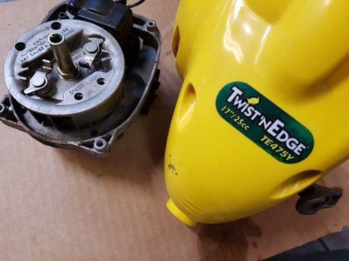

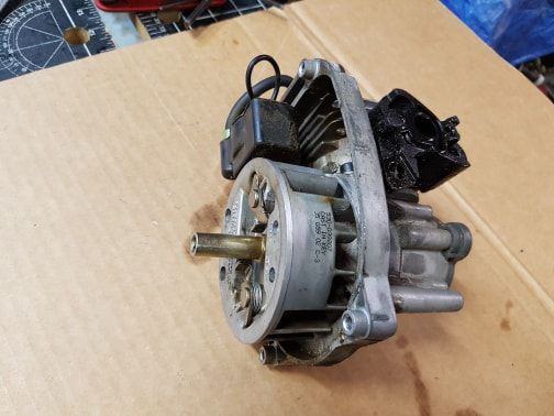

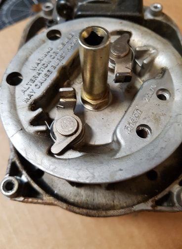

I picked this up for $0 today. With thoughts of making a conversion, but this one may not be a great candidate.
My main concern is this shaft off the flywheel. Its not solid with the crankshaft and is essentially a "nut" for the flywheel. I think the real proper way to make a prop hub is to have a piece machined to replace this, inside threads on one end to hold flywheel on and other end with a threaded shaft to fasten the prop to.
Would you pass on this and find a different donor engine? Or maybe have a better solution.
I have a small lathe and some fabrication skills but am no means a pro.

Made a less then perfect home made hub. 16x8 APC
4 lbs 4 oz as pictured. Total investment, $10 for prop.
It runs....

I have one of those engines on a trimmer yet. I added a bigger carb(11.11 mm venturi ) and it really opened up. That was three years ago and it's still running. A guy on RC Groups converted one but with electronic ignition. There probably a few threads on RCG and here for that engine.https://www.rcgroups.com/forums/show...ane-idea/page2

Good to know, I took it outside and opened it up and she had some nice revs. I think its safe to move forward with it, should come out at a reasonable weight with some trimming and a muffler diet.

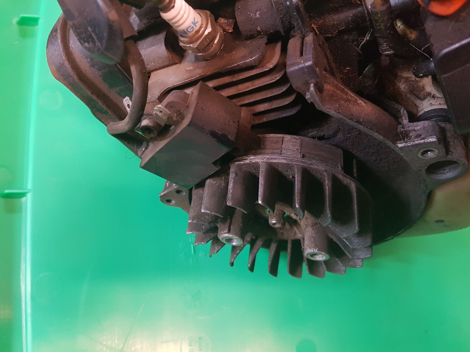

The cdi kits are still available on hk, ordered one today, only $28! Ill need a tapered hub or cut down flywheel.

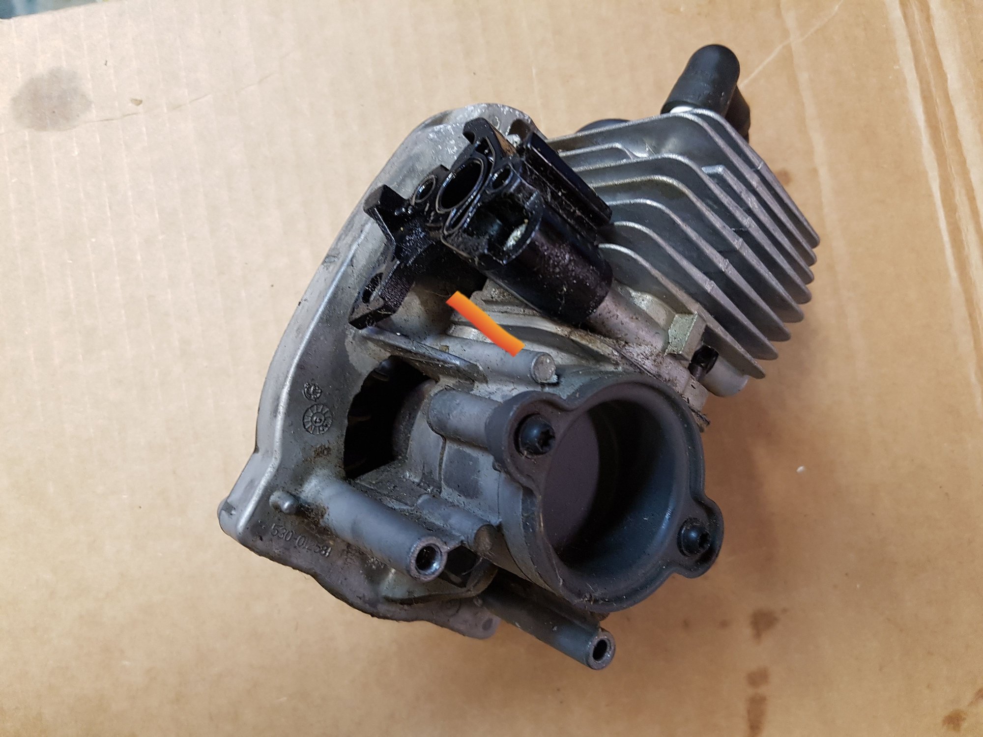

Im thinking of tapping these bosses for mounts, what do you think.

On the pic it looks like it's back farther than the crankcase cover and if it is you could use standoffs to bring it out. McMaster Carr has them or you could make them https://www.mcmaster.com/standard-threaded-standoffs

Yes Ill make my own mounts. Another thing, do you take off the carb return spring? This one has quite a bit of tension and would seem to be a heck of a load on a servo. I can see a return spring being good for safety reasons but at a much lower tension.

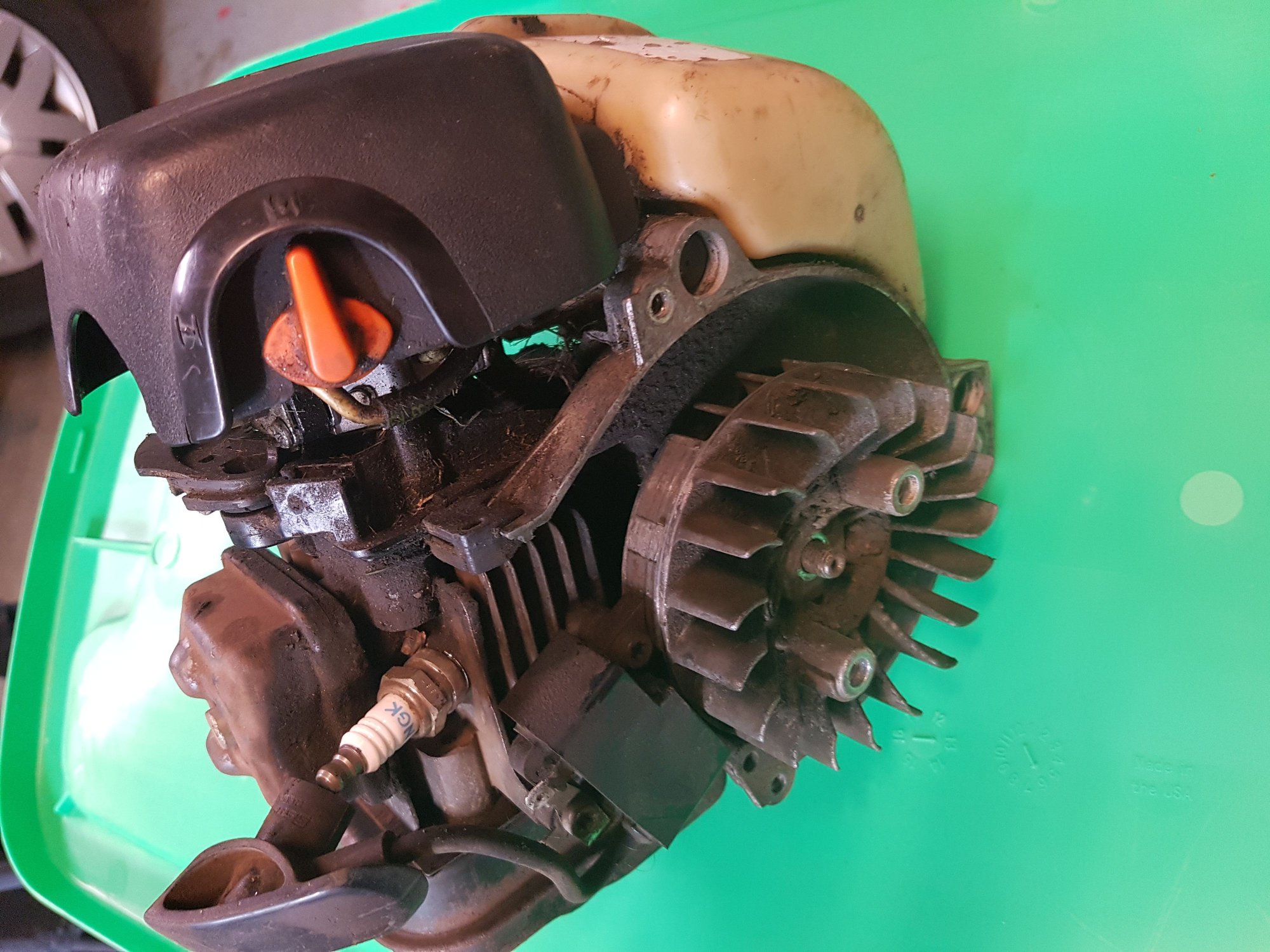

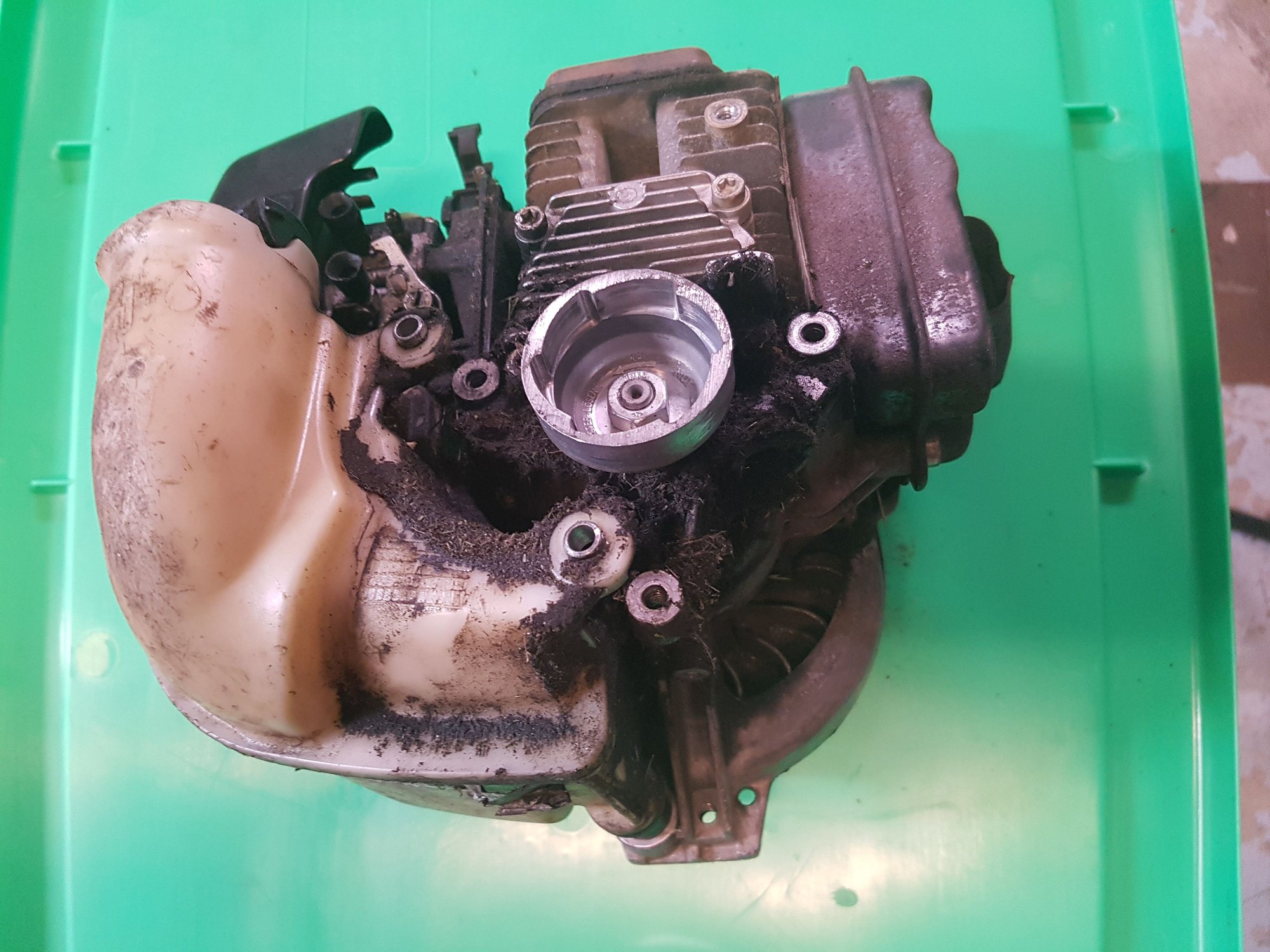

Here is the 28cc 4Mix. I would sure love to have this one converted, it sounds amazing! Im pretty sure my turnigy hubs wont fit on it though... do you know,is the flywheel threaded on?
I also have a cdi ignition on hand if that helps.
Apologies for this thread going in other directions...

The hub does fit, perfect! I just need a key to lock it in. A few small engine shops in town here. Would a coupling nut work for fastening the hub and the prop?

Ive done a bunch of work to this 4-mix. Its coming along good. Notice it has a 2 needle carb! Should be a good runner.
