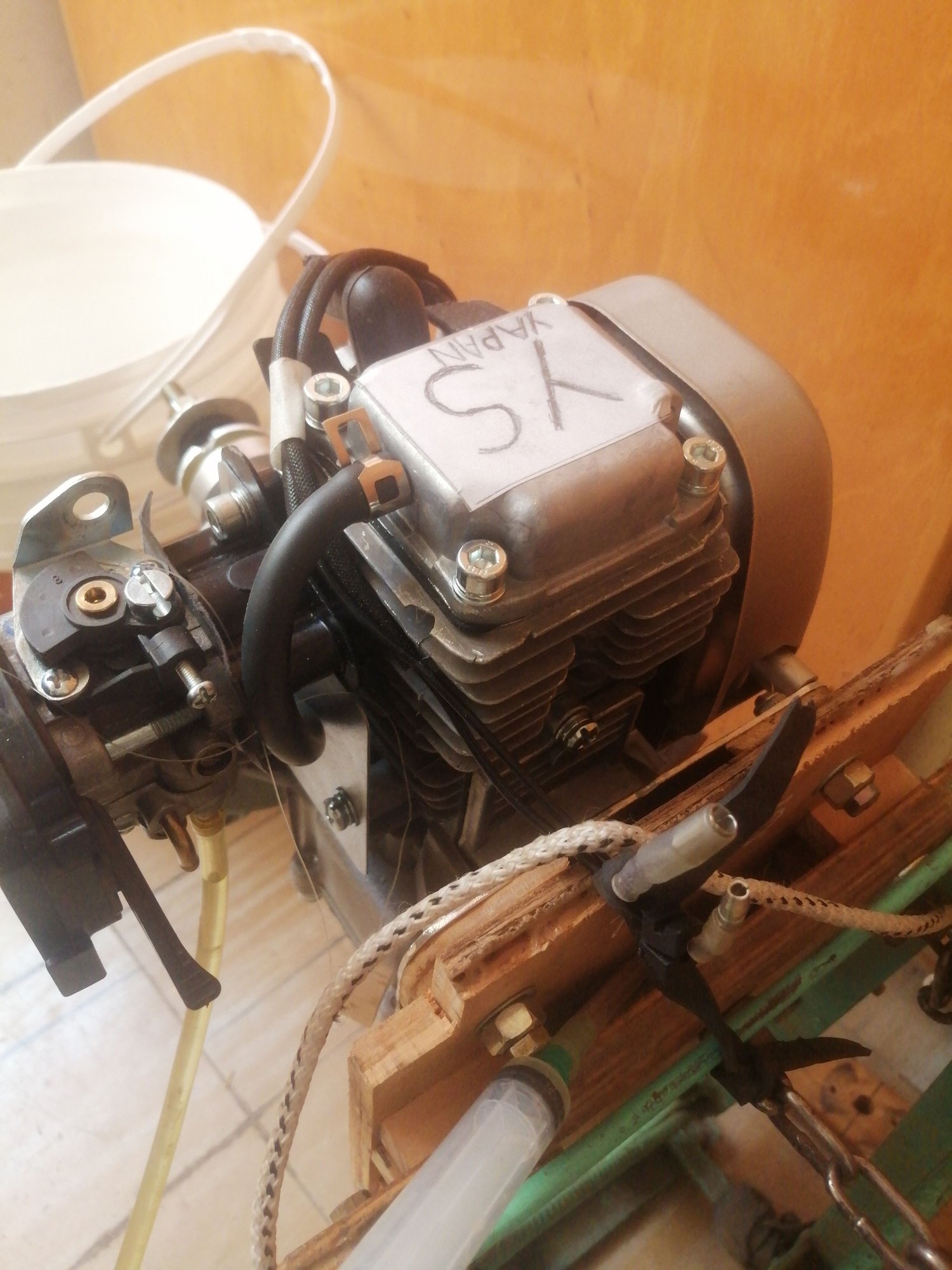

Hello
This is a chinese clon of Robin Subaru, also Makita have this engine, 2900g. Aprox converted, nice.
Have power, with 18x7 handmade propeller, have 3.8kg static thrust, aprox 6200 rpm, need enlarge exhaust, 10mm diameter stock. Thinking make holes in baffle inside, sure.
This engine was marketed by Tower Hobbies like Fuji Imvac engines with prices in excess of 800U$S.
Happy landings
Jose from Argentina

​​​​​​The engine have very good response to throtle, still dont burn 1/4 gallon of gas, third time this afternoon I started and play with it.
