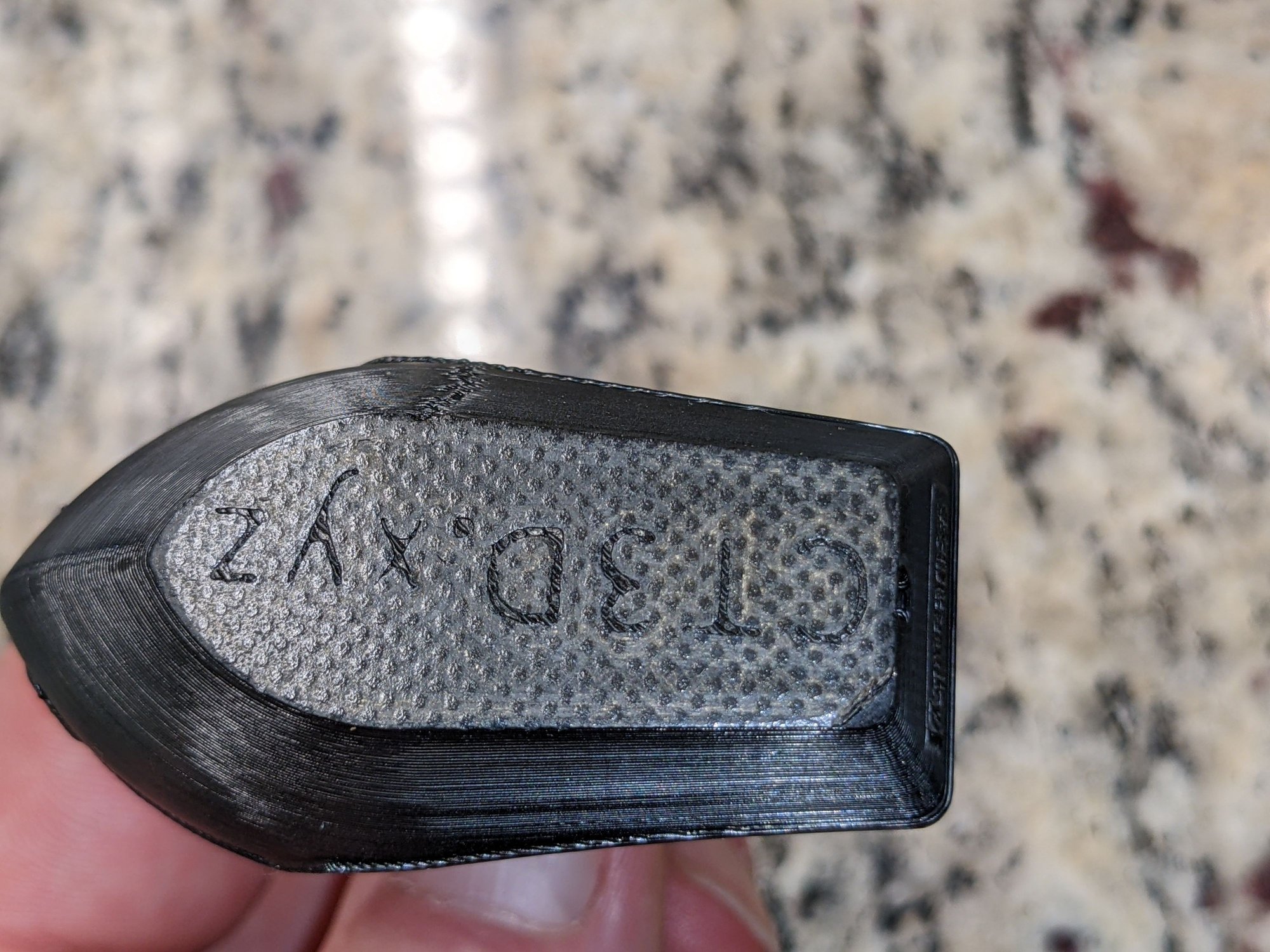

Looks good Dave - Upgraded model from mine..
Was the dual Z an option or did it come stock with that?
I can see you have the Creaity glass bed I think - That "sticky" side works well for PLA (for a while) but when you get to ABS/ASA temps it will Magically stop working (forever). The cure is to flip it over and print on the glass - Using a "sticky goo" as mentioned. Glue stick works great for PLA.. My goto for ABS is a mix of white glue, icing sugar and water. Odd mix but works well - I will find the data for you.

50 % white wood glue (UHU original white wood glue - water solvent)
50 % powder sugar (icing sugar)
Add droplets of water until you have a viscosity similiar to thin salad oil.
here is the mix - I apply with a little sponge - can be reactivated for a few prints which another wipe of the goo - it sticks well - let the print cool fully to help the release.
cleanup is by soaking in water for a minute and then scraping with a razor blade - at high ABS temps (90 deg C) it can turn brown which is normal - Washes off print with water though.

dual z was an upgrade. i think i paid $25 on amazon for it. i need to level the z and mark the couplers so i can tell if the two lead screws get out of sync (which could happen if the printer is off and someone messes with it). the other upgrades i got are a one piece extruder, filament out switch, upgraded bed springs, and cr touch sensor. i have a beaglebone black around here somewhere i may press into service running octoprint too.
thanks for the tech support so far. looking forward to squeexzing molten pla later today.

Originally Posted by Raleighcopter
who wants to go boating?
was that your first print Dave!!!! That’s awesome for this Early in. Wow!

i was a virgin up until today. i did spend time making sure the machine was square and the lead screws ran smoothly. aside from the z seam, i'm extremely happy, and i managed that using cura's generic PLA settings. i may need to lower the bed temp a bit too.

Originally Posted by John_M_
That printed fairly fast... I take it, that is not the highest resolution... but its still came out pretty good.
.2mm layers. Took about 100 minutes
Not too shabby, a little too grainy for lost wax stuff, but great for all around project making.
