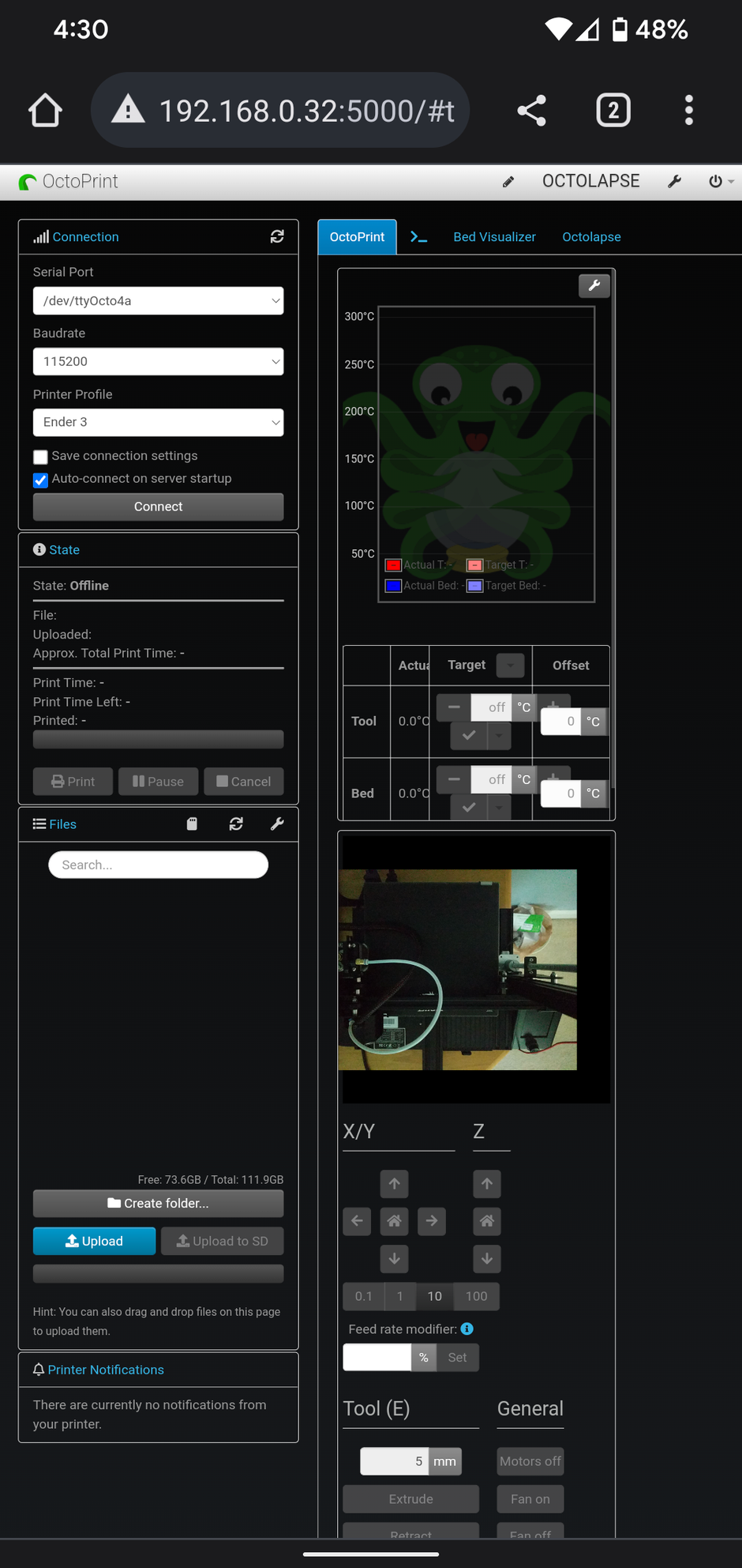

A suggestion to make 3d printing a bit more convenient is to use a program called "octoprint"
Especially when you have a spare usb webcam then you can look how your print is going in on a web page away from your printer.
You can also upload prints remotely and change some settings like temperatures and print speed while printing.
And the dutch part of me enjoys that its free (donations are welcome but not required)
https://octoprint.org/
It can run on windows computers/ laptops and also on single board computers like the raspbery pi series.
And if you are even more lazy like me then when you use prusa slicer then you can print right from the slicer.

Raspberry pis are expensive and hard to come by at the moment. I pressed an old pixel 1 phone into service using the android version. It makes a great server in a tidy package using old recycled hardware.
I've got cura and it also prints direct but the printer will eventually live in my garage or possibly my shop since I plan to print ASA or ABS.
There's so much new to learn with this printer from cad to slicing to hardware setup. There's also a couple upgrades still in the mail that I hope to receive soon, a cr touch and an upgraded extruder. I'm getting there. I hope to finish and print my first hall sensor bracket as soon as the upgrades arrive and get installed. I also plan to print cockpits and pilot figures.

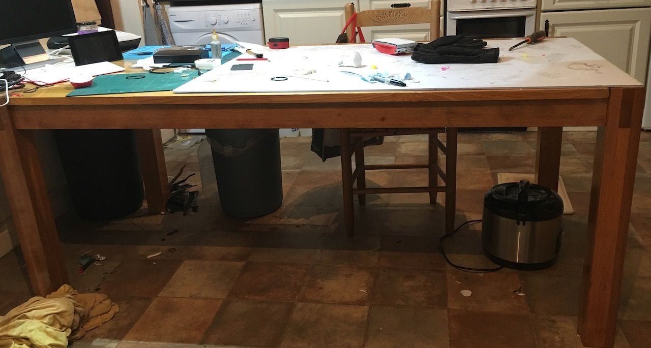

Originally Posted by 1967brutus View Post
That never really goes away, now does it?
Had a discussion with the lady next doors about this.
I seperate my rubbish in paper/cardboard, glass, plastic bottles, tin cans, compost heap and "other"
Bring it to the recycling center and they charge 2 each visit so with fuel cost about 20 a year.
The lady next door has her bins emptied by a company and she pays about 350 a year for that convenince.
Told her that compaired to her i saved 3 (used) model planes a year.
The guys on the other side replaced there old kitchen table it was all worn and scratched and one leg had broken off.
Looked at it and it appeared to be heavy solid wood construction.
Asked if i could have it and they even helped lift it into my house (to heavy to lift alone)
Took it fully apart, borrowed a belt sander and sanded it all down.
Put 3 coats of "G4" polyurethane (sold to make basements and water features waterproof) on it and also screwed m8 inserts in every screw hole as mounting point for "stuff"
So now i have a sollid kitchen table/workbench that is fully water/fuel/petrol/acetone proof and can support at least 200 kg.

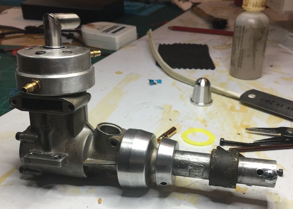

Some parts arived today so continued with the boat engine project.
This engine had water in its case when i got it and likely that water had ben there for years.
Needless to say that the bearings where rusted sollid.
Changed to new today and put most back together. One snapped off head bold still needs to be removed and just found out i did not have the correct size to replace the others.
A trip to the hardware store in town should solve that detail.
Also test fitted a spark plug to see how that looks like and it appears to stick out a bit into the chamber. a second bronze glowplug washer raised it up flush.
Another item on the list is to change the plug cap it came with its own soldering tin and am wondering what is so special about it (lead?)
The plan is to test run it with a glowplug and a prop lik a plane engine but for that it needs to have the correct prop driver on it.
Its using a cone to clamp it on the crankshaft so hope one of the other engines have one to borrow.
Once all that is done then mount the magnet for the ignition and find a way to mount the hall sensor.
loosely put togeather
looks like it sticks out to much without a second washer

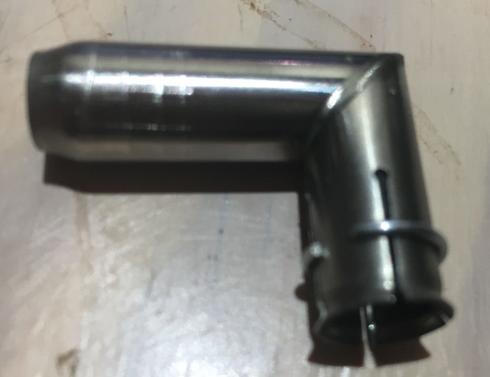

I cannot tell you what it's composition is, but I can tell you, you NEED it for that plugcap, because normal soldering tin won't adhere to the material of cap and braiding.
TIP: either buy a cheap throwaway soldering iron or use your least valuable one, because that tin DOES eat away the tip of your iron pretty fast.
You need quite a bit of heat, I used a 75W iron and was not impressed, if I ever have to do it again I'll try a 100W iron.
Yup... I have at least two engines that need one or even two additional washers. and that one of yours also definitely needs one...
ITIP: either buy a cheap throwaway soldering iron or use your least valuable one, because that tin DOES eat away the tip of your iron pretty fast.

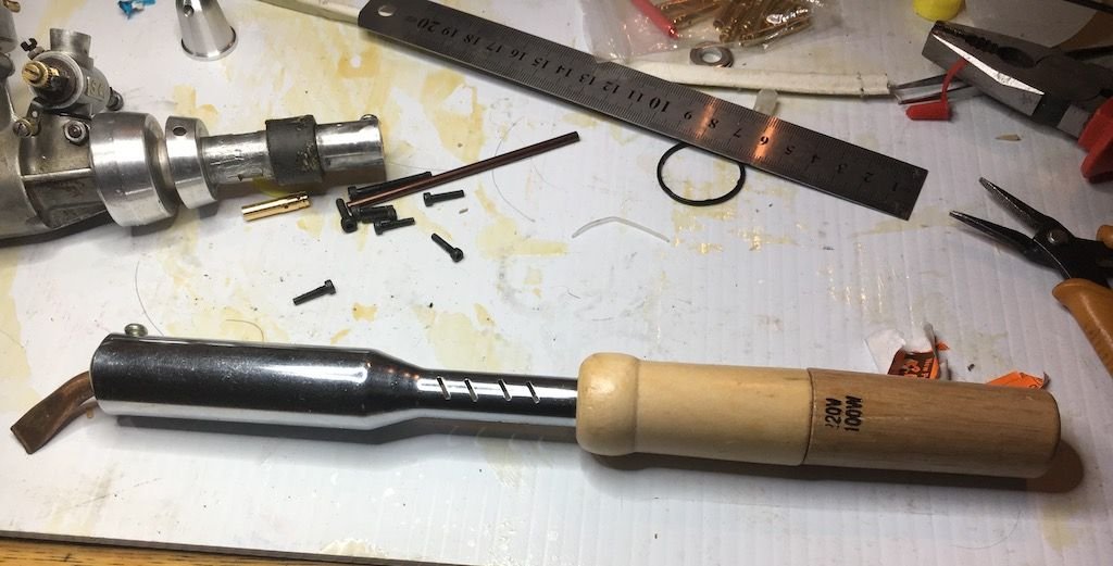

Got this from banggood ages ago and also the 400w (rated) version.
The bigger one did not surfive shipping
Cheap for a reason; a ceramic spacer with wound resisitor wire as heating element.
If you shake hard its might be able to contact the metal tube.
And since that is not grounded it will become live.
We have seperation transformers and variac to adjust the mains voltage at work.
Might be a fun experiment to hook it up and see what it does without electrocuting myself right away.
And yes trew the so called mains lead away it had only a few stands of copper inside and thin insulation.
lethal
Got the impression that the cap is stainless steel.
This https://www.wikihow.com/Solder-Stainless-Steel mentiones that the solder tin needed must contain acid to remove oxidation.
Asuming all that is true then the resulting joint should be washed (with soap?) to remove or neutralize acid or the braid could corrode away over time.
It all reminds me of that s39 flux plummers used with copper water pipes.
Old 08-19-2022, 12:53 PM
  #439
1967brutus
Join Date: Oct 2021
Posts: 554
Received 39 Likes on 38 Posts
The cap actually is some sort of stainless, although I do not have a clue what kind or quality. So is the braiding. Normal resin-core solder won't adhere to it.
When I did my cap replacement, I did NOT see anything that resembled a flux in the solder itself, and I did not see any agressive action, not during nor after. I did not wash the solder afterwards and that did not result in corrosion.
Normally, tin solder always eats away the tip of a non-coated soldering iron, but very slow. Like, after 10 years of use the soldering iron I had looked slightly as if tiny rodents had nibbled on it. Visible, but not really "material missing". The tip was still there, just a bit thinner, and small chomps gone.
